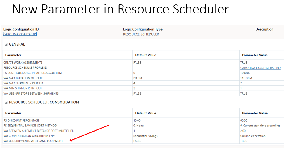

This feature provides you with a new Resource Schedule Logic Configuration Parameter that is designed to force the optimizer to only pair together shipments with the same Equipment Group.
  • This enhancement provides clients with the option that strung shipments will always use the same equipment.
  • This is an option that some clients may like but is not always necessary.
  • Example 1 (not shown) has an inbound with a dry trailer and an outbound with a flatbed.  This may be perfectly fine for some clients.
  • Example 2 does not have any mismatches of equipment.
  • The lumber outbound is now paired with a lumber inbound.
  • Please note that to make this work correctly, the items must have an equipment restriction else they can ship on any equipment.
Resource Scheduler Configuration

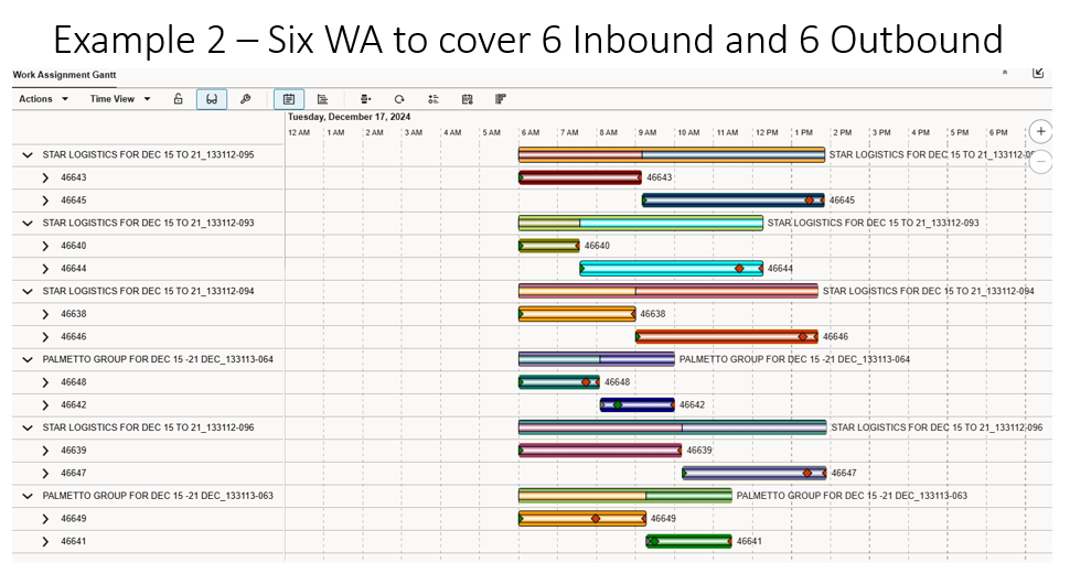

Two test cases were run.  The first did not utilize the parameter and an Inbound Dry Van shipment was paired with an Outbound Flatbed Shipment.   This is not necessarily bad.  It is the client configuration that will make the rule to only string shipments with the same equipment
Gantt Chart of 6 Work Assignments
.  These are the results of the WA plan.
Bulk Plan Results
Work Assignment Bulk Plan Results

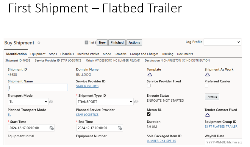

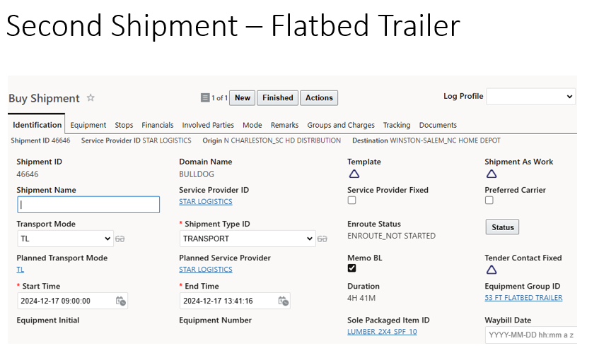

Both shipments were strung together based on the Equipment Group.  The other 10 outbound orders formed 5 outbound shipments in dry vans.  These were paired with 5 inbound shipments that required dry vans.
first
Work Assignment First Shipment
second
Work Assignment Second Shipment

There is a new parameter in the Resource Scheduler as illustrated previously.
