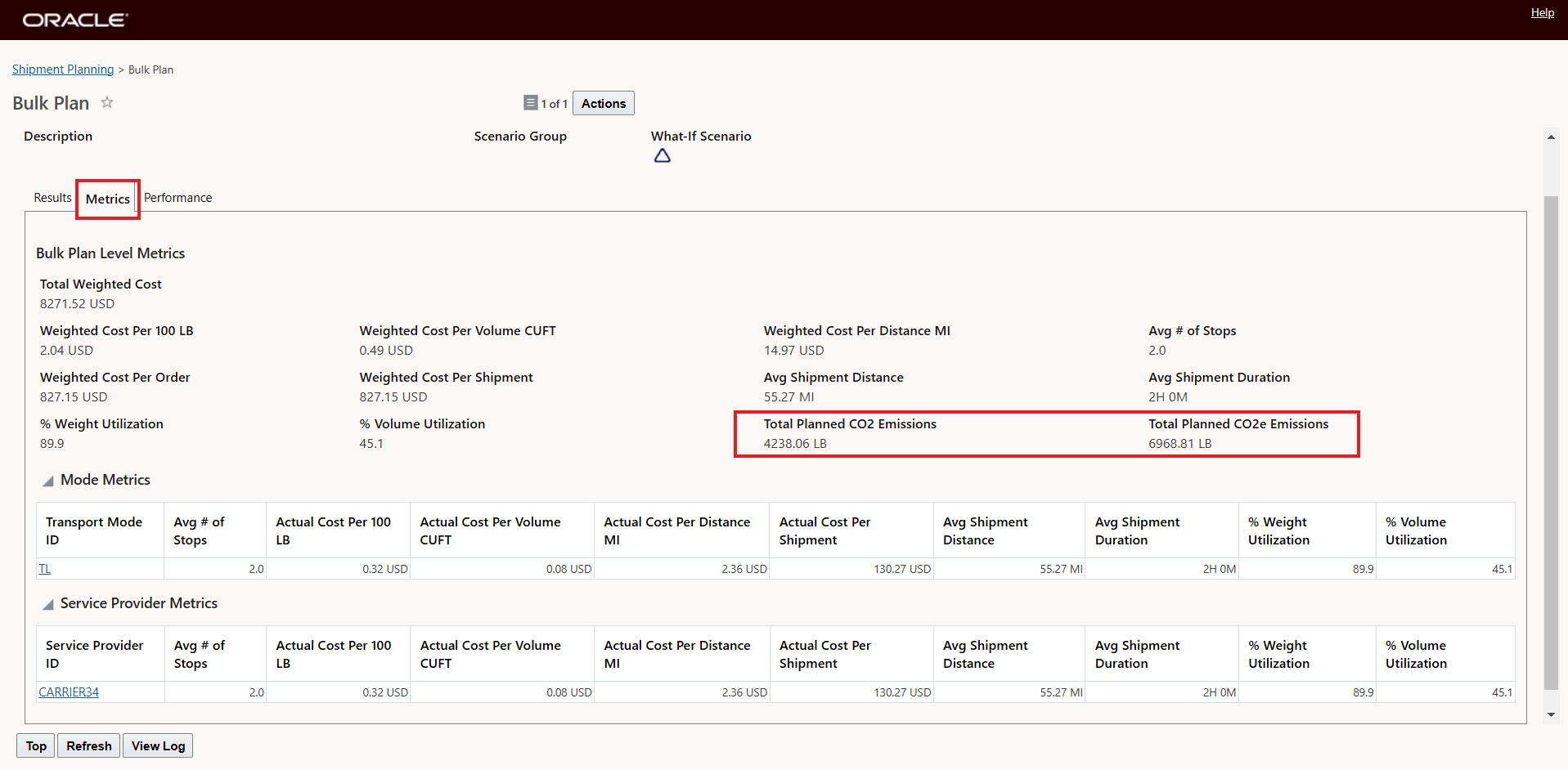

Bulk Plan Metrics Tab - Total Planned CO2 Emissions and Total Planned CO2e Emissions
This feature enhances the functionality of the Bulk Plan Results Metrics tab to include the Total Planned CO2 Emissions and Total Planned CO2e Emissions for the shipments planned within a bulk plan run.
The Bulk Plan Results Metrics tab below shows, for all the shipments planned within this bulk plan, the Total Planned CO2 Emissions and Total Planned CO2e Emissions.
Bulk Plan Metrics Tab - Total Planned CO2 Emissions and Total Planned CO2e Emissions values
This feature extends visibility to and awareness of the planned emissions - CO2 and CO2e calculated within a bulk plan run. This additional information provides insight into the planned emissions impact for the plan along with the planned transportation cost.
