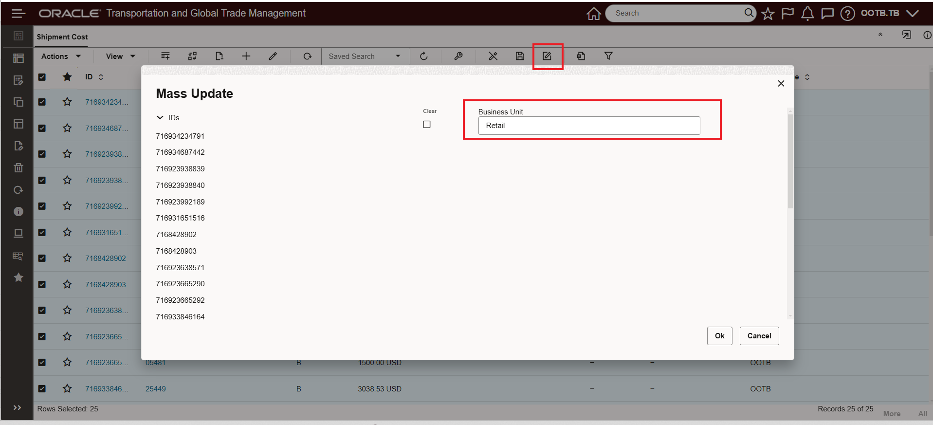

In the example below, the Shipment Cost Screen Set has been configured to support mass updates for the business unit remark qualifier. The selected set of Shipment Cost records will be updated with the configured Business Unit Remark Qualifier value of Retail.
Mass Update Example  - Configured Remark Qualifier Business Unit Updated to Value = Retail

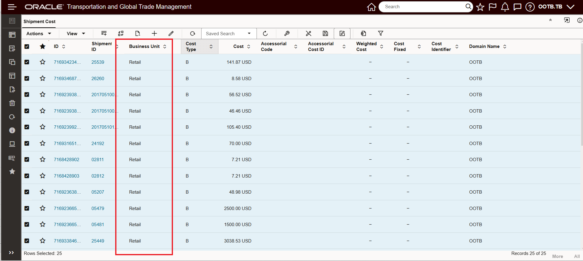

The result of the Mass Update is shown below - all the selected records have the Business Unit column set to “Retail”.
Business Unit Column Set to Retail

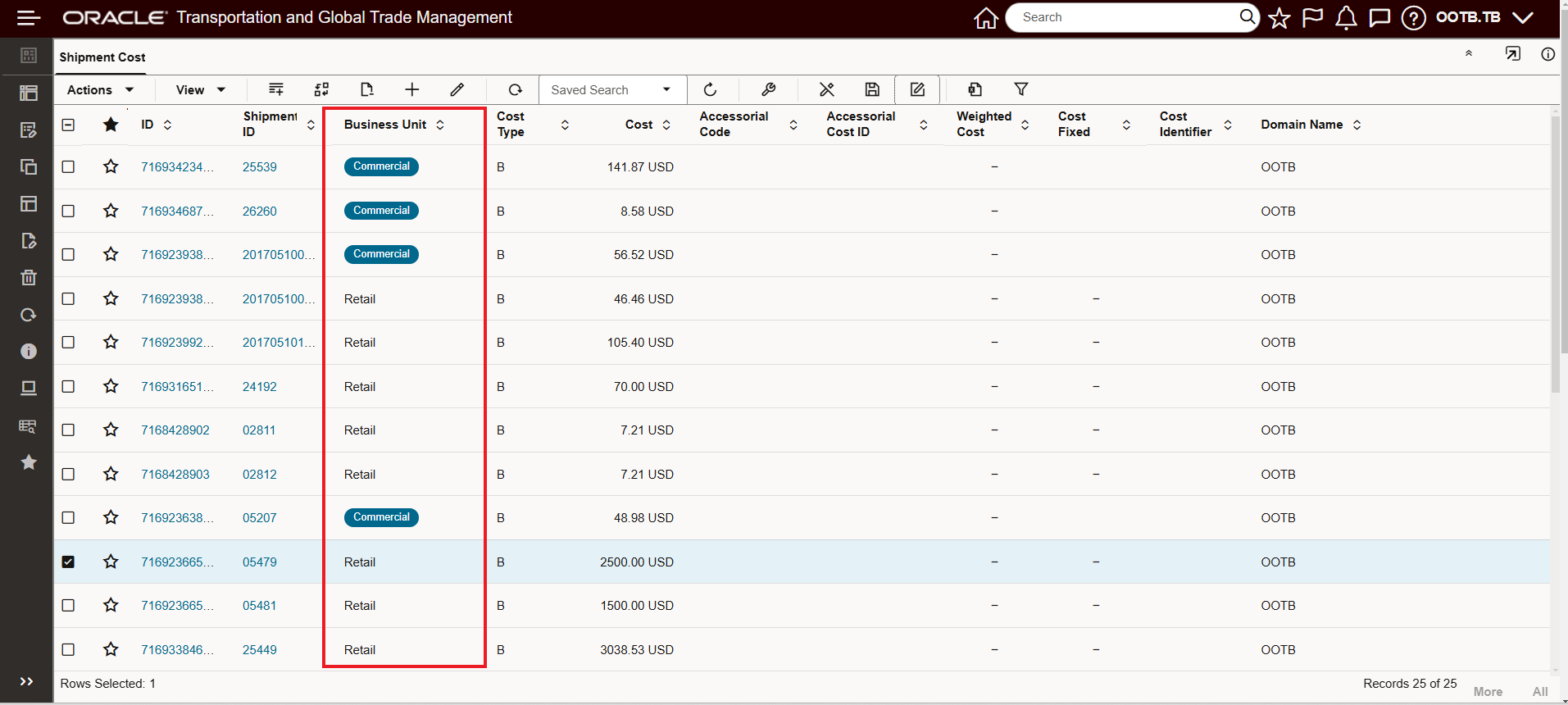

The “Shipment Cost Remark” field also supports inline edit, as shown below.  In this example, four of the business unit records have been updated with the value “Commercial” using inline edit.
Inline Edit Example
Inline Edit Example

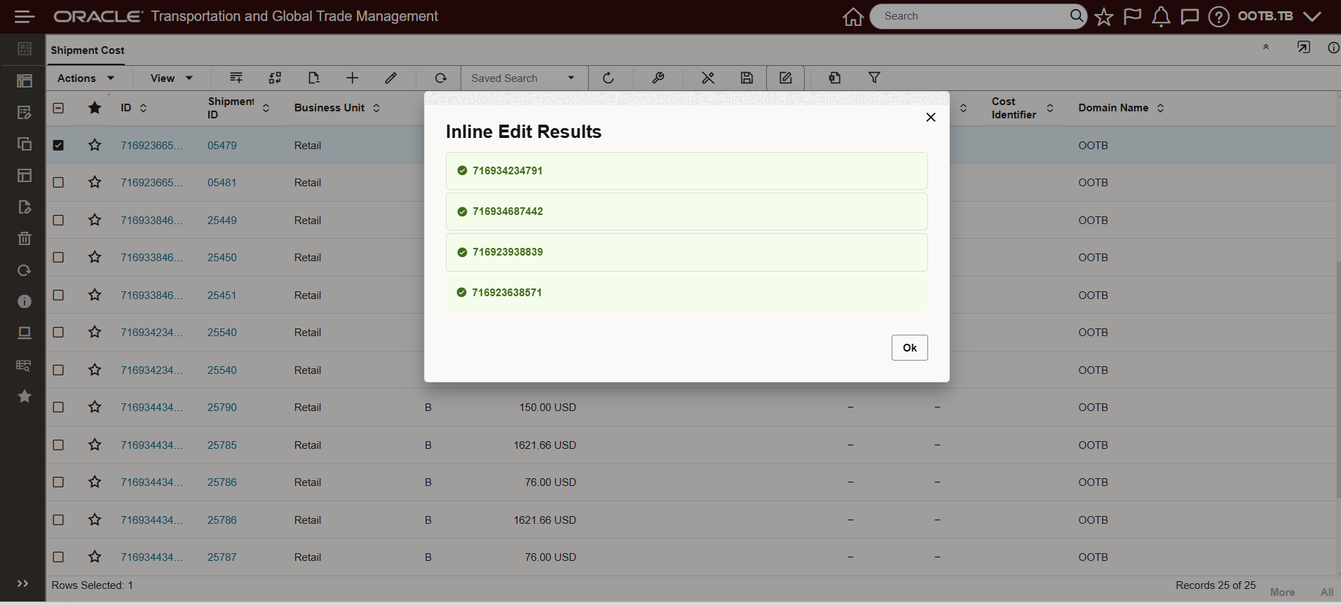

Inline Edit Save
Inline Edit Results

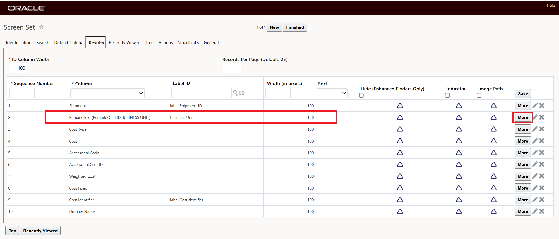

To take advantage of the newly enabled feature, the Shipment Cost Screen Set used in your enhanced workbench should have the “Remark Pseudo” field configured.
In the example below the Shipment Cost Screen Set has the “Remark” field configured for the business unit qualifier.
Screen Set Configuration

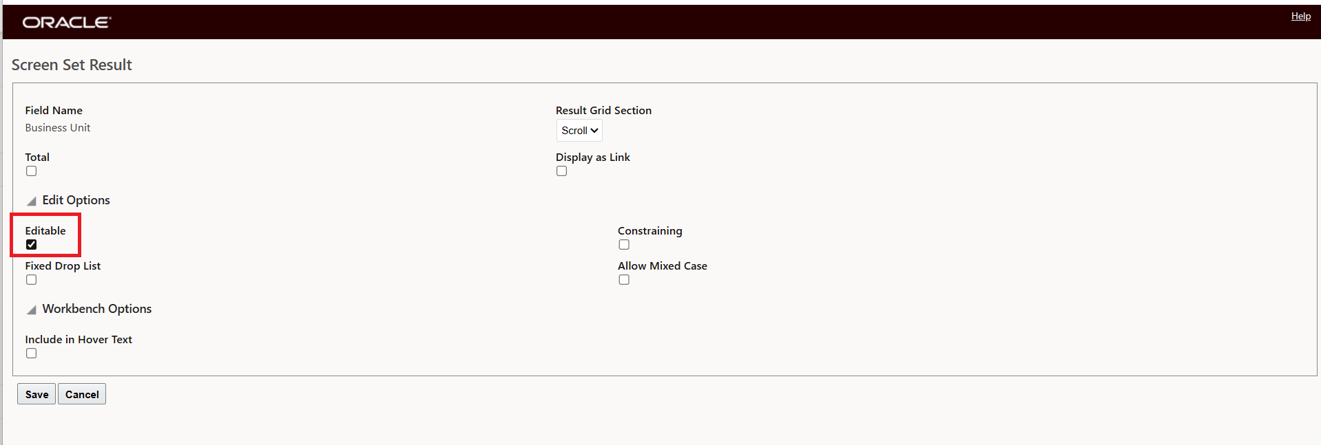

Select More to select the Edit option to enable both the option for mass update and inline edit.
Select Edit
Select Edit
