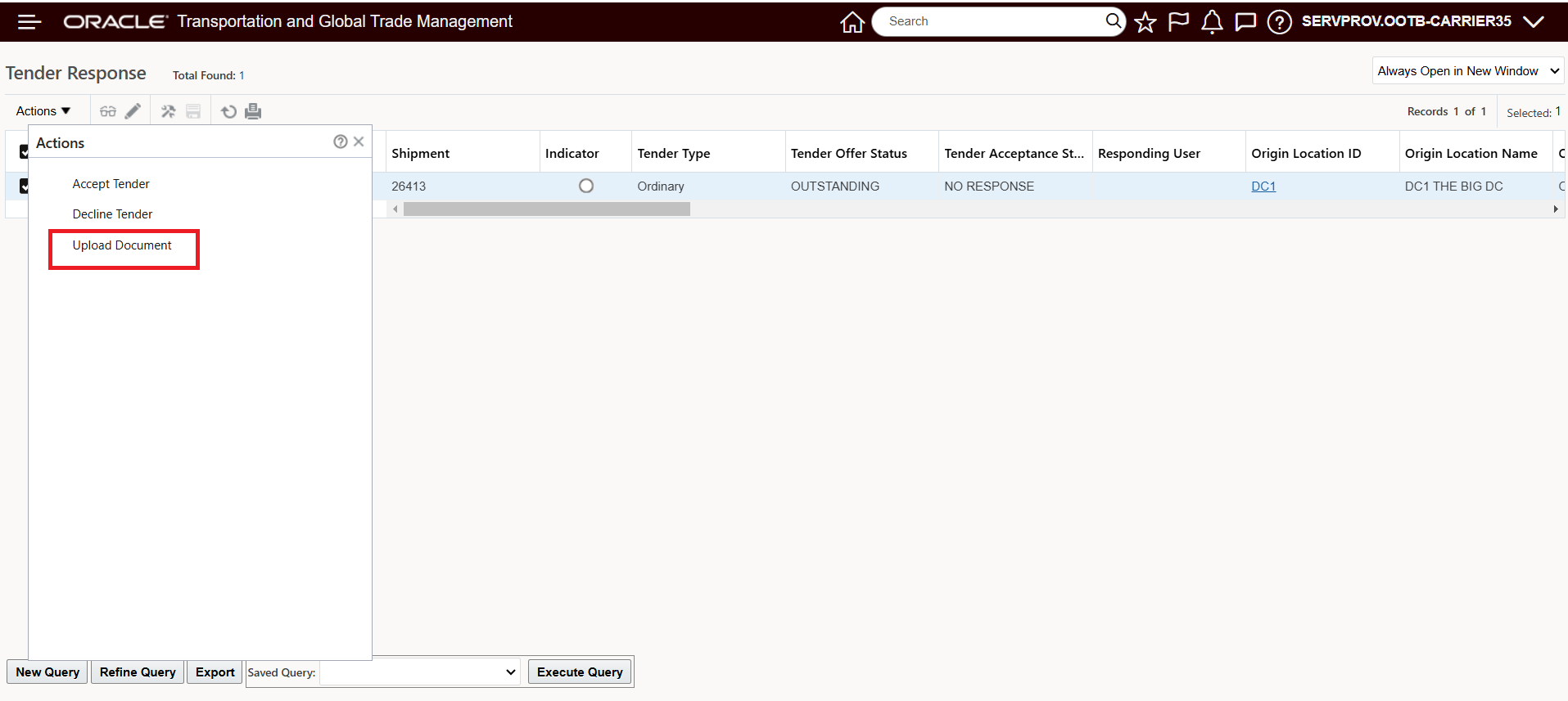

In the example below, the service provider performs the “Upload Document” action in the Online Booking/Tendering screen.
Online Booking/Tendering  - Upload Document

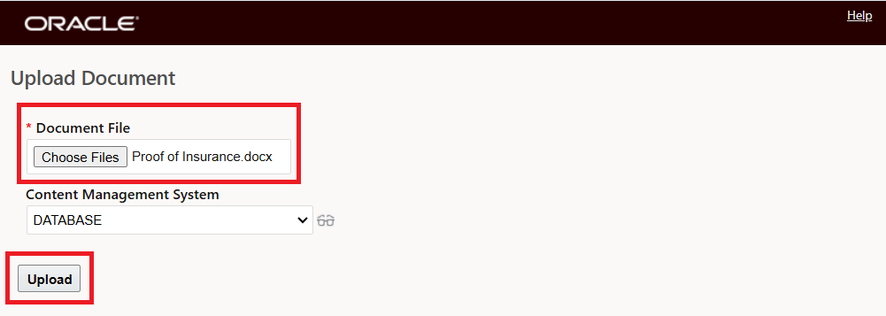

When the action is run, the service provider can select and upload the desired document, as shown below.
Select and Upload Document

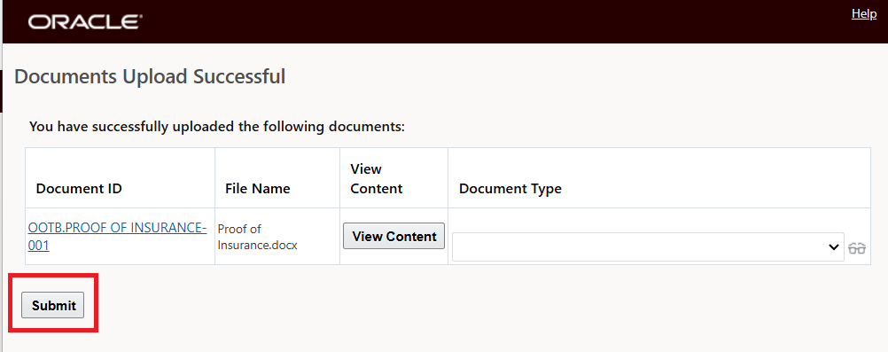

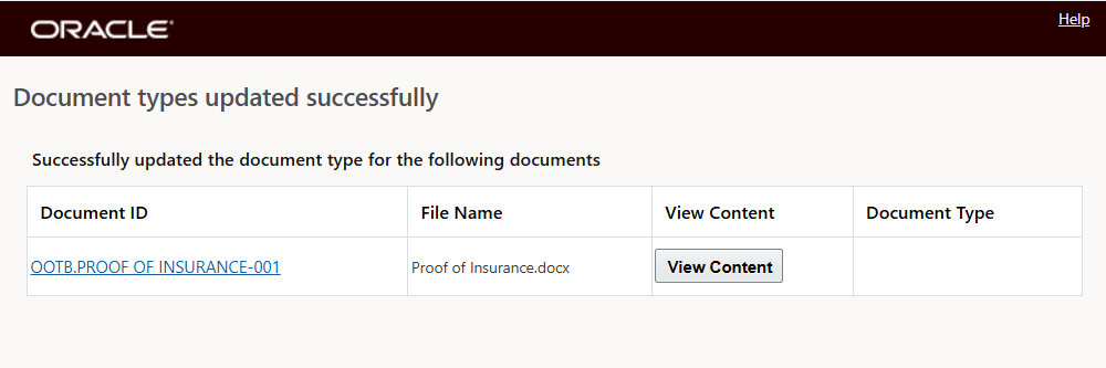

After selecting Upload, the document is uploaded. Then the service provider selects Submit to complete the process as shown below.
Document Uploaded - Submit
Document Upload Complete

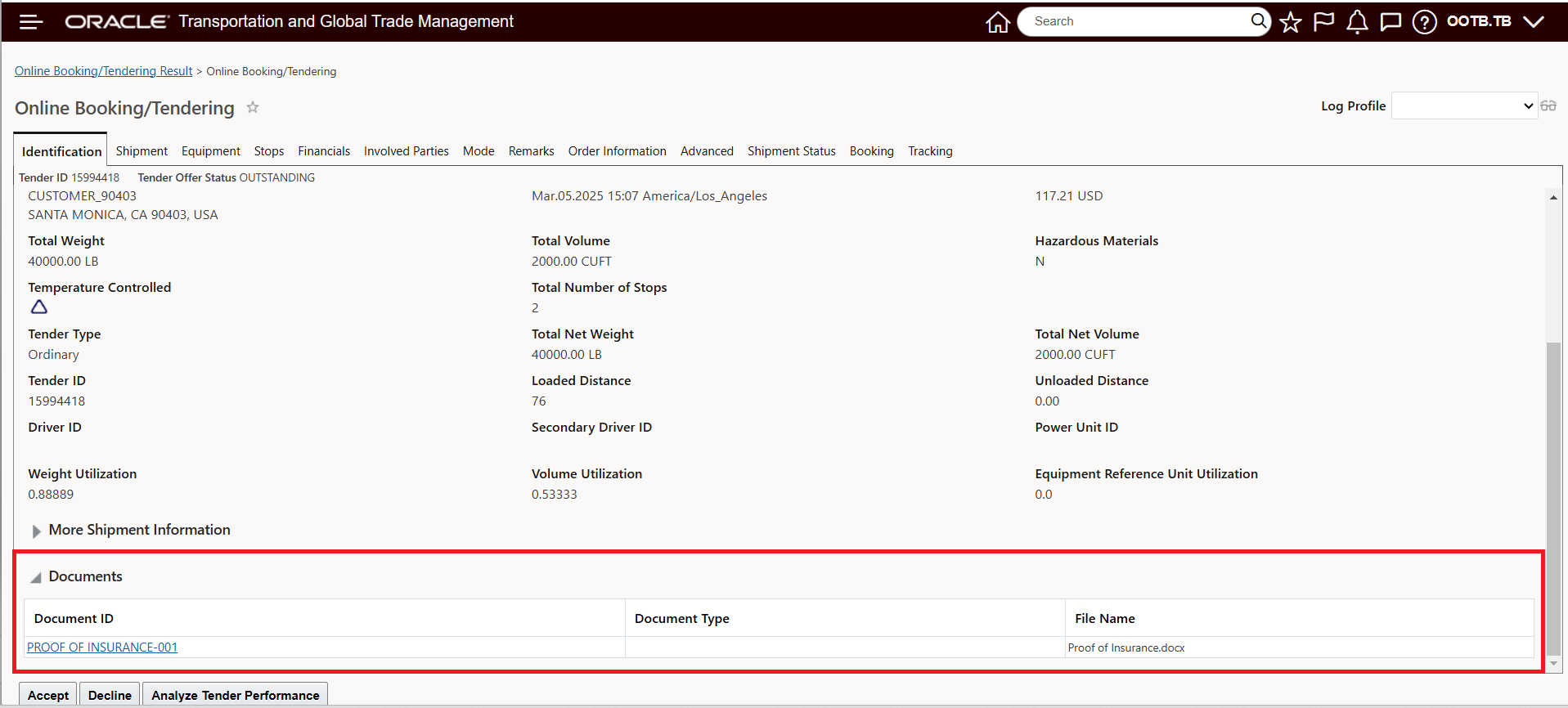

The uploaded document is visible to the planner and service provider on the Online Booking/Tendering screen as shown below.
Online Booking/Tendering  - Upload Document Visible for Planner
Online Booking/Tendering  - Upload Document Visible for Service Provider

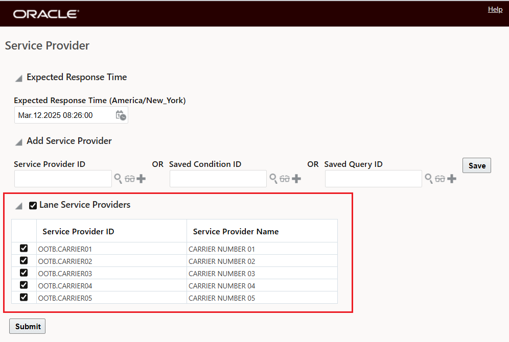

The example below shows how the “Upload Document” action works in a Spot Bid Tender scenario. In this case five service providers are involved invited to the Spot Bid, and all service providers will perform the “Upload Document” action to upload their terms and conditions documents.
Spot Bid Tender
Spot Bid Tender

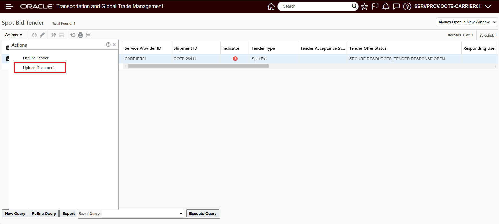

The first service provider runs the “Upload Document” action to upload the terms and conditions document.
Spot Bid Tender  - Service Provider Upload Document

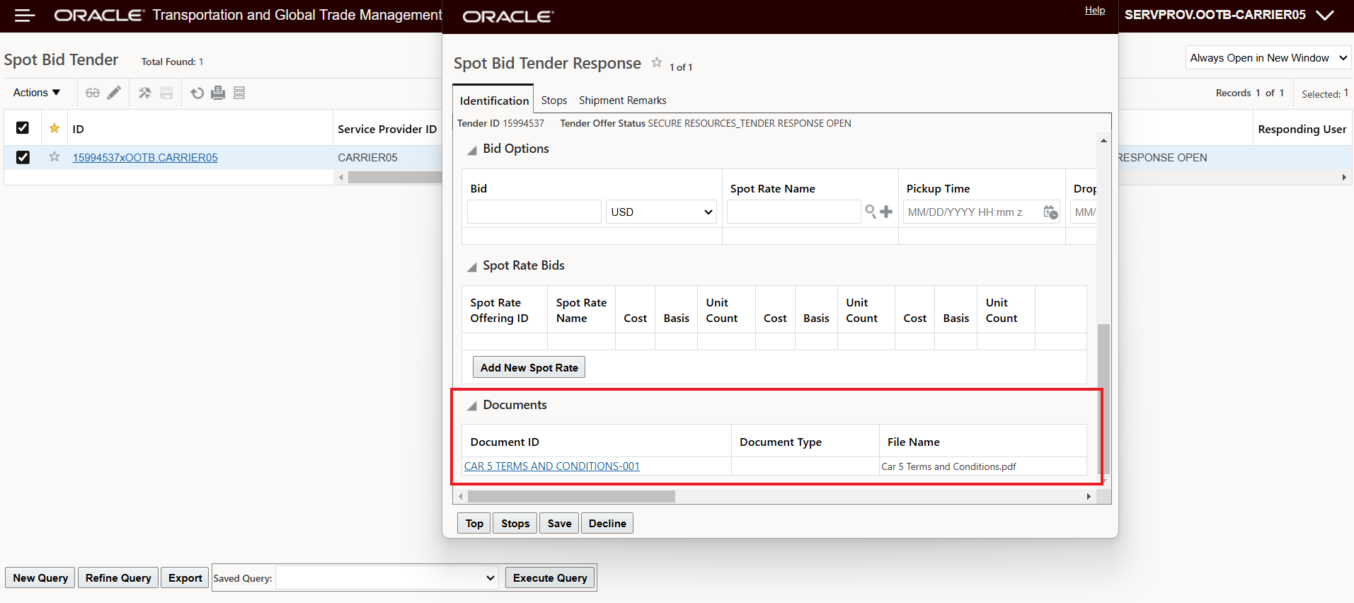

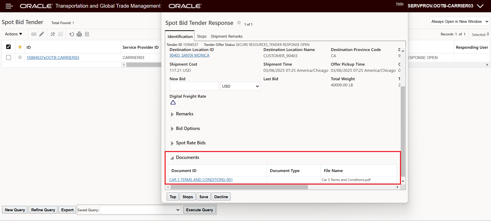

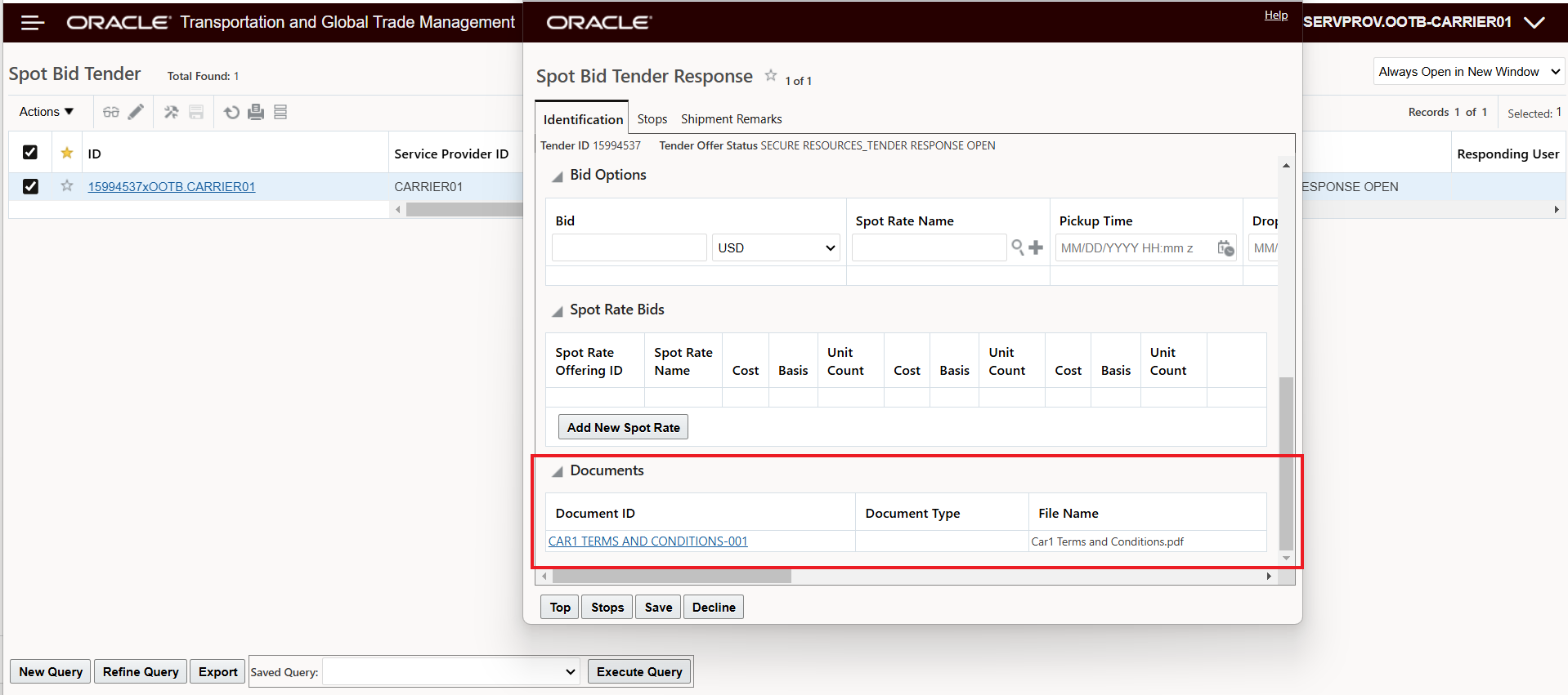

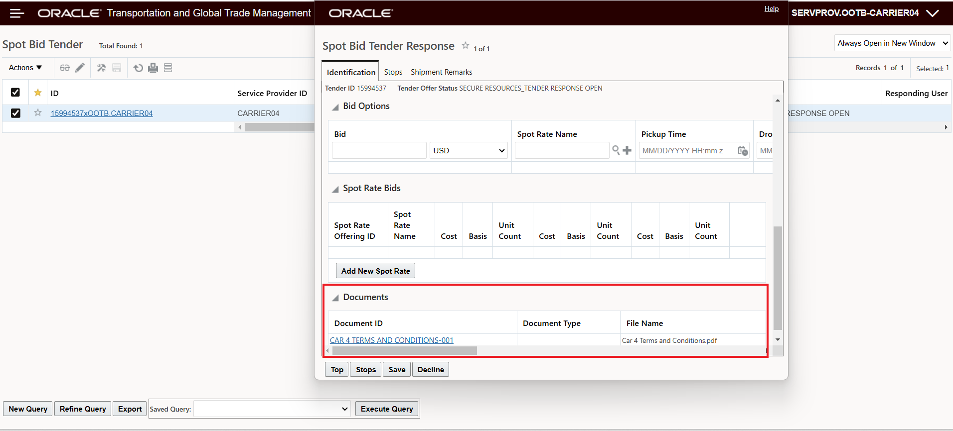

Once the document is uploaded, the service provider has visibility to the document in the Spot Bid Tender Response screen as shown below.
Spot Bid Tender Uploaded Document View for Service Provider
Spot Bid Tender Uploaded Document View for Service Provider Carrier01

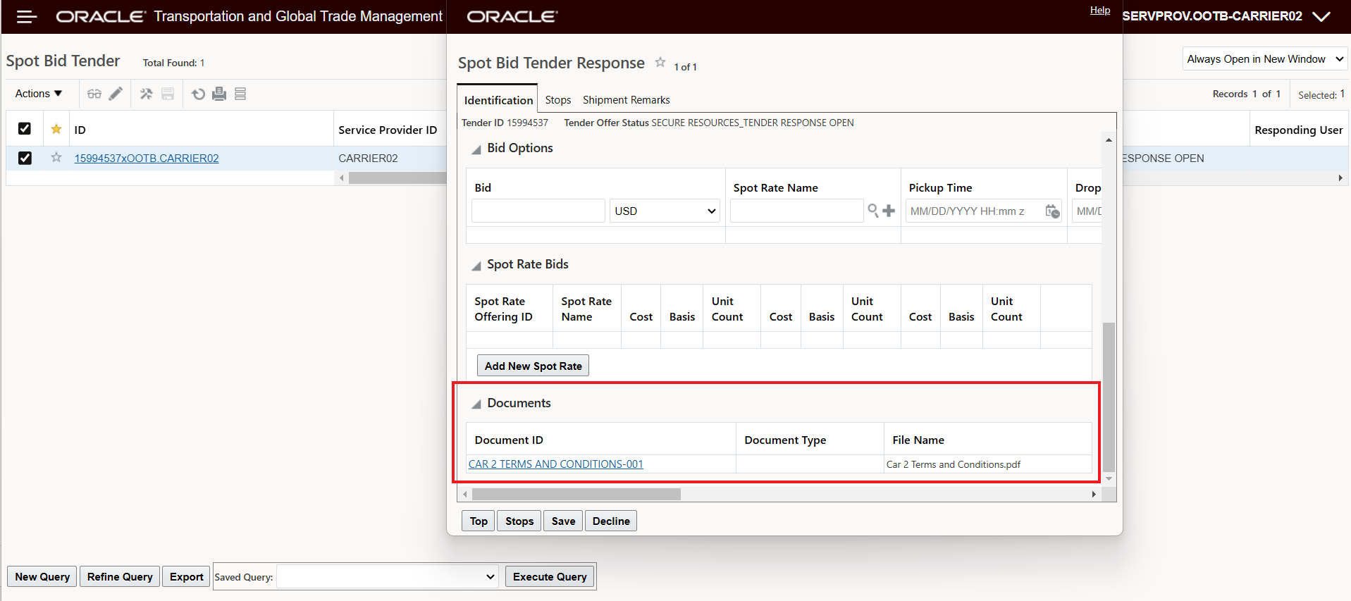

Spot Bid Tender Uploaded Document View for Service Provider Carrier02
Spot Bid Tender Uploaded Document View for Service Provider Carrier03
Spot Bid Tender Uploaded Document View for Service Provider Carrier04
Spot Bid Tender Uploaded Document View for Service Provider Carrier05

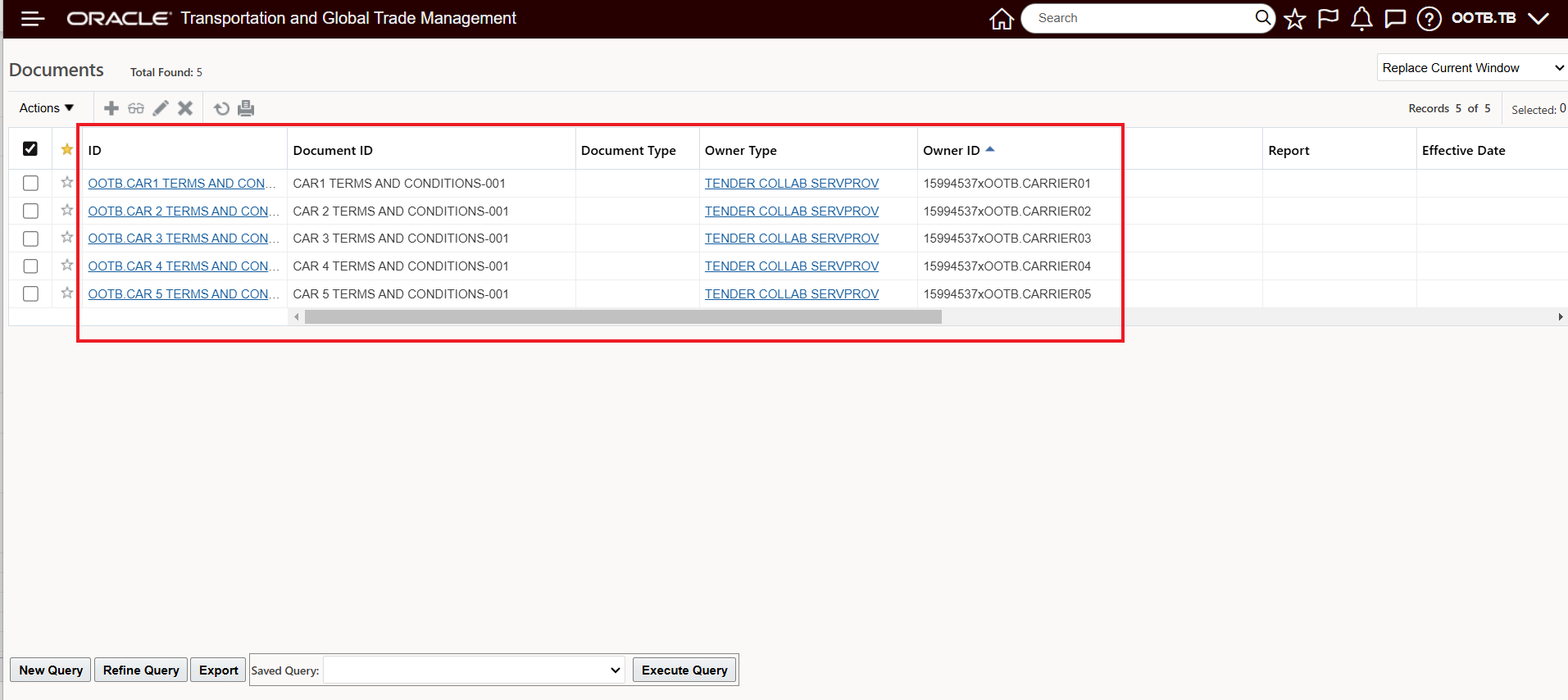

The set of documents are also visible to the planner in the Document Manager - Business Process Automation > Document Management > Document Manager, as shown below.
Documents View
Documents View

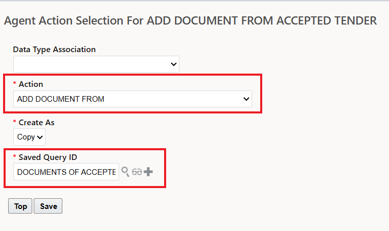

Copy/Link Accepted Tender Documents to Shipment
The the Automation Agent ADD DOCUMENT FROM should be used be used to support the logical step of coping the Service Provider's uploaded documents from their accepted tender to the shipment.  The Saved Query DOCUMENTS OF ACCEPTED TENDER FOR SHIPMENT has been provided to help configure the Automation Agent to get the documents from the accepted tender to the shipment.
Shipment Automation Agent Add Document From With Staged Saved Query
