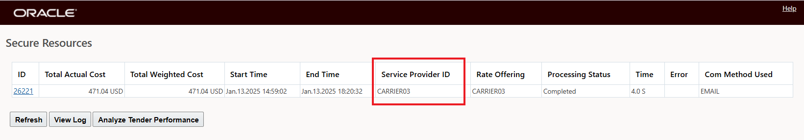

In the example below, the property “glog.webserver.tender.spotBid.excludeCarriersRejectedTender” is set to true, Carrier03 receives an ordinary tender offer for the shipment - 26221 and opts to decline/reject the tender offer. When shipment 26221, which was rejected by Carrier03 during ordinary tender, is sent out for a spot bid tender, Carrier03 will not be included in the list of service providers participating.
 Ordinary Tender to Carrier03

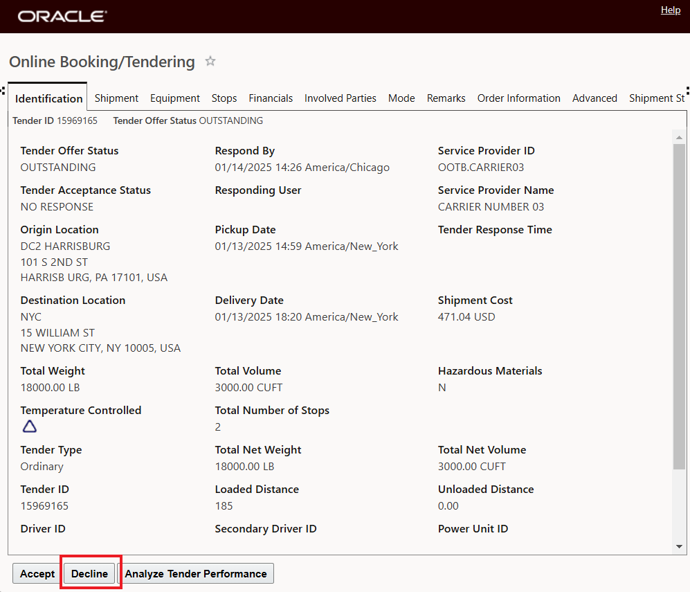

Carrier03 decides to decline the ordinary tender.
Ordinary Tender Declined

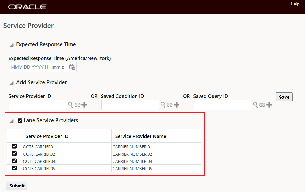

With Carrier03's decline of the ordinary tender, and with the property, glog.webserver.tender.spotBid.excludeCarriersRejectedTender, set to true, Carrier03 will not be included in the list of service providers participating in the spot bid tender that will be sent out for the same shipment, as shown below.
Carrier03 Not Included In Spot Bid Tender List of Lane Service Providers

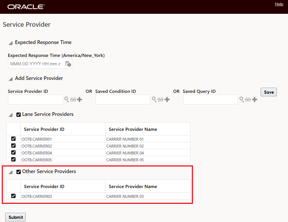

With the property set to true, you still have the option of adding the service provider(s) that are excluded as shown below.
Manually Added Service Providers Who Declined Ordinary Tender

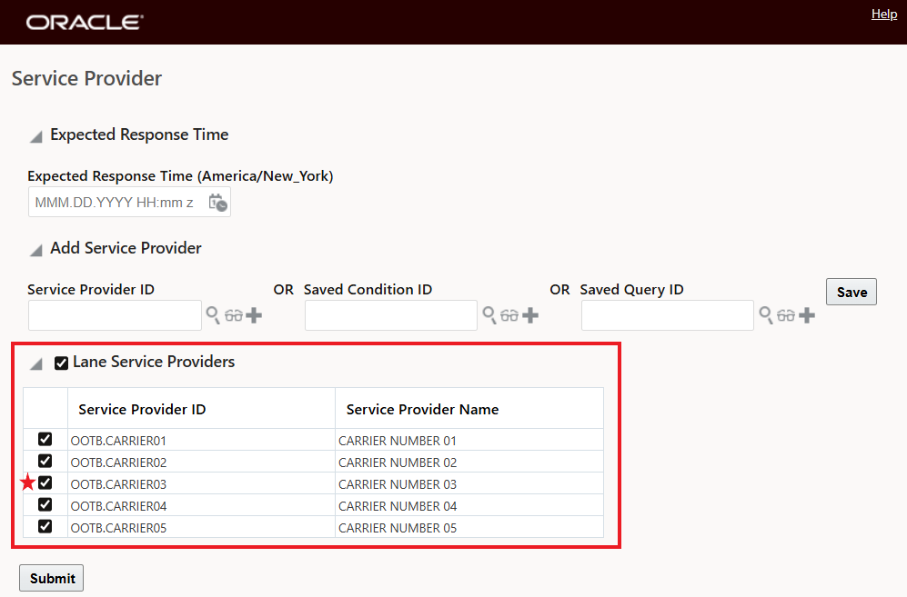

When the property, glog.webserver.tender.spotBid.excludeCarriersRejectedTender, is set to false (the default value), Carrier03 is included in the list of lane service providers, even though Carrier03 previously declined the ordinary tender for the same shipment.
Property Set to false (default) Carrier03 Included In Spot Bid Tender
