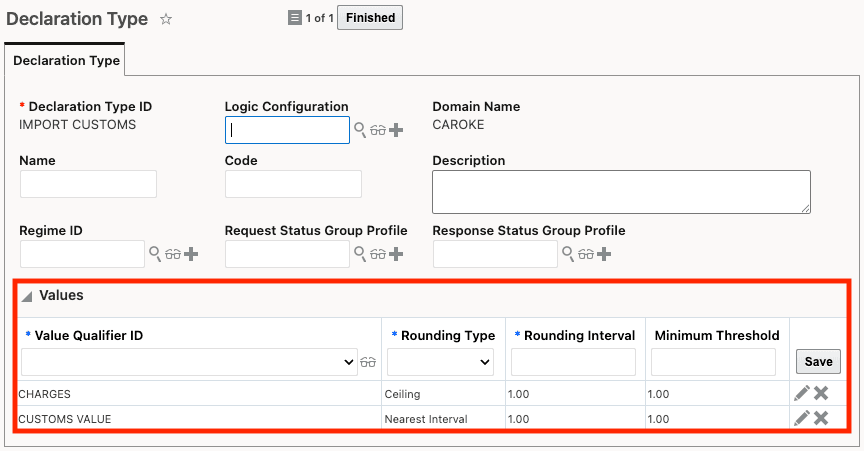

You can configure the following data for the rounding rules in the Declaration Type:
  • Value Qualifier - list the qualifiers you want to round
  • Rounding Type - select from 3 available rounding types:
    • Ceiling - round up based on the rounding interval
    • Floor - round down based on the rounding interval
    • Nearest Interval - round to the closest value based on the rounding interval
  • Rounding Interval - defines the interval you want to use for rounding
  • Minimum Threshold - the minimum value that can be reported. For example, when you define the minimum threshold as 1, any value below 1 is rounded up to 1.
In this scenario, you are reporting CUSTOMS VALUE and CHARGES as part of your customs filling.
  • CUSTOMS VALUE must be reported as a whole number and cannot be reported as less than 1.
  • CHARGES must be rounded up to the next whole number and cannot be reported as less than 1.
Declaration Type with Value Qualifiers

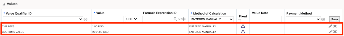

In this example, you are creating a declaration from a trade transaction which includes the following values:
Trade Transaction Values
When you create the declaration/declaration line from a trade transaction/trade transaction line, the values are rounded as follows:
  • CHARGES are rounded up to 1 due to the minimum threshold
  • CUSTOMS VALUE is rounded to the closest rounding interval of 1
Declaration Values
Declaration Values
