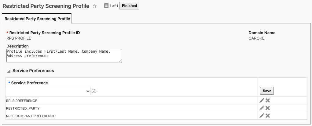

Restricted Party Screening Profile
The Restricted Party Screening Profile is a list of the service preferences you want to run for party screening. You may have multiple service preferences which are used for different restricted party screenings. If you usually run them separately, you can now add them to a profile and run them during the same restricted party screening process.
Once you create a profile, you can use it when running restricted party screening as a bulk process or via a batch process.

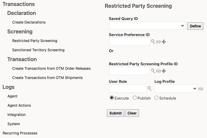

Restricted Party Screening Process Management
When triggering a bulk process, navigate to Trade Transaction > Process Management > Restricted Party Screening. You can specify a Service Preference ID or the new Restricted Party Screening Profile ID.
  • If a Restricted Party Screening Profile ID is specified, each party in the Saved Query is screened against the list of service preferences in the profile.
  • If a Restricted Party Screening Profile ID is not specified, the process runs against the Service Preference ID.
NOTE: If both the Service Preference ID and the new Restricted Party Screening Profile ID are specified, an exception is thrown in the log.

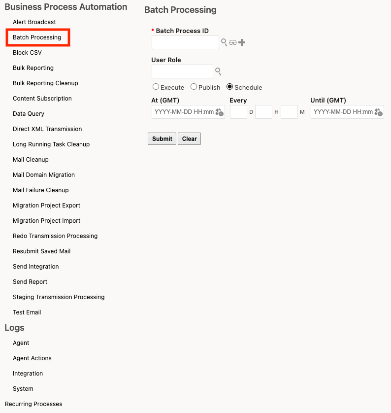

Batch Process for Restricted Party Screening
When triggering restricted party screening via a batch process, navigate to Business Process Automation > Process Management > Batch Processing. Configure a batch process for a Process Action ID of Screen Party.
Batch Processing
Batch Processing
