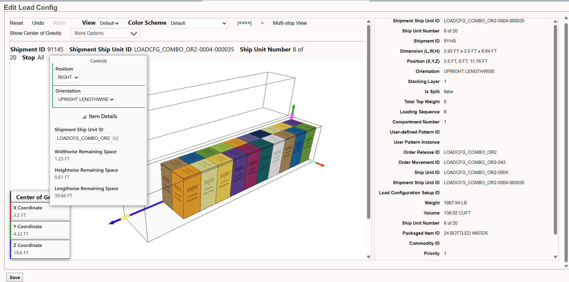

In the example below, the Ground Schedule has been configured to Invoke Container Optimization with 3D resulting in the Load Configuration View belowInvoke Container Optimization Single Equipment

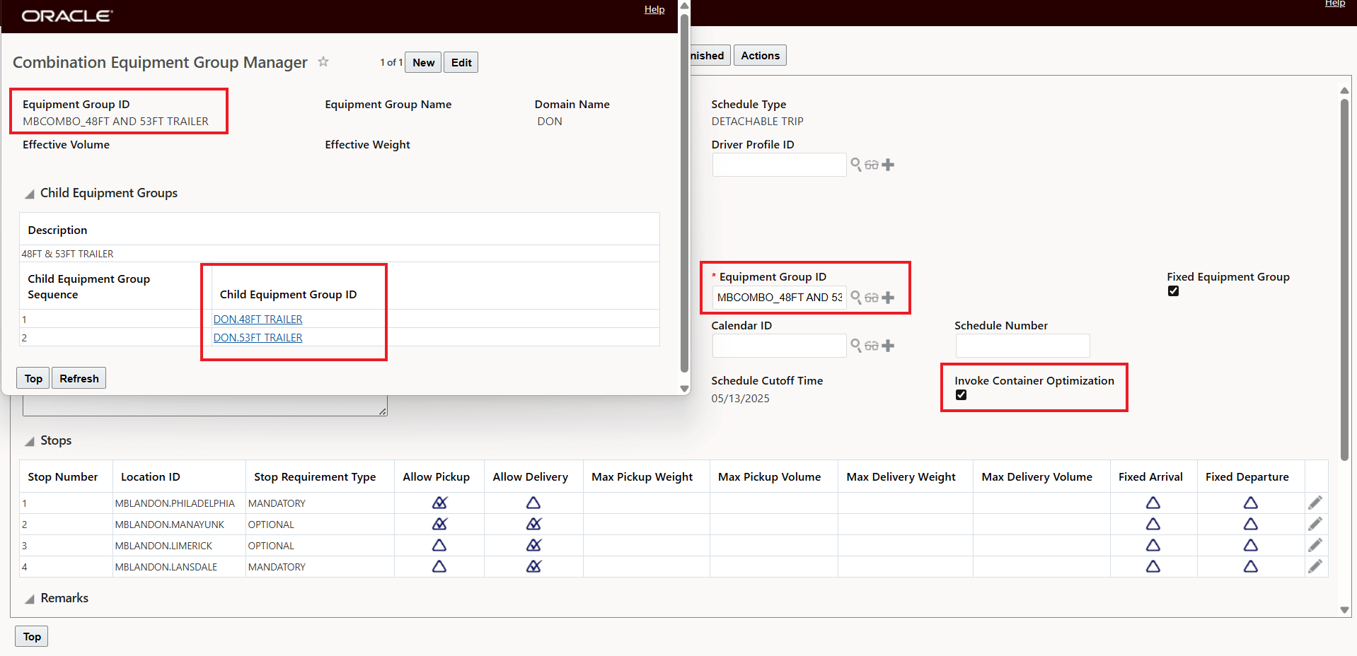

Combination Equipment Group
In the example below, the Ground Schedule has been configured with a Combination Equipment Group, previously your Ground Schedules could not be configured to use Combination Equipment Groups, now, with the Invoke Container Optimization option selected, you have the option to have your Ground Schedules configured to use Combination Equipment Groups. The Combination Equipment Group supports two Child Equipment Groups - a 48 Foot and 53 Foot dry van.

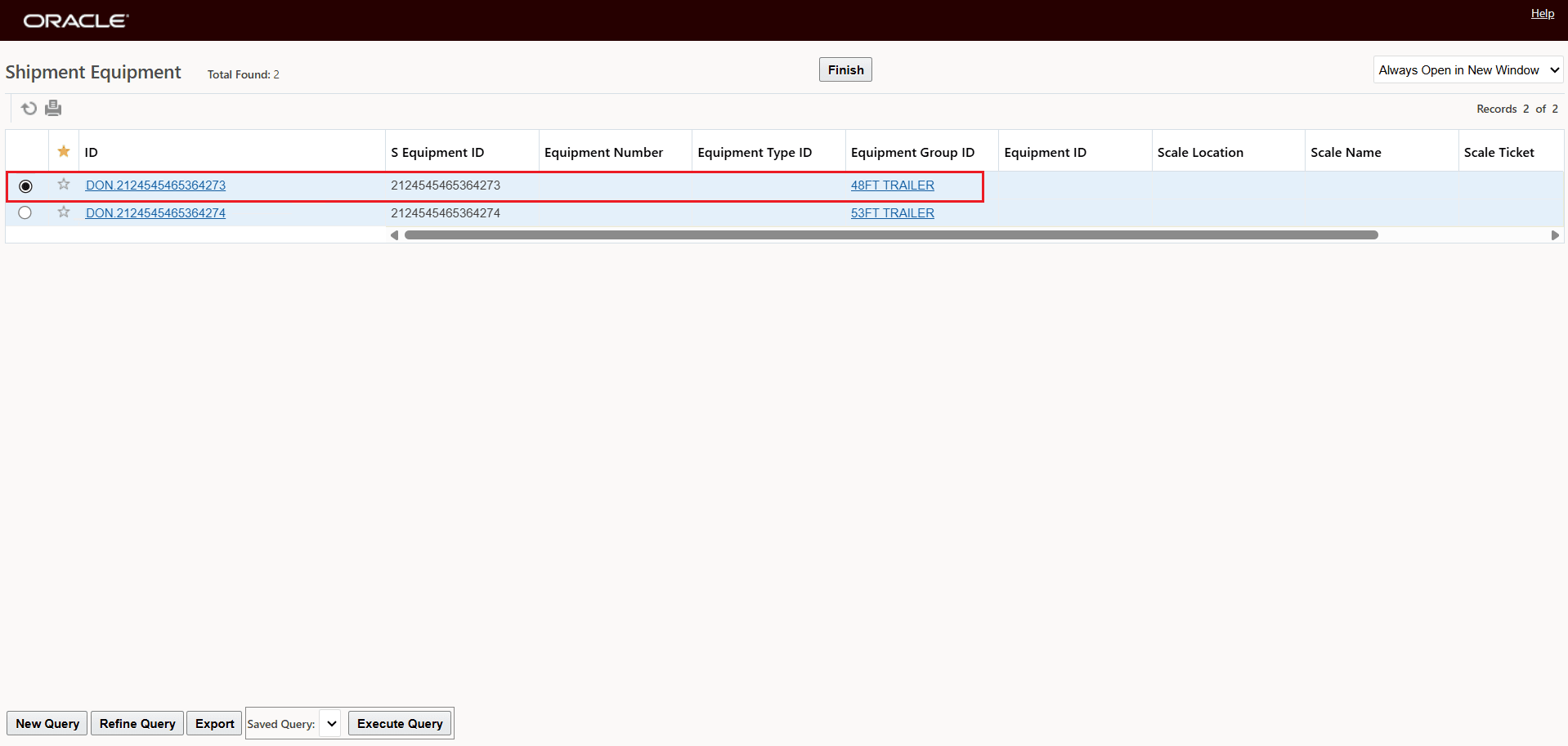

When this Ground Schedule is used in planning, when necessary, both Child Equipment Groups will/can be used in the solution, as shown below using the Buy Shipment Actions > Operational Planning > View > Edit Load Config or Load Config view.
Combination Equipment Group - Select Child Equipment Group on Ground Schedule Shipment

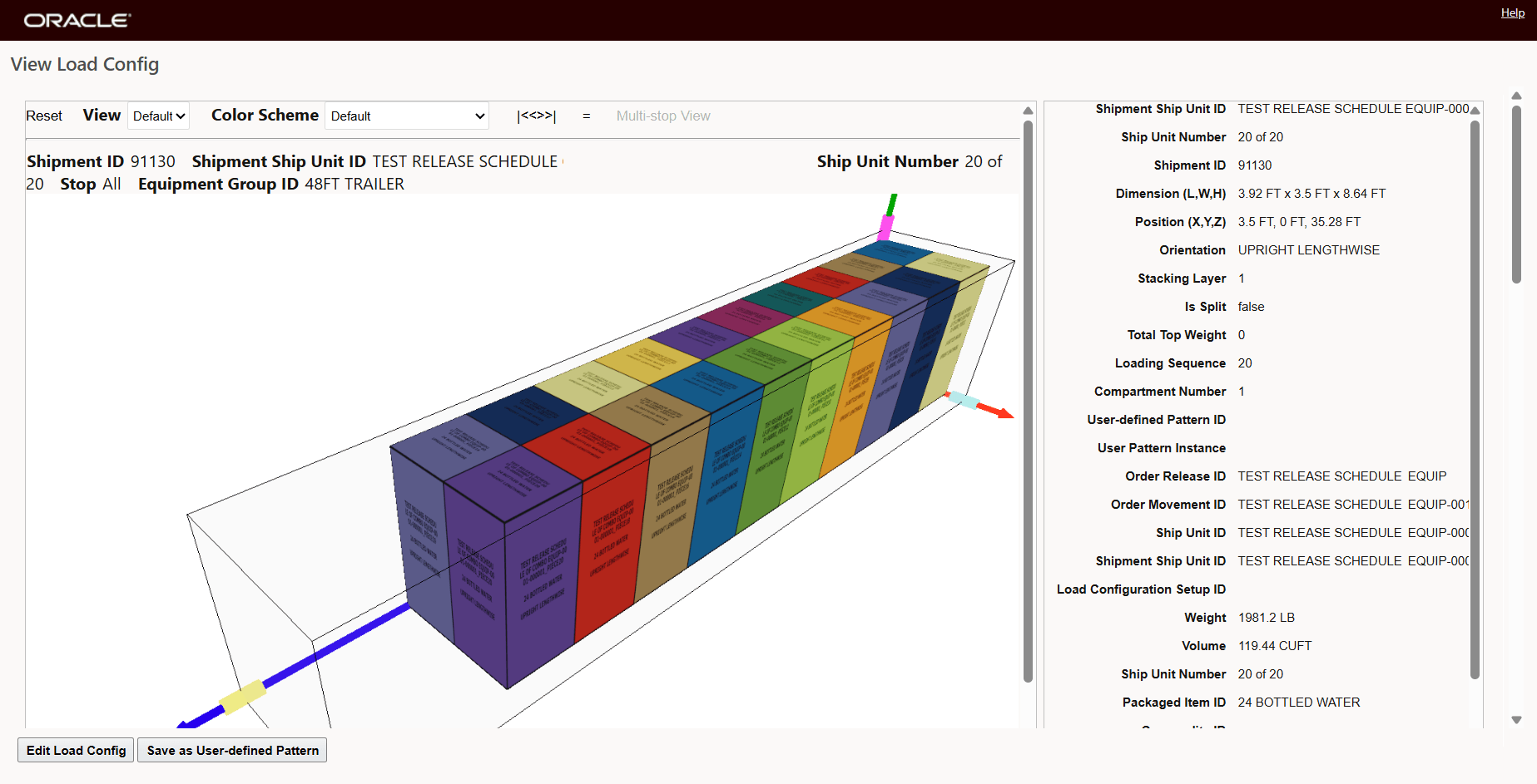

Below is the first Child Equipment Group, the 48FT_Trailer.
 Combination Equipment Group - Child Equipment Group 48FT_Trailer

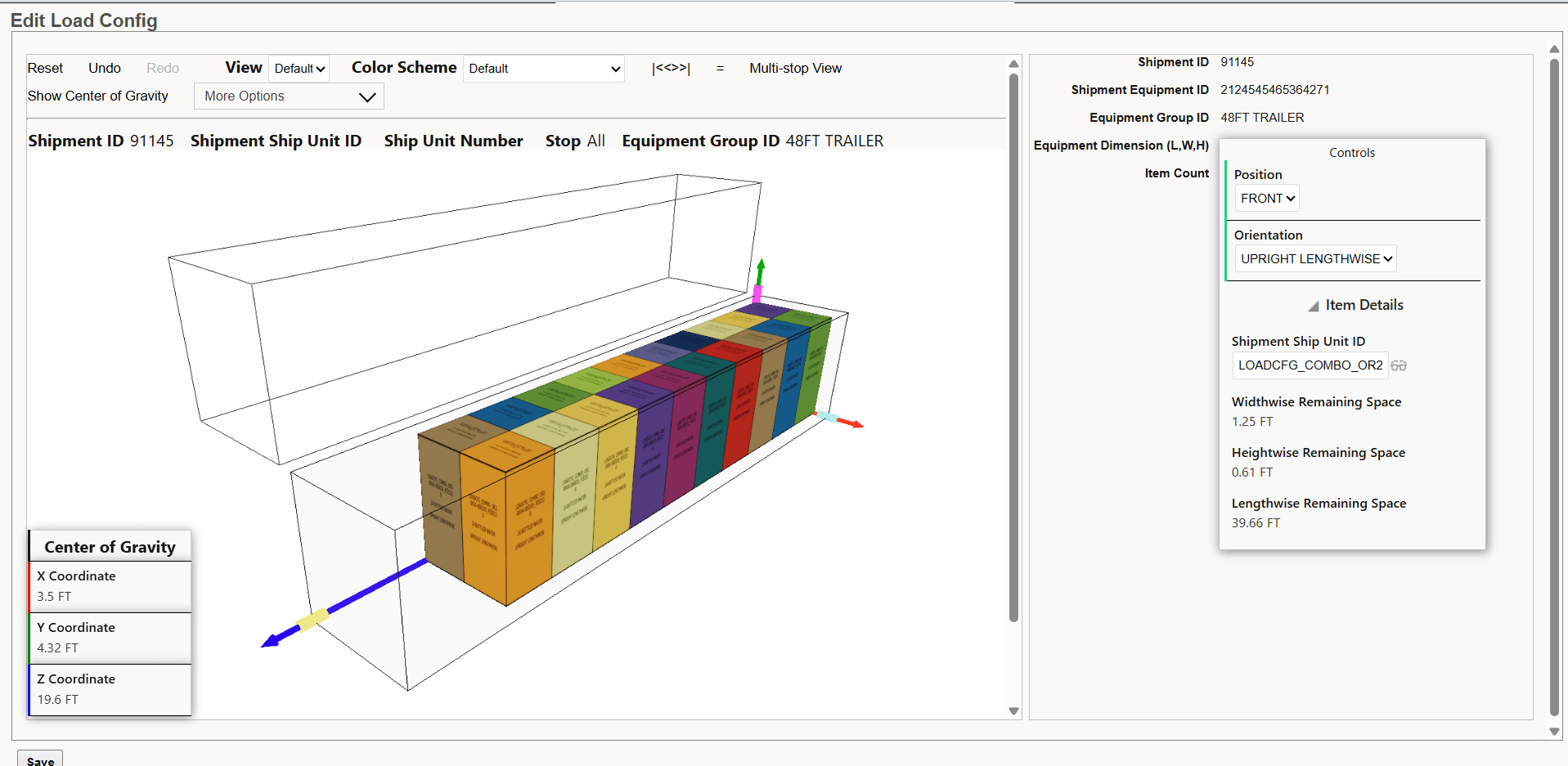

Below is the second Child Equipment Group, the 53FT_Trailer.
Combination Equipment Group - Select Child Equipment Group 53FT_Trailer

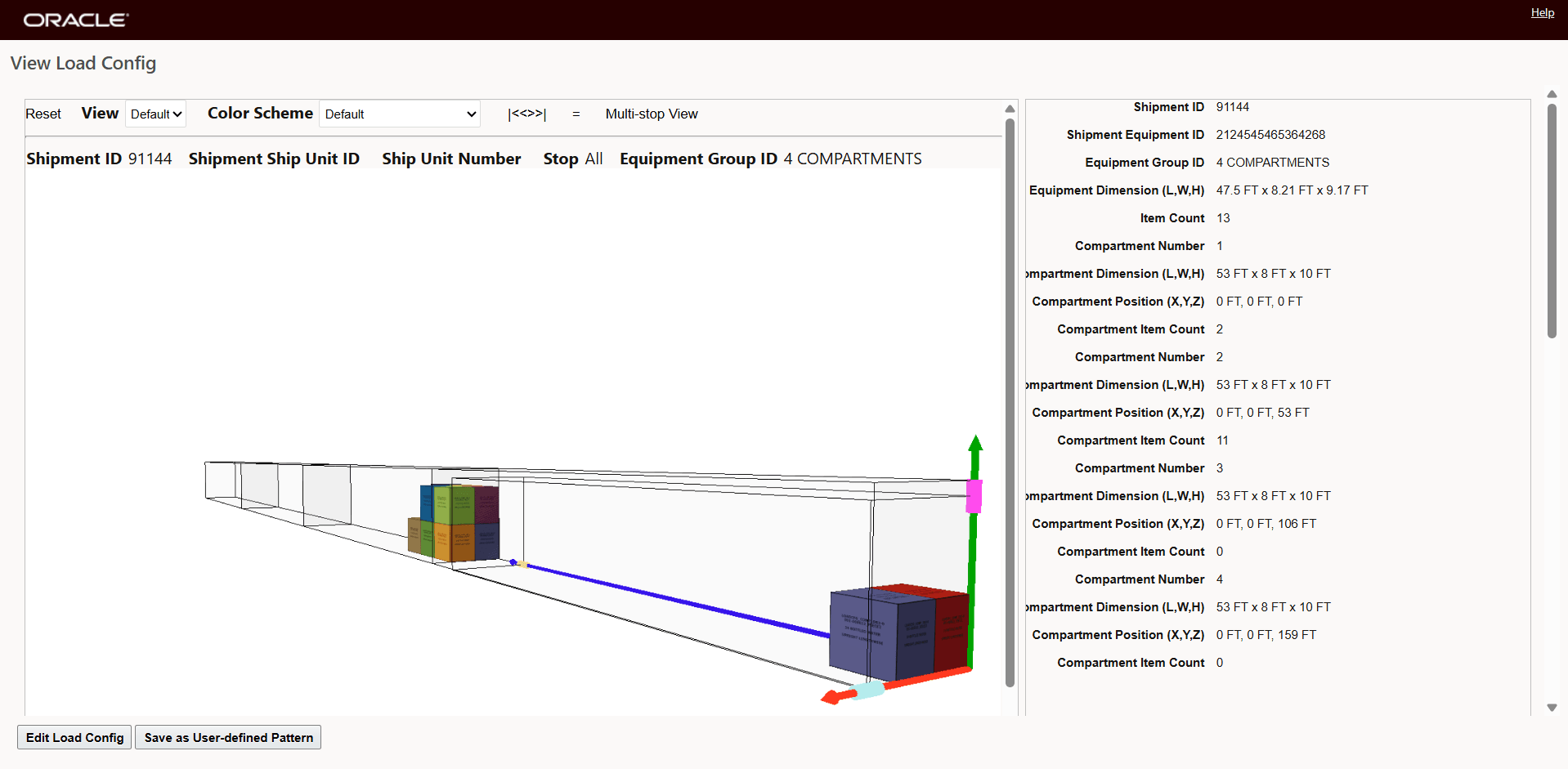

Compartments
In the example below, the Ground Schedule has been configured to use a multi-compartment equipment group. With equipment groups with compartments order bundles added to the ground schedule shipment can split into different compartments.
Multi-Compartment Equipment Group
