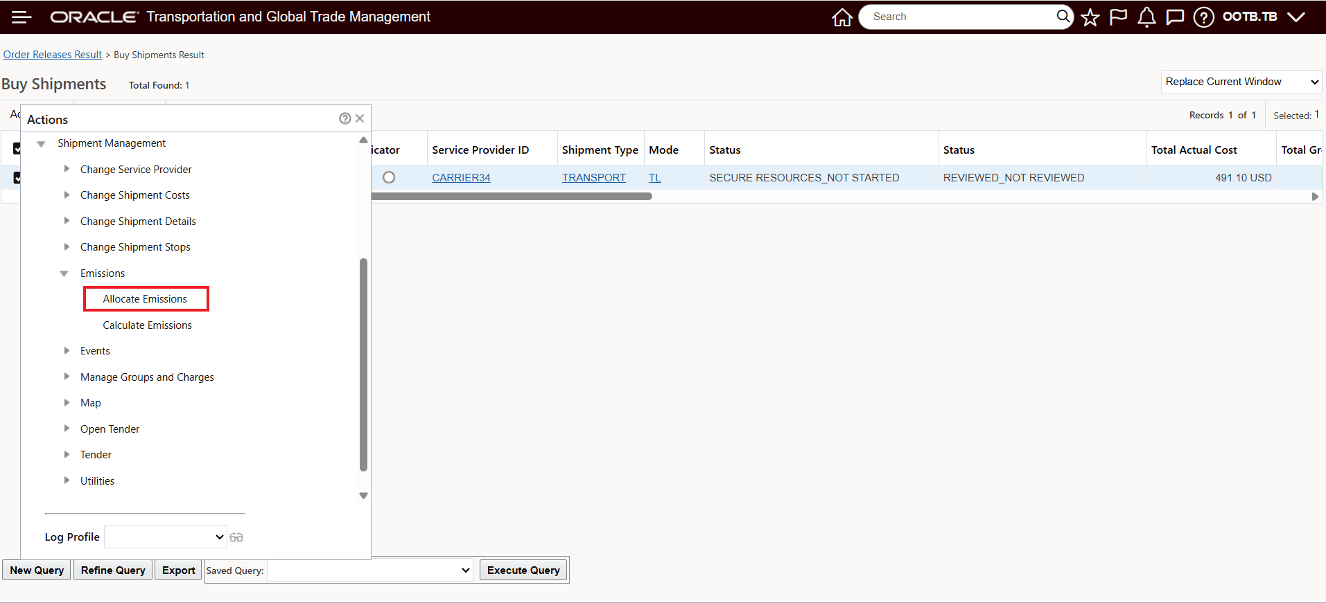

This feature supports the order release and order release line allocation of the calculated CO2e emissions.  The action and setup for the shipment action - Allocate Emissions - is handled independently from the Allocate Cost action.
The Allocate Emissions shipment action is accessed via Shipment Management > Shipment Management > Buy Shipments or Sell Shipments > Actions > Shipment Management > Change Shipment Details > Allocate Emissions.
Shipment - Allocate Emissions Action

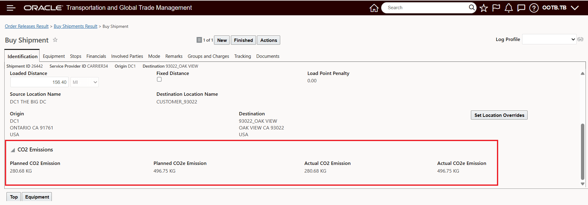

Bulk planning the three order releases generates the shipment with the emissions totals as shown below.
Shipment Emissions
Shipment Emissions

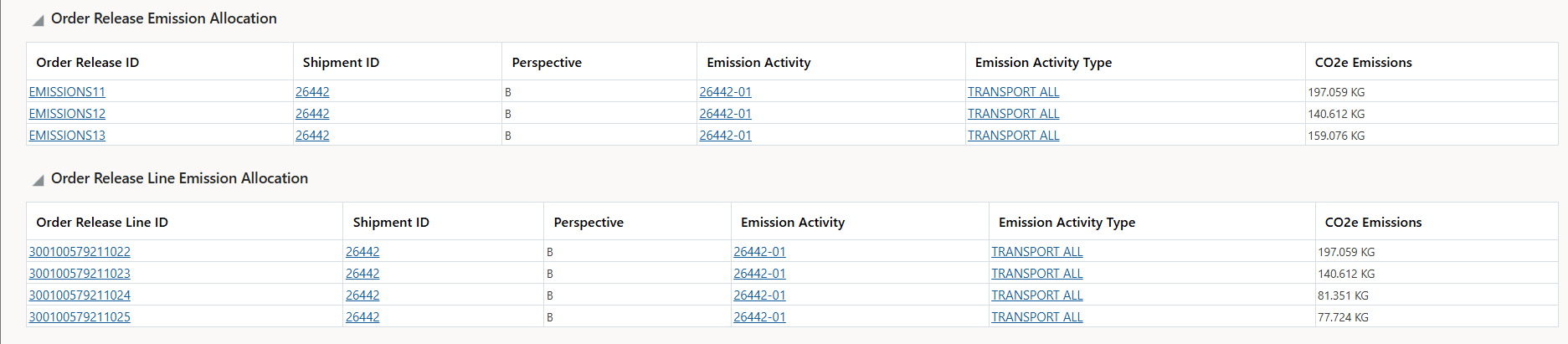

Running the Allocate Emissions action against the shipment generated for the three order releases - above, provides the following Order Release Emission Allocation information for the shipment.
Shipment Allocate Emissions Result
In this case, the Emission Allocation Rule, shown below, has the Allocation Rule Detail Metric, for both the order release and order release line, set to Weight Carried Distance.  In addition - the Allocation Rule has been configured as the Default Allocation Rule - more information will be provided about the Emission Allocation Rules in the Steps to Enable section.

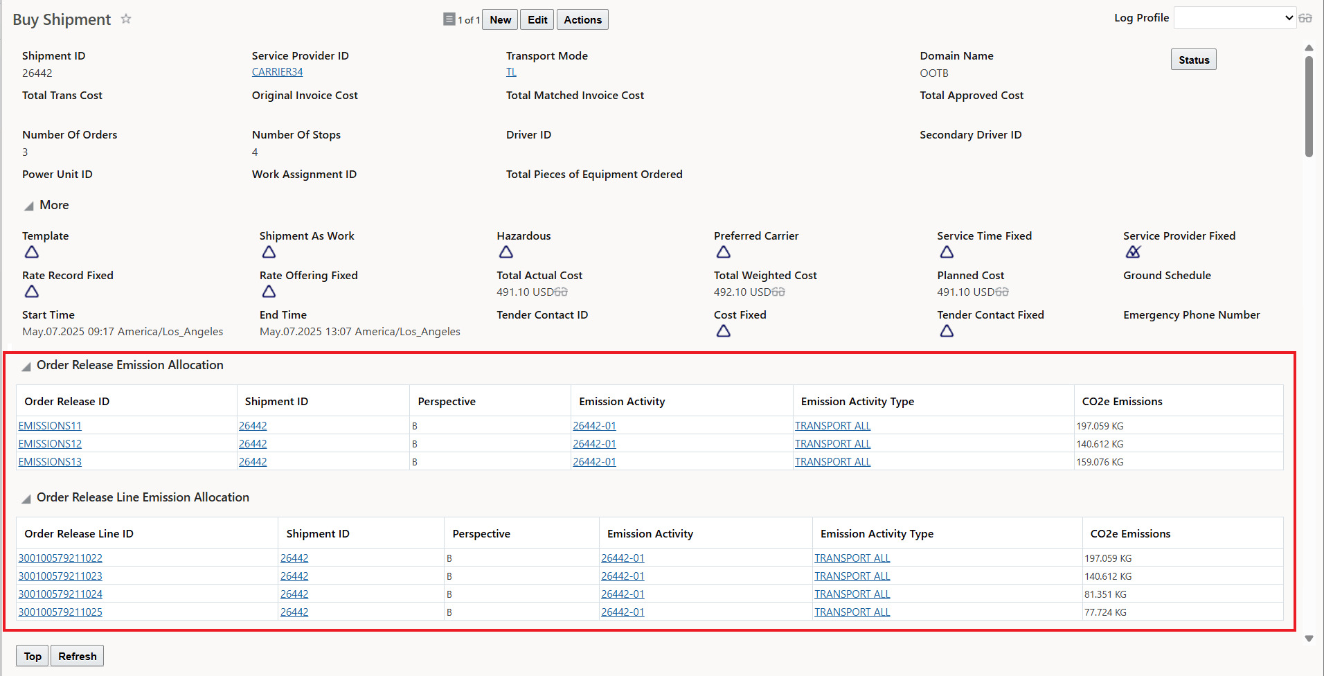

The Allocate Emissions result for the three order releases is shown below - again - the CO2e is allocated to both the order release and the order release lines for each order on the shipment above.
Allocate Emissions result for the first order release with one order release line is below.

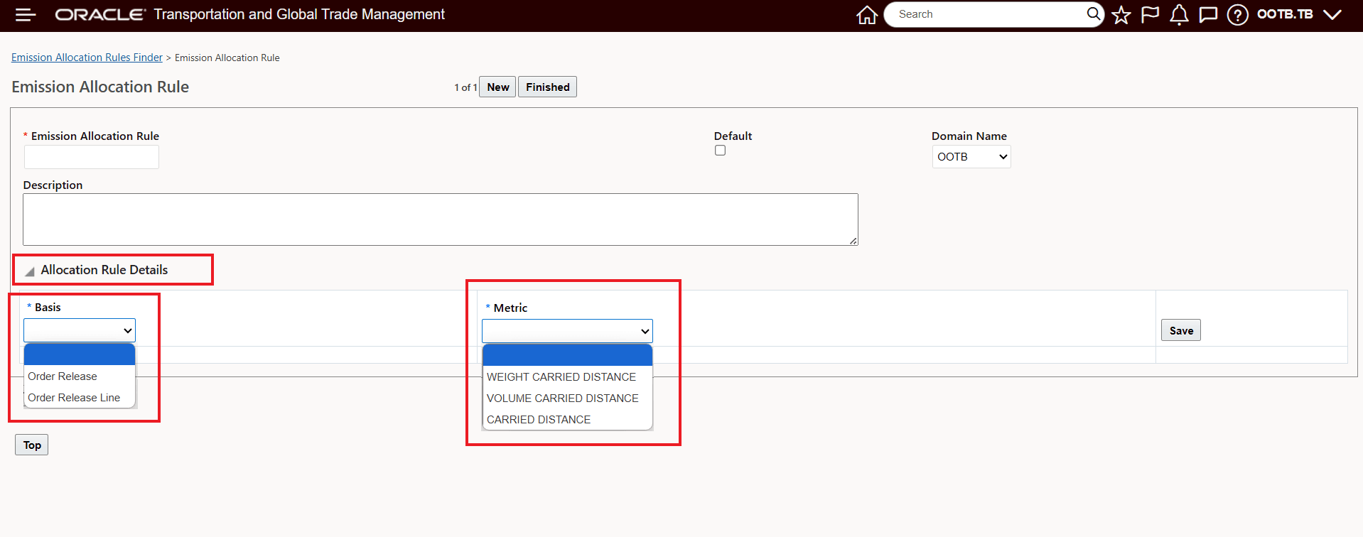

To take advantage of this feature and effectively use the Allocate Emissions action - you will need to configure an Emission Allocation Rule. The Emission Allocation Rules can be found by navigating to Shipment Management > Power Data >  Emission> Emission Allocation Rules.
For your Emission Allocation Rule - enter an Emission Allocation Rule ID - that's required - there's no BNG to fall back on without an entered value.
You can select the entered Emission Allocation Rule to be the Domain Default Emission Allocation Rule - one per domain.  The logic will fist look for the Emission Allocation Rule to use on the Emission Activity Rule - if there is no Emission Allocation Rule specified on the Emission Activity Rule, then the Domain Default Emission Allocation Rule - if one is configured - will be used.
Allocation Rule - Header
For the Allocation Rule Details, you have the following options to configure - Basis either Order Release or Order Release Line and then the Metric to be used for allocating the emissions. The supported allocation metrics for emission allocations are Weight Carried Distance, Volume Carried Distance or Carried Distance. Only one allocation metric can be selected per allocation rule, and the metric will be applied at 100%.
Allocation Rule - Allocation Rule Details

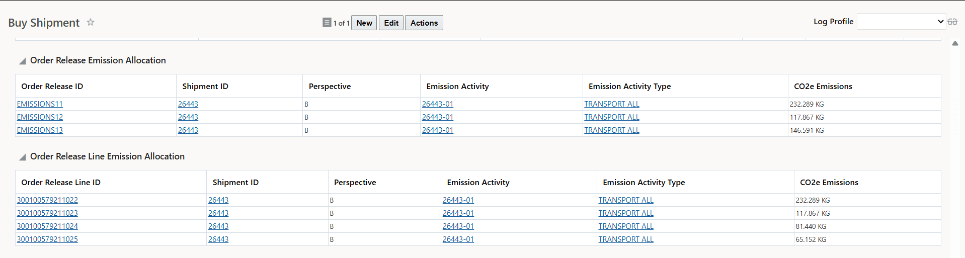

By comparison - the Domain Default Allocation Rule provided the Emission Allocation result below.
Domain Default Emission Allocation Result
