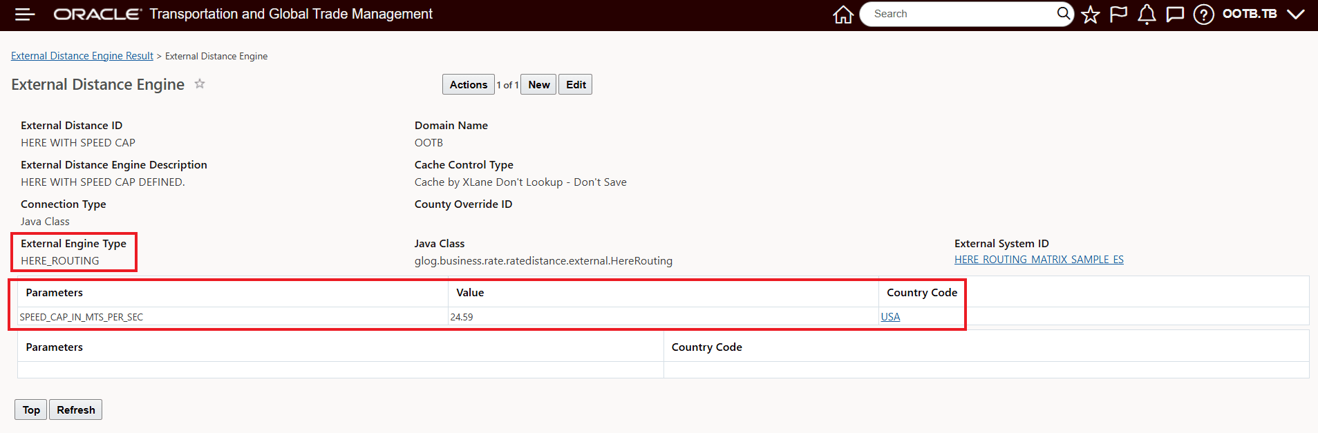

Speed Cap Parameter - SPEED_CAP_IN_MTS_PER_SEC

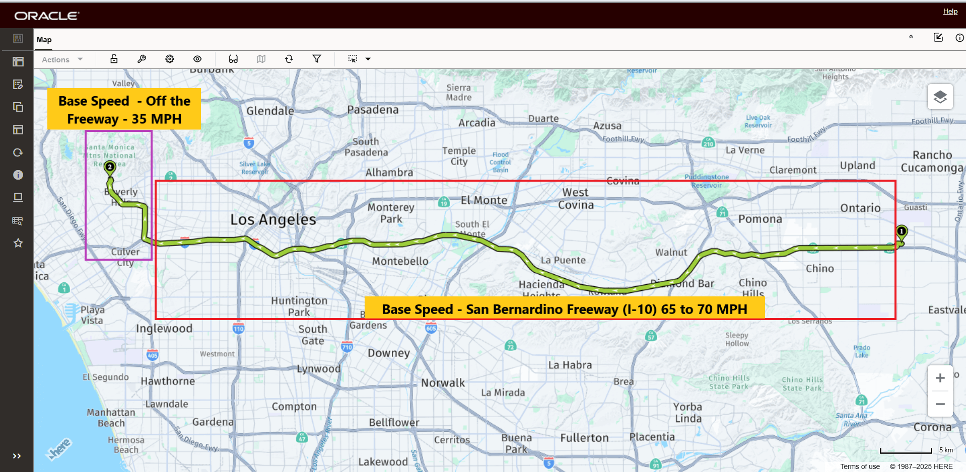

In the example below, most of the route uses the San Bernadino Freeway (I-10) in California.  The base speed limit for the San Bernardino is between 65 and 70 MPH, in this scenario the desire is to have the transit time reflect a Speed Cap of 55 MPH.  Setting the  SPEED_CAP_IN_MTS_PER_SEC parameter to 24.59 meters per second - as shown above - will satisfy this requirement by capping the top speed used by Here's routing logic to 55 MPH or 24.59 meters per second.
NOTE: The portion of this route that does not involve driving on the San Bernadino Freeway (I-10) the portion highlighted in purple - will not be impacted by the Speed Cap since the base speed for this portion of the route is only 35 MPH or 15.64 meters per second.
Speed Cap Application Example

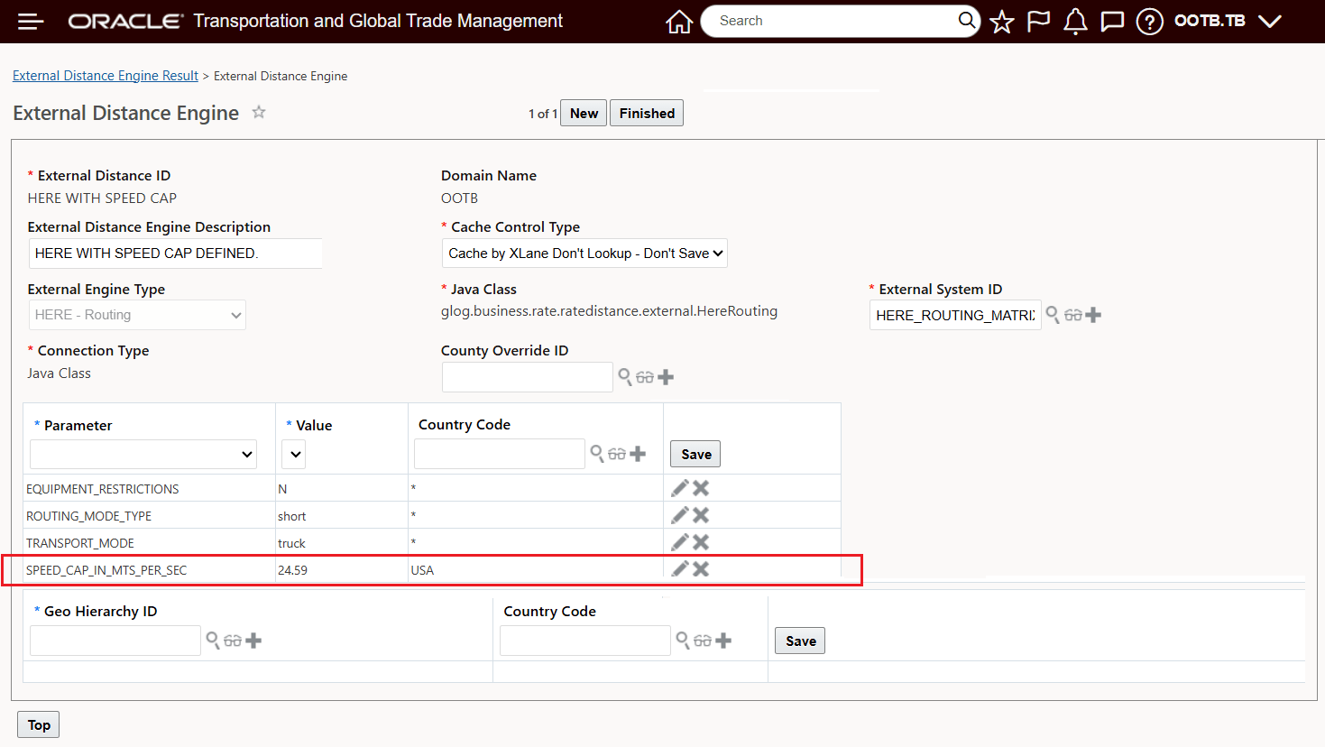

Steps to Enable and Configure
This take advantage of this feature, you will need to add the Speed Cap SPEED_CAP_IN_MTS_PER_SEC parameter to a new or existing Here Technologies External Distance configuration.
Speed Cap Configuration
