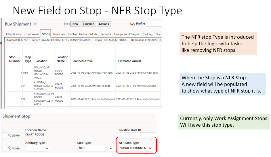

Non-Freight Related Stop Type
There is a new field, NFR Stop Type, added to the Shipment Stop to support the Non-Freight Related Stop Type when the stop is a Non Freight Related Stop. This allows the logic to utilize this information when performing actions. It defaults to Work Assignment for NFR Stops added due to Work Assignment and helps when removing that stop when a shipment is removed from a work assignment. A Non-Freight Related Stop is typically added to represent a stop where a shipment either starts or ends where there is no freight picked up or dropped off. This can represent a depot or a domicile or the place where a shipment starts when two shipments re strung together. This allows the logic to utilize this information when performing actions. It defaults to Work Assignment Stops and helps when removing that stop when a shipment is removed from a work assignment.
Non Related Freight Stop Tpe
Non Related Freight Stop Type
This new field is helpful if you want to see the origin of the stop. A Non-Freight Related Stop is typically added to represent a stop where a shipment either starts or ends where there is no freight picked up or dropped off. This can represent a depot or a domicile or the place where a shipment starts when two shipments are strung together. When the Work Assignment is disbanded, those stops are no longer relevant to the shipment.
