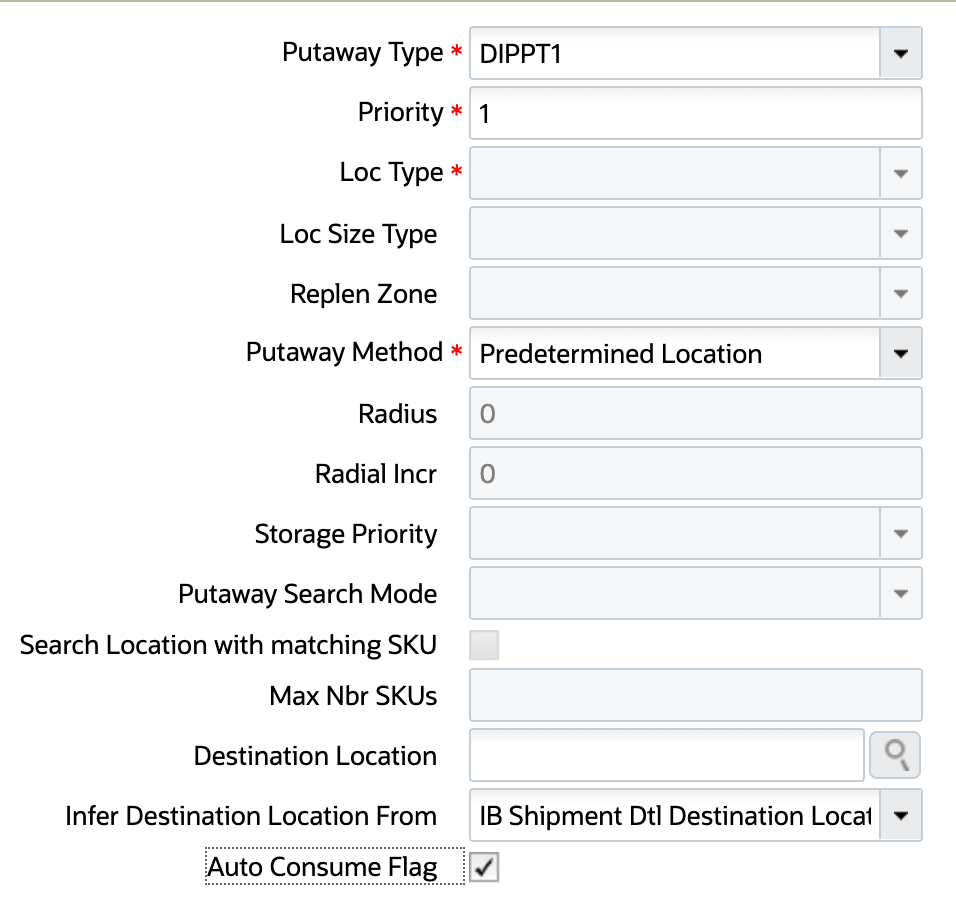

  • Putaway Priority has been enhanced with a new Putaway Method, “Predetermined Location”, to direct the LPNs to the predefined location/work center during System Directed Putaway. When the Putaway Method is set to “Predetermined Location”, the following three new configuration fields will be enabled for edit:

  1. SET UP PUTAWAY PRIORITY:
    1. Select Putaway Type = DIPPT1.
    2. Set a Priority.
    3. Select Putaway Method = Predetermined Location.
    4. Select Infer Destination Location From = IB Shipment Dtl Destination Location.
    5. Enable Auto Consume Flag.
    6. Click Save.
Putaway Priority Set Up
