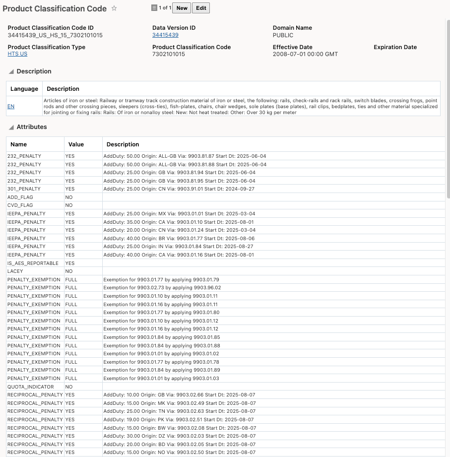

In this example, you are importing steel into the United States for use in railways. The relevant HTS US classification code is 7302101015. If the optional feature is set to false (the default setting), the product classification code attributes will include all applicable potential penalties. To view this information, navigate to Classification > Product Classification Codes.
Product Classification Code Attributes with Full Penalties

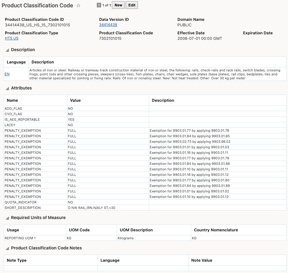

If the optional feature is set to true, the product classification code attributes will not contain the following penalties: 232_PENALTY, 301_PENALTY, IEEPA_PENALTY and RECIPROCAL PENALTY.
Product Classification Code Attributes without Full Penalties

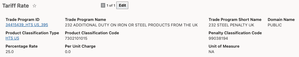

If you want to view penalties associated with a particular product classification code, you can use tariff rates. Navigate to Master Data > Power Data > Tariff > Tariff Rates. This object provides detailed information, with each penalty represented as a single tariff rate.
In this example, search using Product Classification Type = HTS US and Product Classification Code = 7302101015, then select a 232 steel penalty to view its details.
Tariff Rate for 232 Additional Duty on Iron/Steel Products
