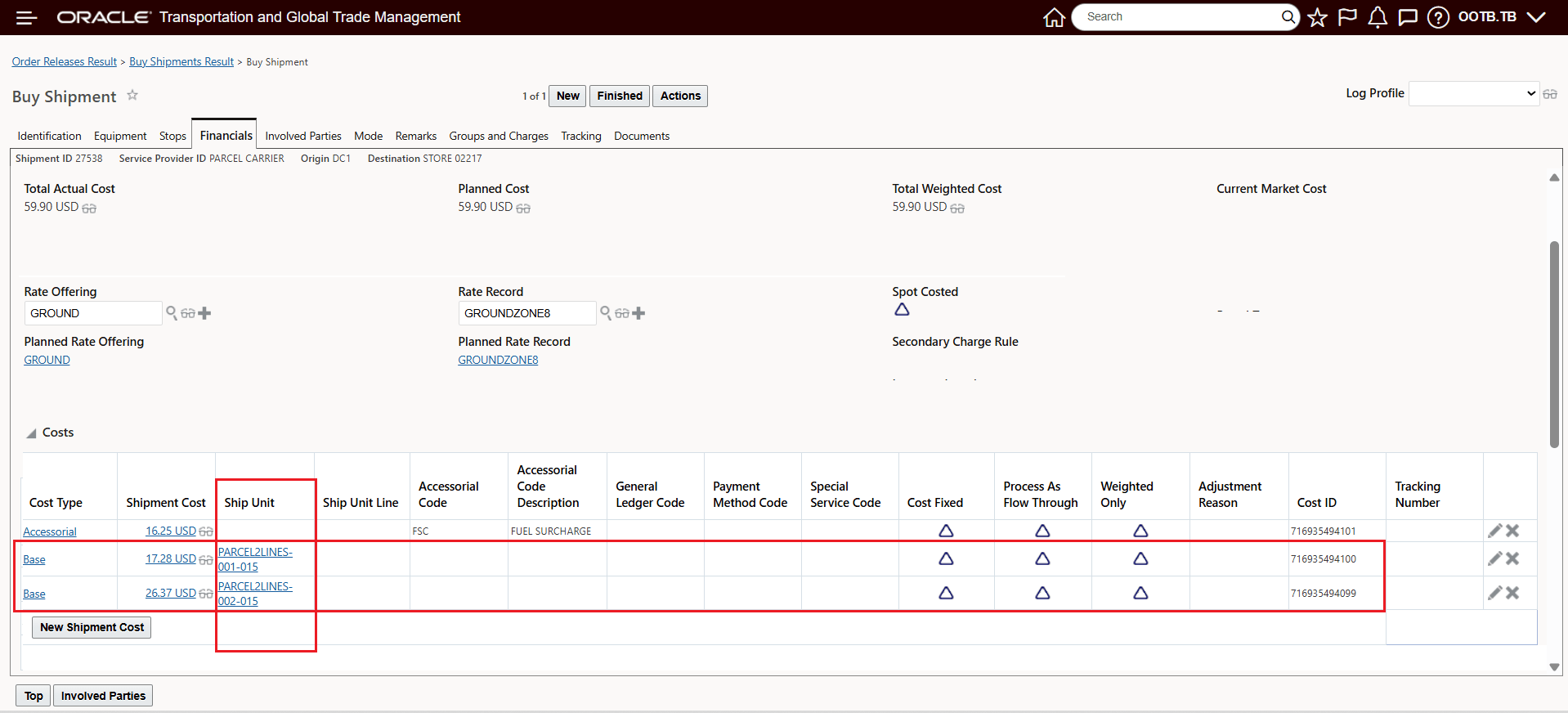

In the example below, the shipment involves shipping two ship units - one ship unit weighs 25 LBs and the second weighs 40 LBs.  Previously, while the application would properly rate the shipment, the individually calculated cost for each of the ship units would be rolled up into a single Base cost entry.  Now, the individual costs for the costed ship units are provided with a system generated ID - as shown below.
Shipment Ship Unit Cost Visibility

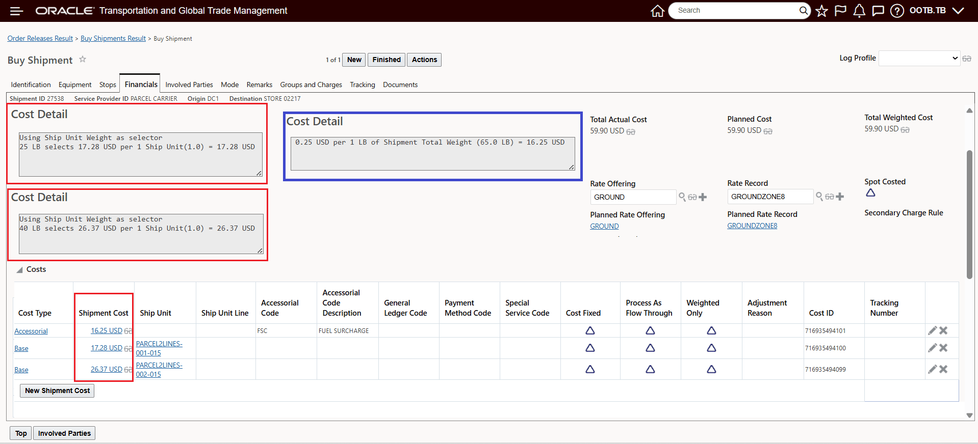

The UI below drills into the shipment cost Cost Details, providing the calculation information for each of the costs calculated for the shipment.   The two Base costs calculations are for the two ship unit level rates, for this parcel scenario the correct rate was selected for the two different weight ship units (25 LB and 40 LB), in addition, the accessorial charge (highlighted in blue) is calculated based on the total weight of the shipment - in this case 65 LBs.
Cost Detail(s) Ship Unit and Accessorial

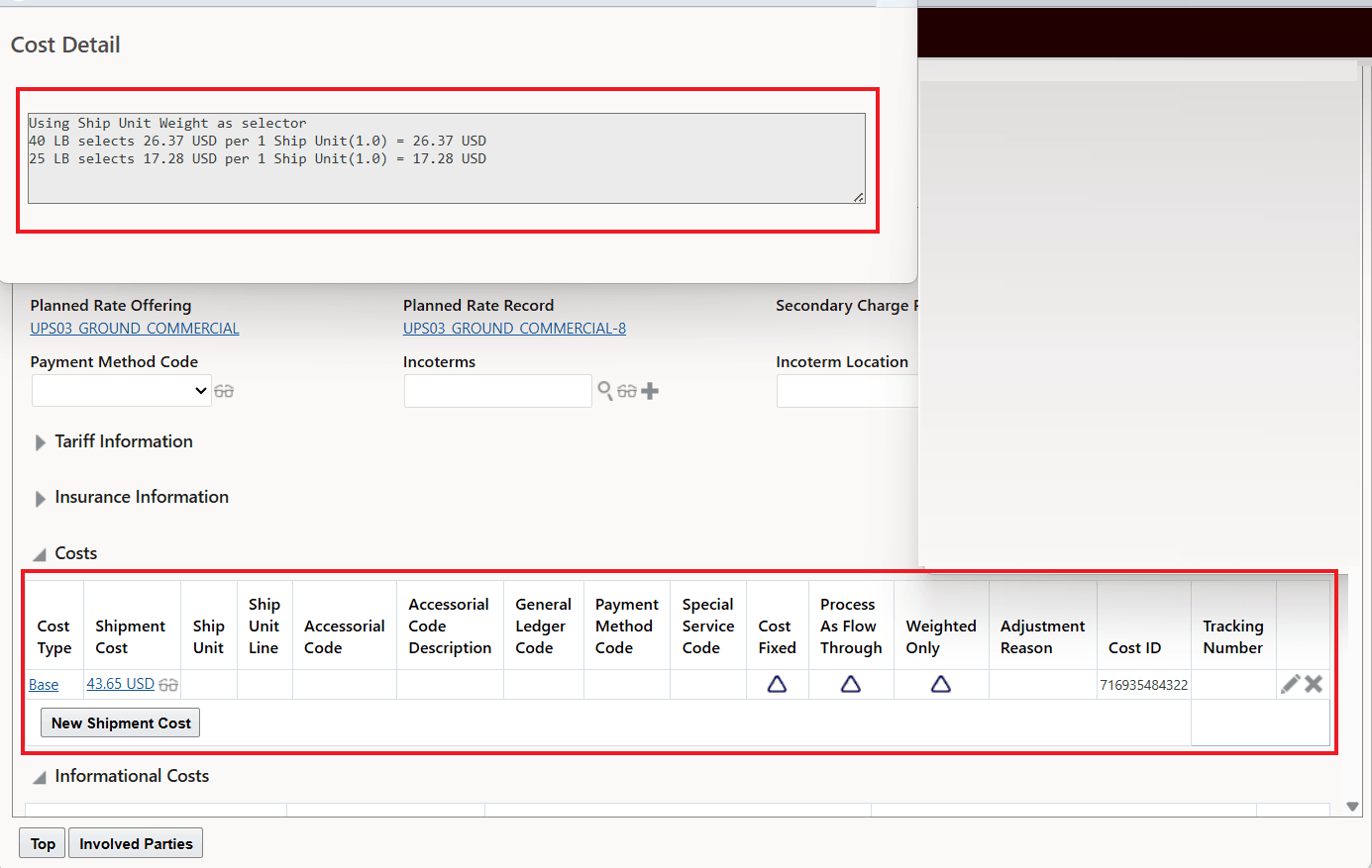

Previously, while the shipment cost was rated correctly, visibility to the ship unit level cost was only available by looking into the Cost Details - as shown below.
Previous Ship Unit Cost Visibility - Cost Detail

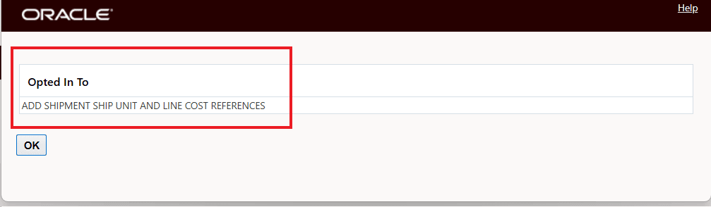

Opt In to Optional Feature

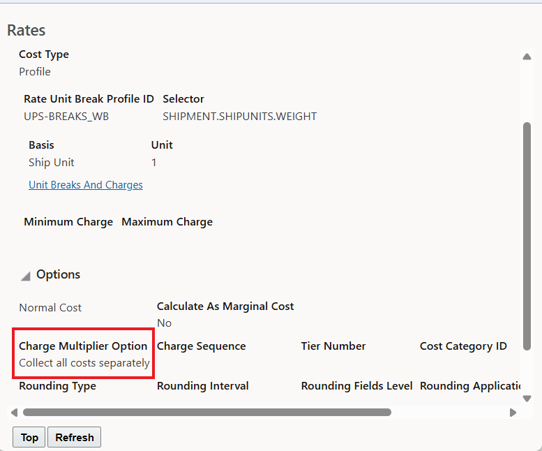

  • On the Rate Record, for shipments rated using RBI based on the Ship Unit, the Charge Multiplier must be set to "Collect All Costs Separately",  the cost calculated for each ship unit is being tagged using the shipment cost reference with qualifier Shipment Cost Qualifier "Shipment Ship Unit" and value as Shipment Ship unit ID.
Rate Change - Collect Costs Separately
