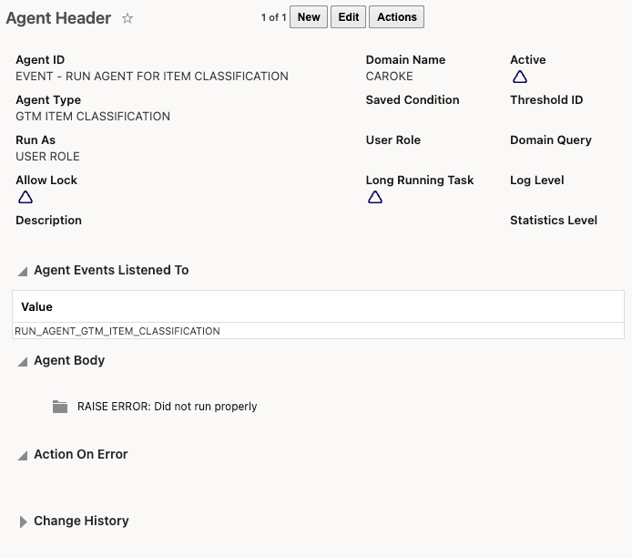

Within an Automation Agent, you can add the RUN_AGENT_GTM_ITEM_CLASSIFICATION action definition as an Agent Event to trigger the automation agent.
Automation Agent with Run Agent as Event
Automation Agent with Action Definition as Event

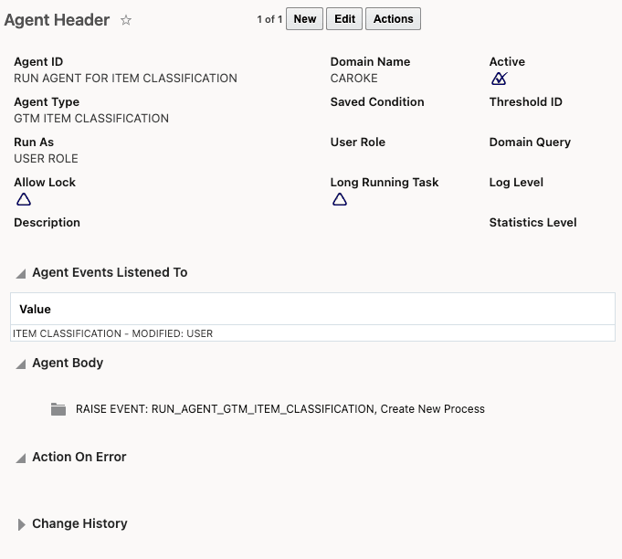

Within an Automation Agent, you can configure the RUN_AGENT_GTM_ITEM_CLASSIFICATION as an Agent Action on the Actions tab.
Automation Agent with Action Definition as Agent Event

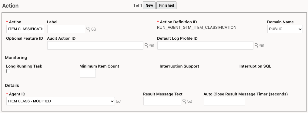

Within the Actions Manager, you can select the Action Definition ID and associate it with an Automation Agent. Once created, you can add the action to a screen set and assign the screen set to the menu.
Action Manager
Action Manager

    To add the action definition as a manual action:
  • Navigate to Configuration and Administration > User Configuration > Actions Manager and create an action with the Action Definition ID RUN_AGENT_GTM_ITEM_CLASSIFICATION.
  • Navigate to Configuration and Administration > User Configuration > Screen Set Manager. On the screen set you are creating or modifying, add the new action on the Actions tab.
  • Navigate to Configuration and Administration > User Configuration > Menu Manager to add the screen set to your menu.
