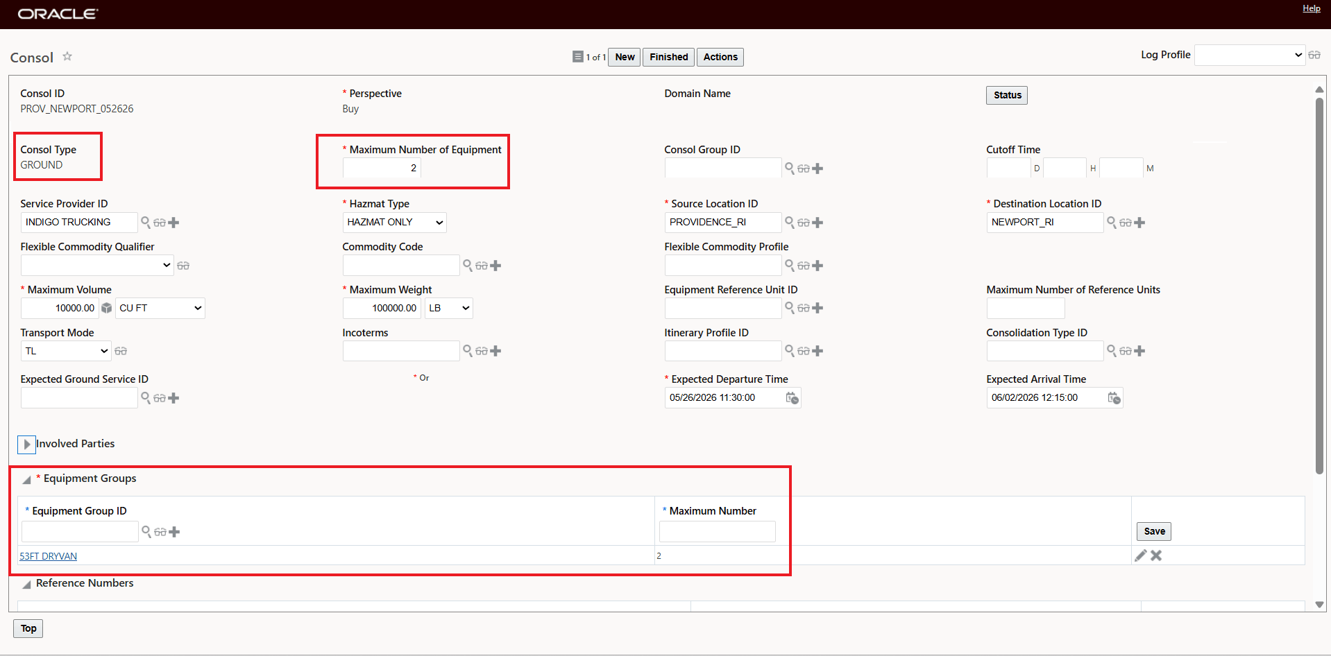

In the example below a Ground Schedule Consol shipment with a capacity of two equipment groups will be used to demonstrate the Packing Fixed functionality.
Ground Consol
Ground Consol

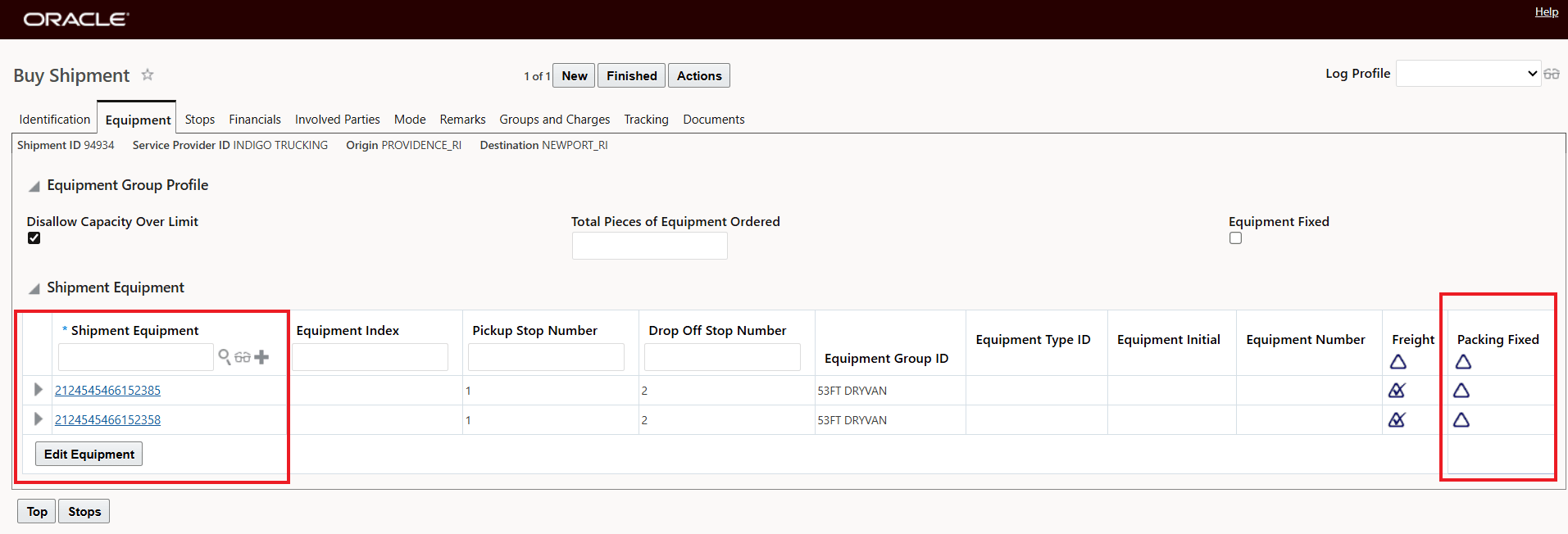

In this example, three orders will be planned onto a Ground Consol Shipment.  The Packing Fixed option will not be selected in this case - the result will be that the three orders will share one of the Shipment Equipments on the shipment, with the remainder of the third order going into the second Shipment Equipment.
Solution Without Packing Fixed

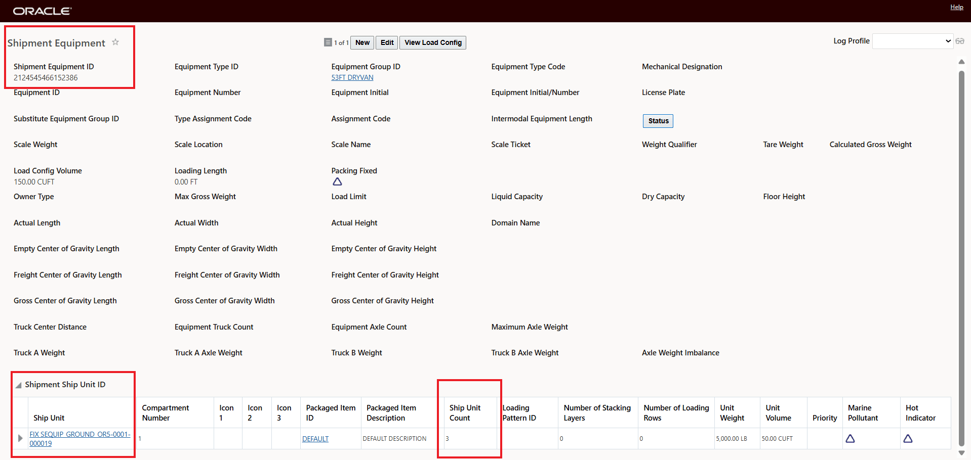

The Shipment Equipment 2124545466152358, has freight loaded from all three orders -  as shown below.
Shipment Equipment With All Three Orders

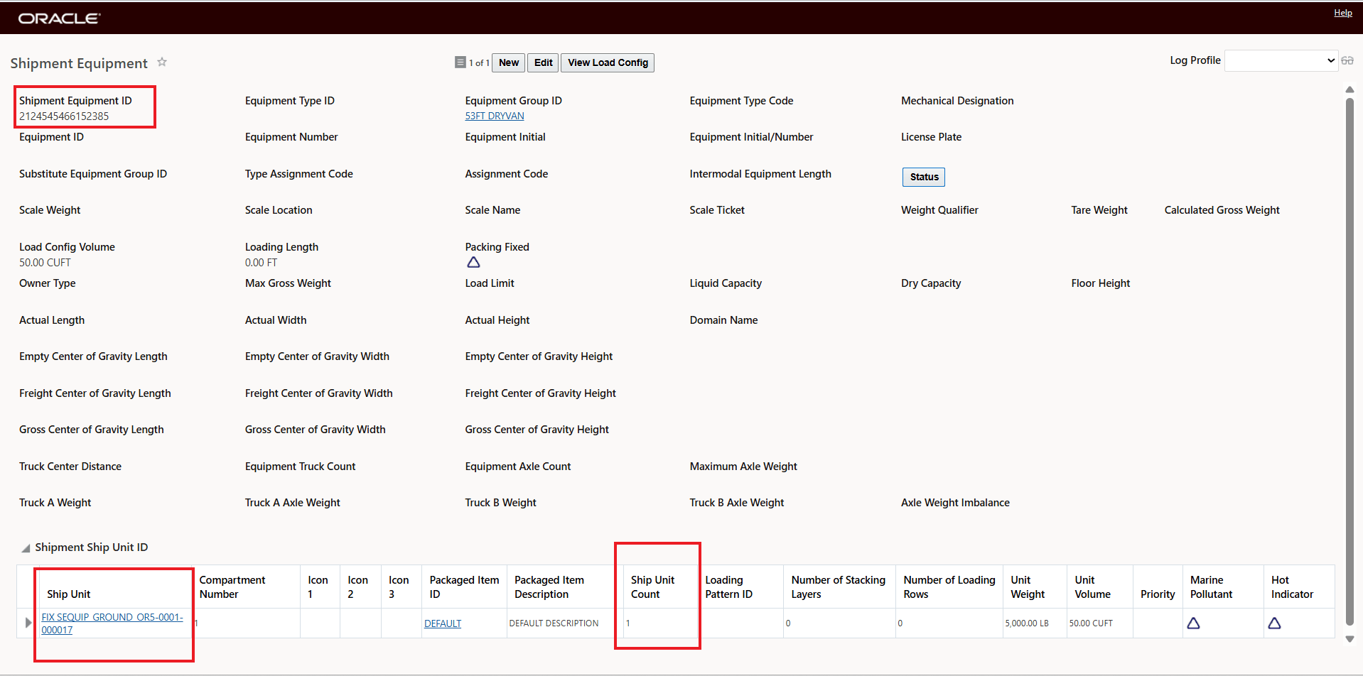

The second Shipment Equipment (2124545466152385) holds the balance of the order FIX SEQUIP_GROUND_OR5 as shown below.
Shipment Equipment With Remainder

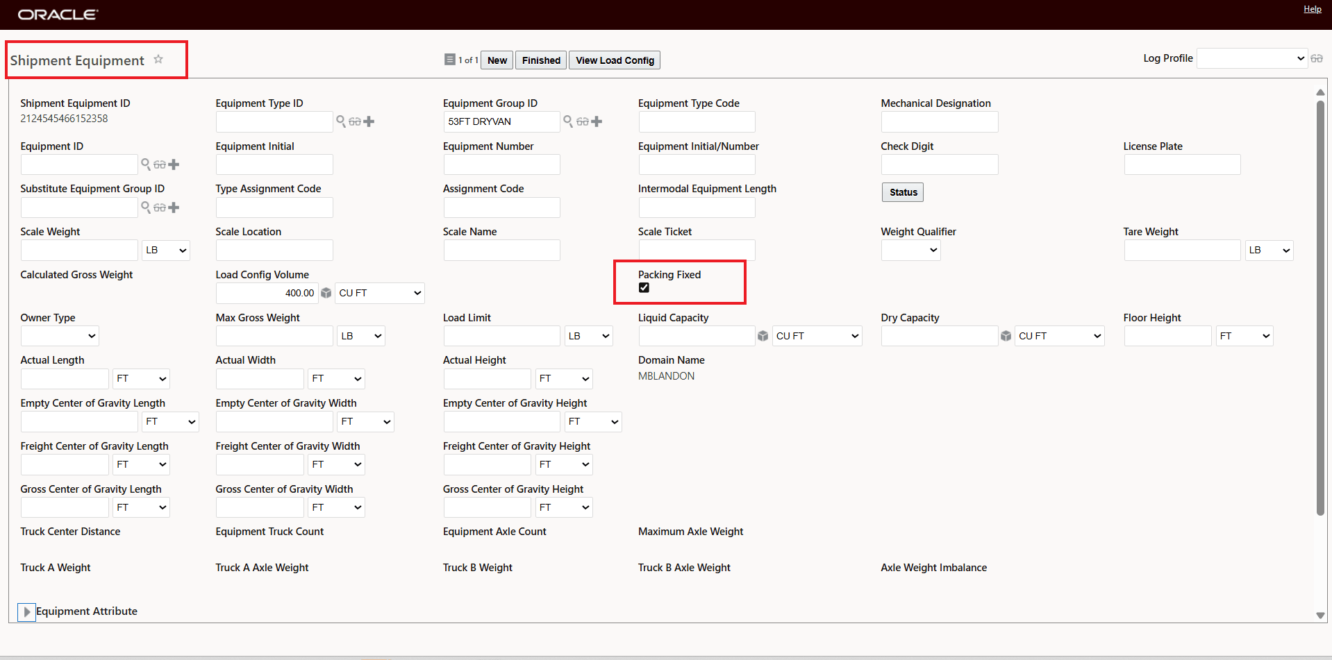

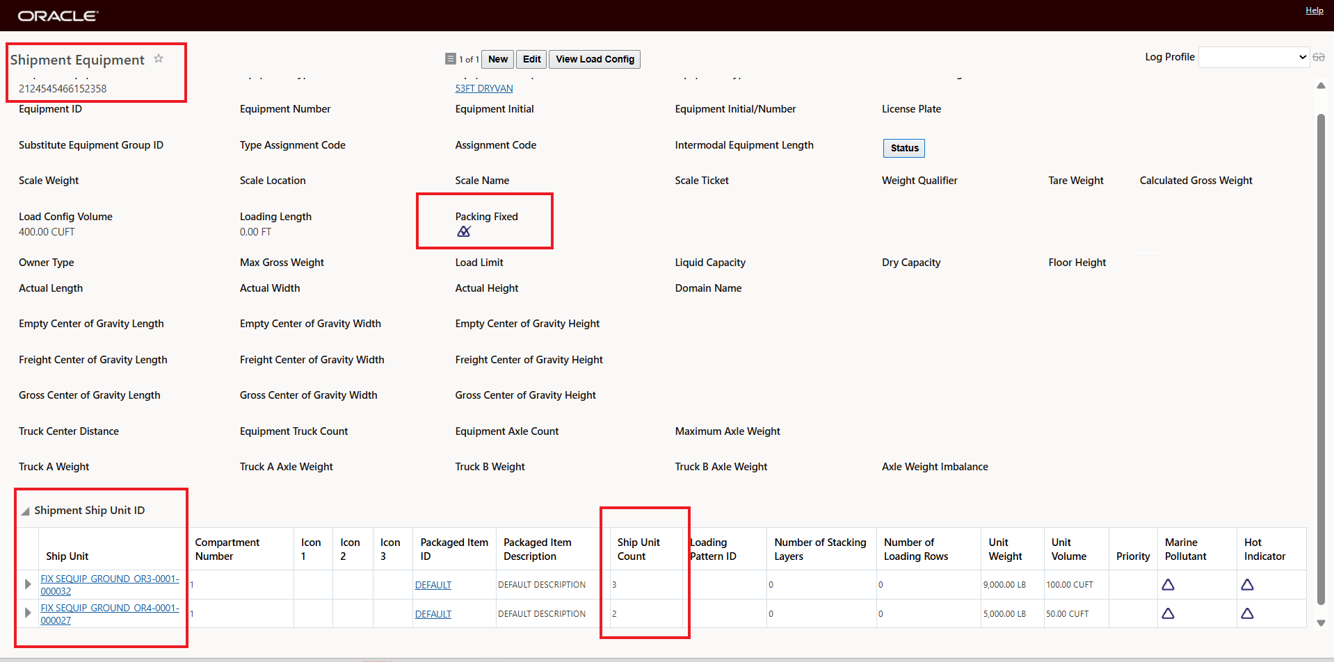

In the example below, the same three orders will be planned, but in this example the first two orders will be planned into one Shipment Equipment that will then have the Packing Fixed flag turned on, when the Packing Fixed option is selected the Shipment Equipment will be fixed from a packing perspective and ship units will not be added or removed.
Shipment Equipment Two Orders - Packing Fixed
With the Packing Fixed option turned on for the Shipment Equipment 2124545466152358, when the third order is planned on to the Ground Consol, the order will no longer be split with one Ship Unit going to the first Shipment Equipment and remainder going to the second Shipment Equipment, with  Packing Fixed the entire order will be planned into the second Shipment Equipment as shown below.
Packing Fixed on Shipment Equipment 2124545466152358

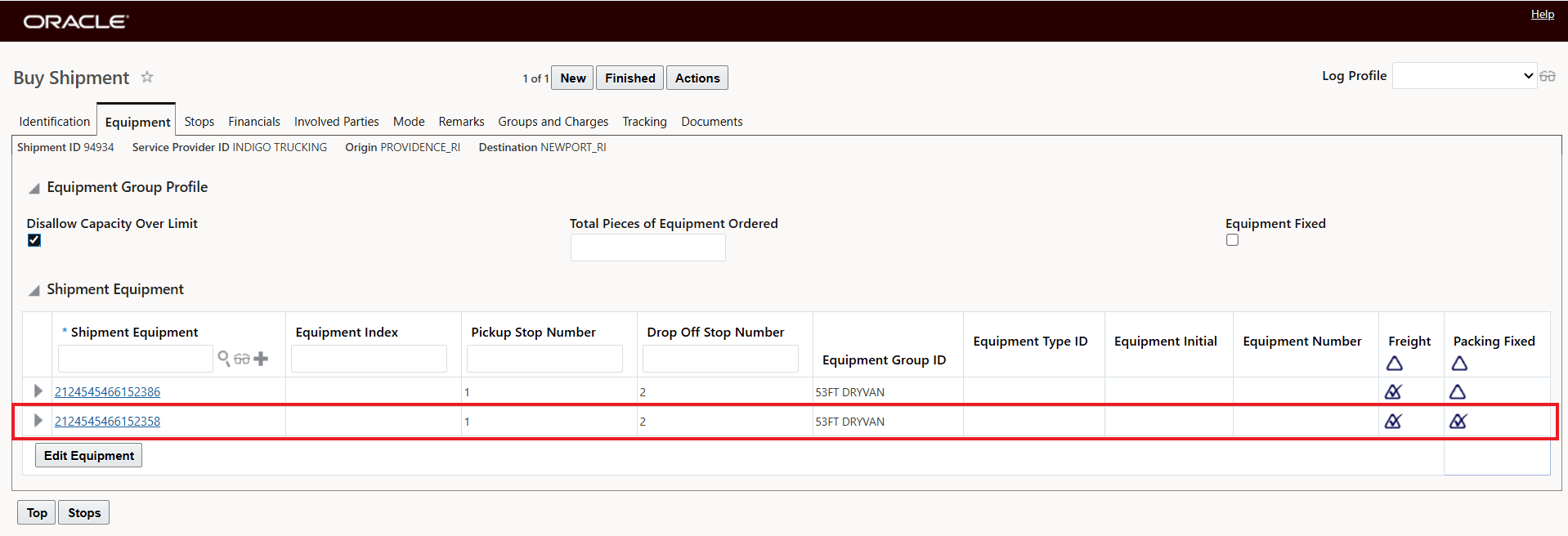

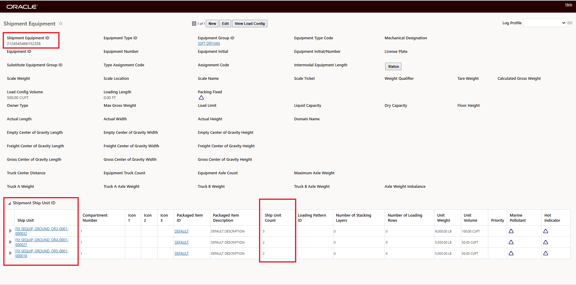

All three Ship Units for the third order release are now loaded into the second Shipment Equipment.
Third Order Ship Units All Loaded In Second Shipment Equipment

The Packing Fixed functionality does not require any steps to enable the functionality - the option is available ready to use for your Ground and FCL Consols. To use Packing Fixed option, you will need to edit the desired Shipment Equipment record and check the Packing Fixed option.
  1. Navigate to the Shipment Manager and open the relevant shipment.
  2. Go to the Equipment tab or access the Shipment Equipment Manager.
  3. Select the equipment you want to fix.
  4. Select the Packing Fixed check box.

Shipment Equipment - Packing Fixed Check Box
