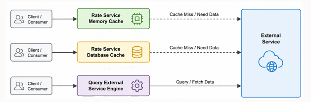

With this feature the application can look up a service time in the app-tier RateServiceCache before calculating it.  For a Rate Service that uses an External Service Engine, OTM can now also check a database cache.   This enhancement introduces database-backed cache persistence to improve reliability and reduce latency.

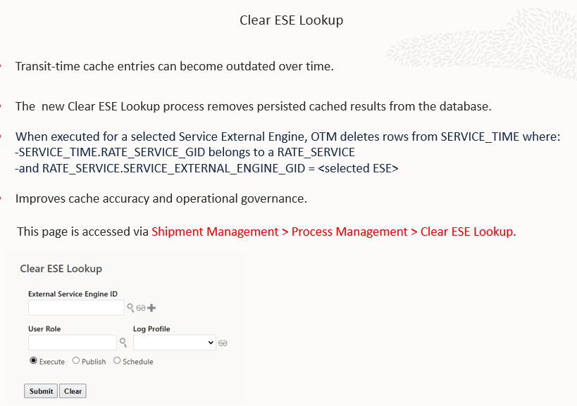

Clearing the Cache
Clear Cache
Clear Cache

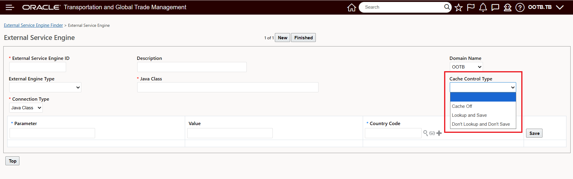

  1. Navigate to the External Service Engine configuration in your system Shipment Management > Power Data > Geography > External Service Engine.
  2. Locate the Cache Control Type field.

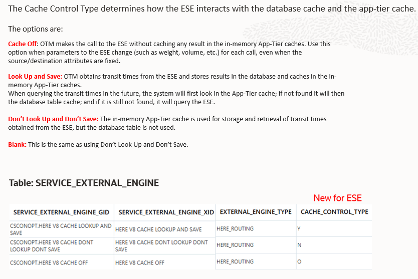

  3. Select one of the following options based on your needs:
    • Lookup and Save (Y): Enables database caching. The system will store and reuse transit times.
    • Don’t Lookup – Don’t Save (N): Disables database caching but still allows temporary in-memory caching.
    • Cache Off (O): Disables all caching. Every request calls the external service.
Cache Control Type
Cache Control Type

  • Choose Lookup and Save (Y) if you want to maximize performance and reduce external calls for frequently used lanes.
  • Use Cache Off (O) if you require real-time, always-fresh transit times from the external service.

  • Clearing the cache removes both stored (database) and in-memory values, forcing the system to retrieve fresh data on the next request.

  • During transition or migration, blank or undefined cache settings default to Don’t Lookup – Don’t Save (N) behavior.
