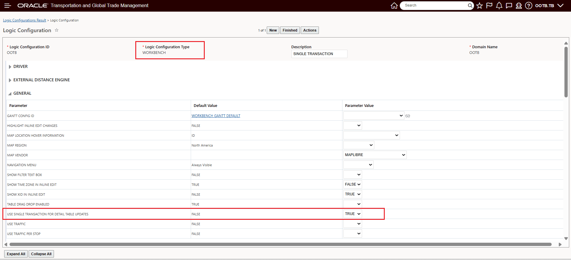

Steps to enable and configure
  1. Navigate to the Logic Configuration Parameters area in your application configuration settings.
    • Shipment Management > Power Data > General > Logic Configuration
    • Master Data > Power Data > Configurations > Logic Configurations
  2. Locate the parameter in the General section:
    • USE SINGLE TRANSACTION FOR DETAIL TABLE UPDATES
  3. Set the parameter based on your preferred processing behavior:
    • TRUE
      New behavior - All edited records are processed in a single transaction.
Use Single Transaction For Detail Table Updates - New Behavior = TRUE
  • FALSE (default)
    Original behavior - Each edited record is processed independently.
Use Single Transaction For Detail Table Updates - Default = FALSE
  1. Save the configuration change.

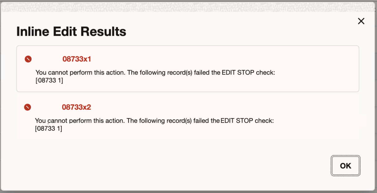

Below is an example of the error message that will be provided in scenarios like Scenario 2 when USE SINGLE TRANSACTION FOR DETAIL TABLE UPDATES = TRUE.
Scenario 2 - USE SINGLE TRANSACTION FOR DETAIL TABLE UPDATES=TRUE - Error Message
