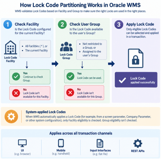

Core logic on honouring the lock code
The core logic of Lock Code Facility and Assign to Groups check is applicable for UI, Mobile, Interface, and API transaction.
Lock Code Facility check:
  • The system should allow the use of lock codes which has:
Facility = * / <Logged-in Facility>
Assign To Groups Check:
The system should fallow the use of only lock codes which are:
  • Not assigned to any group, OR
  • Assigned to the logged-in user's group
The Lock Code Facility Check and Assign to Groups Check will be applicable when the user explicitly applies a lock.
NOTE: The Assign to Groups Check will be applicable when the user explicitly removes a lock during any transaction.

Lock code authorization for UI transactions
Facility and Group-based Lock Code controls are now applied across supported UI transactions for container and inventory locking, receiving, QC Reject, and Create ASN processing.
Lock and Unlock Containers
When adding a Lock Code from IbContainerView > Nbr Locks, ObContainerView > Nbr Locks, or ContainerLockView, the Lock Code list now displays only codes that are:
  • Configured for * or the logged-in Facility.
  • Not assigned to a Group or assigned to the user's logged-in Group/View.

  1. Group check applies only when the Lock Code is explicitly selected/applied/removed by the user.
Facility eligibility >> Lock Facility = * OR Lock Facility = transaction/logged-in Facility
AND
Group eligibility >> No groups assigned to Lock Code OR user's group is assigned to Lock Code

  1. UI Lock Code selection automatically validates:
    • Facility > * or logged-in Facility.
    • Group > no assignment or user's Group is assigned.

  3. Explicitly selected Lock Codes > Facility + Group validation.
  4. Automatically applied Lock Codes > Facility only; Group assignment is ignored.

  6. The same key rule applies to APIs: explicit lock application/removal >  Facility + Group check; automatically inherited/configured lock > Facility check only.
