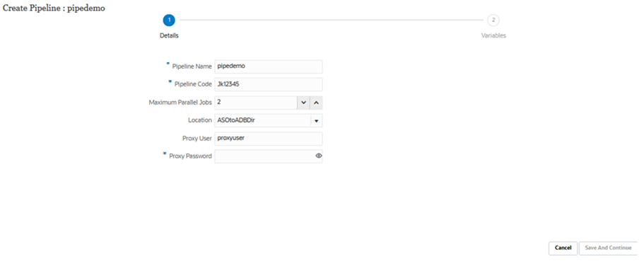

To create a proxy server user credential, an administrator with a service administrator role (can grant user roles), specifies a proxy admin username on the Create Pipeline page. If the proxy user name is different than the service administrator's username, then the system prompts the user to enter a password.
If the user executing a job is a non-administrator and no proxy admin user credentials are specified, the system executes all jobs as non-administrator users. In this case, the Pipeline can only include jobs that do not require a service administrator to execute them, for example an integration job. If jobs require an service administrative to execute them and a non-administrator without a proxy administrator user credentials attempts to execute them, then the Pipeline process fails.
The new proxy administrator user credential options are shown below:
Image Shows The Create Pipeline Page
