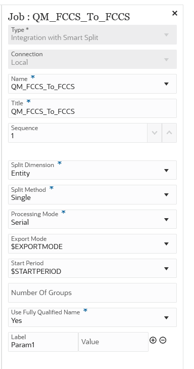

To use the Smart Split feature, you create a base integration definition with the data to be loaded from the source application. Then you use the new Integration with Smart Split job type in the Pipeline to specify the integration name, Split dimension, Import and Export modes, Start and End periods, and Split method.

In the following example, the Split Dimension has been placed on the “Entity” dimension in the source application. The Split method is “Single” and instructs the system to run a separate process for each member in the dimension.
Image shows the Integration with Smart Split job type in the Pipeline
