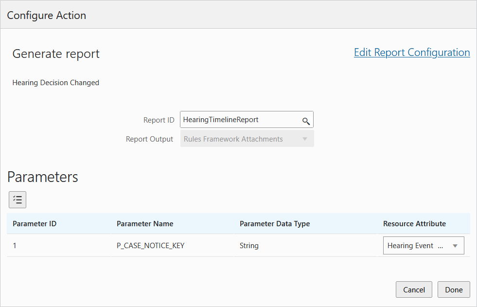

Use the Configure Action page to select the report you want your business rule to generate and to map resource attributes to report parameters.
Configure Action Page

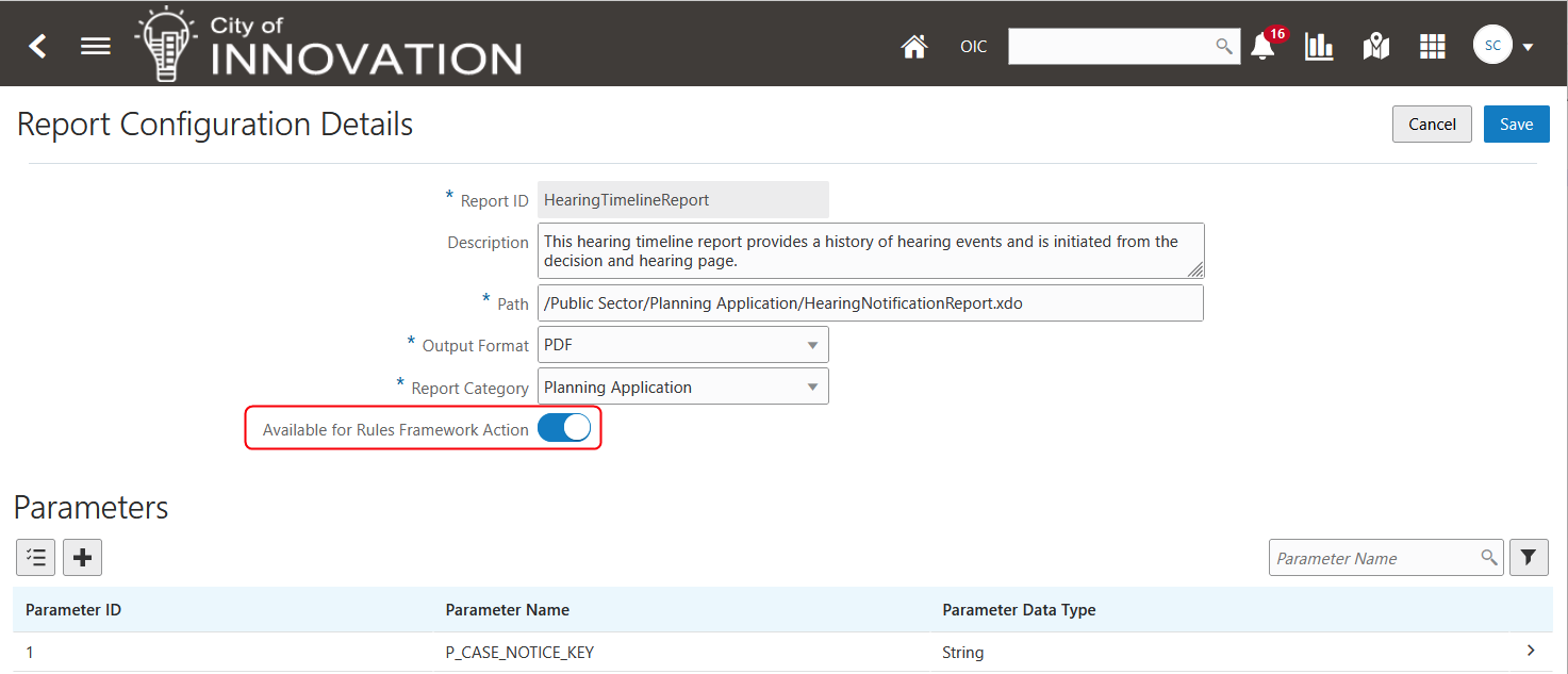

You define your reports as usual using the Reports Configuration Details page. For reports that you want to make available for the Business Rule Framework to generate, turn on the 'Available for Rules Framework Action' switch.
Report Configuration Details Page

- Navigate to Business Rules Framework > Planning and Zoning > Hearing Decision Changed.
- Select Action, Generate Report.
- Click Configure.
- Select the HearingTimelineReport for the Report ID.
- Map the Resource Details to the Report Parameters and save.
- Navigate to Common Setup > Report Configuration.
- Select HearingTimelineReport.
- Enable 'Available for Rules Framework Action' and save.
