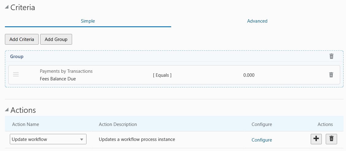

Business Rule Details Page
You can use the Business Rules Framework to set up a rule for automatic workflow updates when transaction fees are paid.
Steps to Enable
To enable this feature:
  1. Open the Common category on the Business Rules Framework landing page.
  1. Add a rule to the Payment Received by Transactions event to trigger the action to Update Workflow.
  1. Update the workflow process model to identify the human task using Custom Properties. This task should be the same as what's configured in the Business Rules Framework Update Workflow action.
Tips And Considerations
The Update Workflow action is enabled for the Payment Received by Transactions event. You should ensure that the corresponding business rules and criteria are properly configured to support this automation. To check that all fees have been paid prior to advancing the workflow task, use the Fees Balance Due attribute in the criteria.
