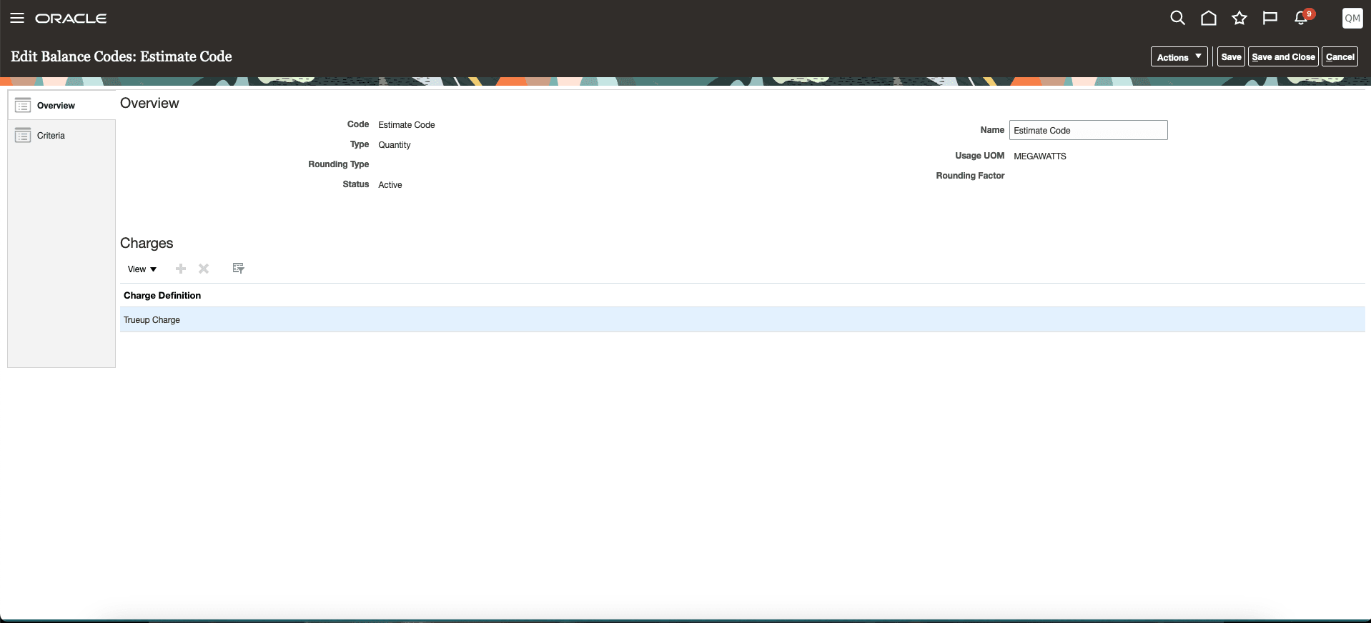

Balance Code
Balance Code

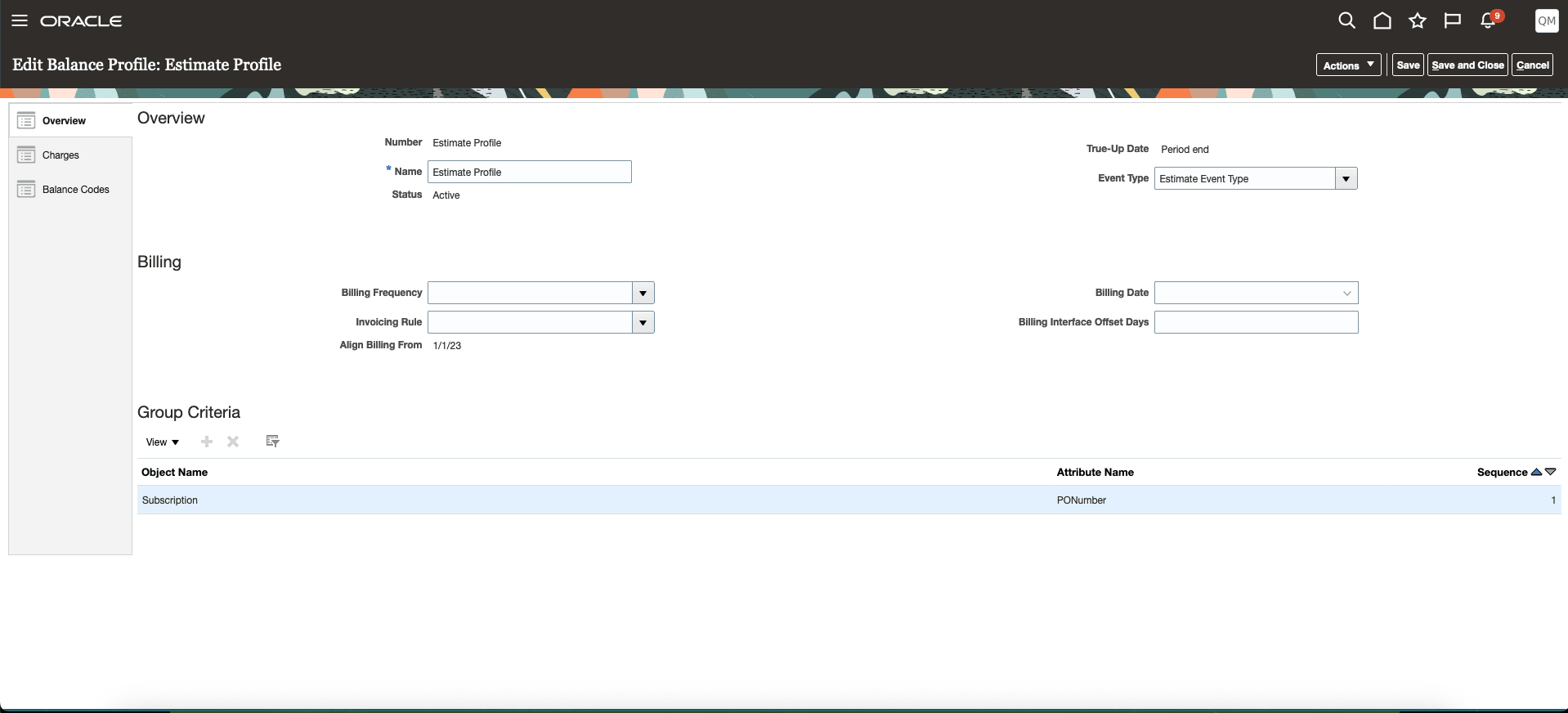

Balance Profile
Balance Profile
Balance Profile
Balance Profile
Balance Profile
Balance Profile

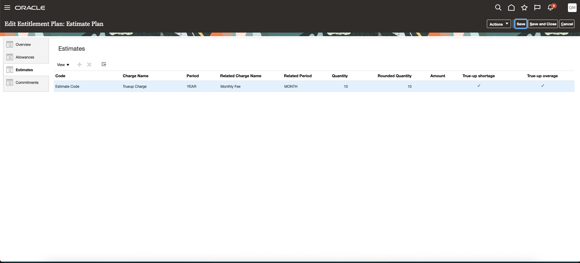

Entitlement Plan
Entitlement Plan

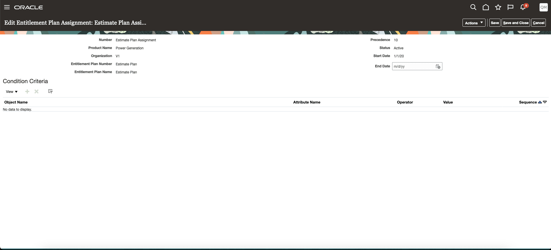

Entitlement Plan Assignment

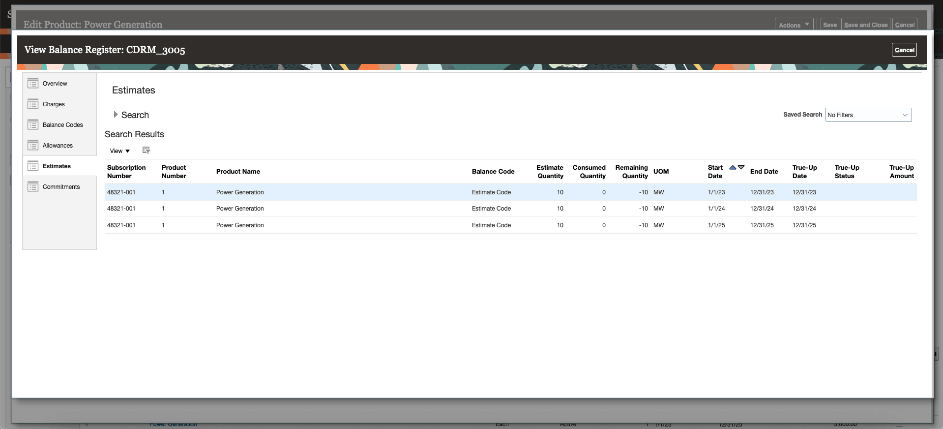

Estimate Register
Estimate Register
1. Allows tracking of quantity and amount based estimates or commitments in a balance register and true-up only for shortages, overages, or both in case of estimates.

1. We have introduced the true-up period (Period end / Offset) at the balance profile level along with Event Type. This needs to be set for both estimate or commitment model.

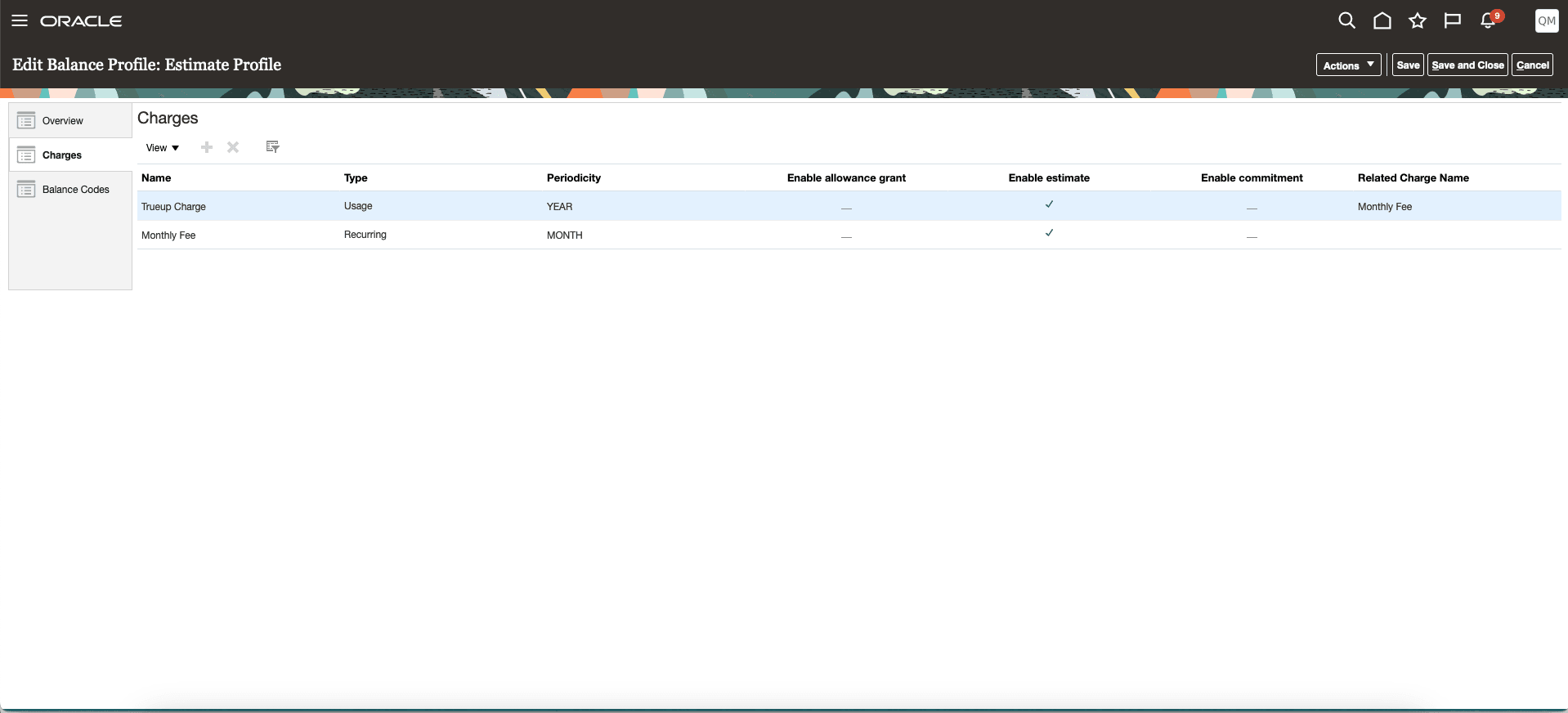

2. In the charges section under balance profile, you need to select either of allowance grant, estimate or commitment. A usage charge can be setup for one of these values. You can use recurring charge as a related charge to grant either estimate, allowance or commitment.
3. In the entitlement plan under estimate section, you can select either true-up shortage or true-up overage or both. In case of only shortage system will generate a negative invoice for the shortage quantity (overage is not billed). In case of only overage system will generate a positive invoice for the overage quantity (shortage is not billed). In case of both system will generate both negative and positive invoice.

6. In the entitlement plan under commitment section, you can setup the committed quantity or amount. At the end of the true-up period system will always bill the committed quantity or amount if its less than the setup values.
