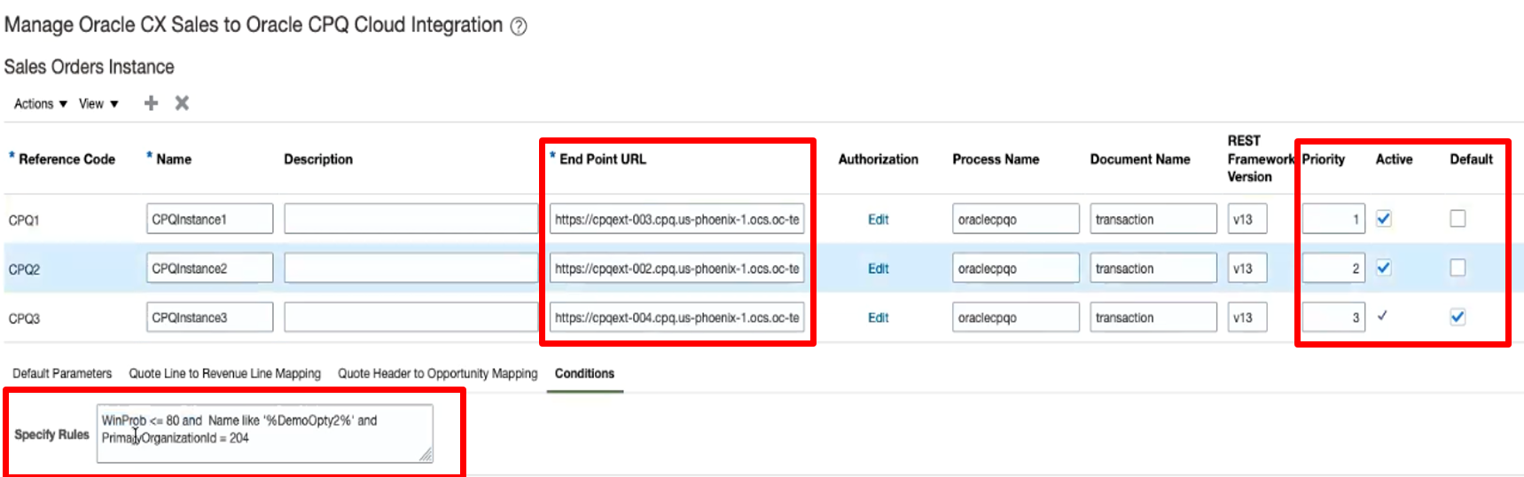

  1. Define CPQ processes by specifying the End Point URL, Process Name, Document Name and set Authorization.
  2. Set the multiple CPQ processes to be Active at the same time with a Priority value while mark one process to be the "Default".
  3. Specify Condition Rules for each CPQ process. Rules can be written only on Opportunity attributes that are queryable and no support available for other objects. In other words the multi process is used ONLY for opportunity quotes. Examples opportunity attributes include Business Unit associated with the opportunity, the revenue amount, close date, win probability or custom attributes.
  4. Make sure opportunity standard / custom attributes are set to searchable in Application Composer to be able to participate in Condition Rules.
Notes:
  1. There is always one CPQ process that is set as the “Default”. If rules are not setup or rules that are set up are incorrect and system cannot resolve to a specific process, then it will use the process specified as the default for quoting.
  2. There is a priority mechanism in case of CPQ processes where conflicting rules have been setup and the lower numbered process is considered of higher priority.
  3.  The system will evaluate "Conditions" for each CPQ  process based on priority order, to compare against current opportunity for which the Quote is being processed.
