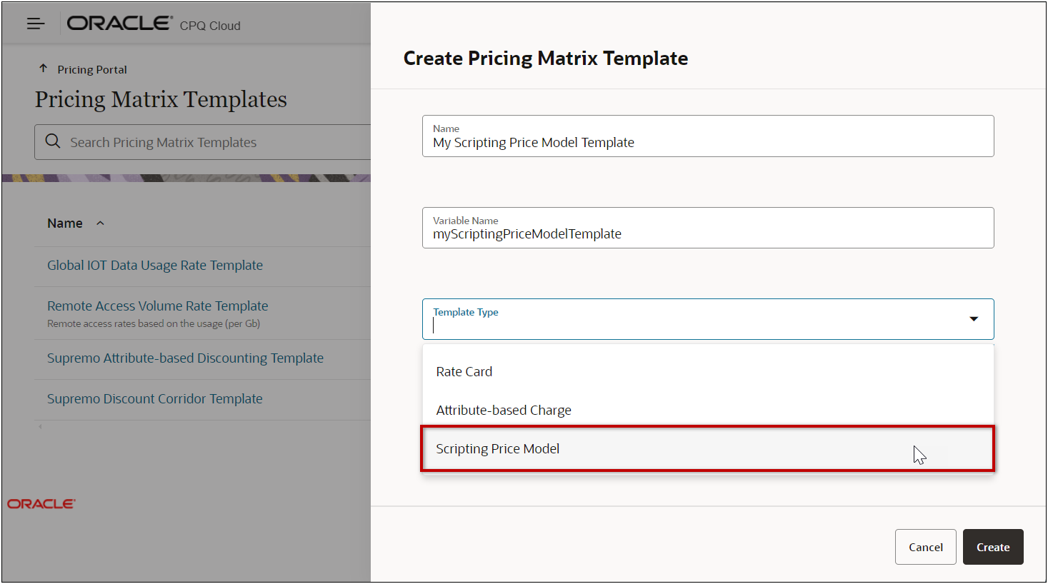

Create a Scripting Price Model - Pricing Matrix Template
Complete the following steps to create a Scripting Price Model type Pricing Matrix Template in the CPQ Pricing Portal.
  1. Navigate to Admin > Pricing Portal > Pricing Matrix Templates.
  2. Select Add from the Actions drop-down.
  3. Enter the Name.
  4. Enter the Variable Name.
  5. Select Scripting Price Model from the Template Type drop-down.
  6. (optional) Enter a Description.
  7. Click Create.
  8. Select Add from the Actions drop-down.
  9. Enter the following data to create a template column.
    1. Enter the Name.
    2. Enter the Variable Name.
    3. Select the Data Type.
    4. If applicable select a Lookup. (Lookups are only available for String Data Types)
    5. If applicable, enter of select a Default Value.
    6. Check Default Value Overridable if the default value can be modified.
    7. Check Required to make this field mandatory.
    8. Check Key to identify this field as a unique identifier.
    9. Repeat this step to enter additional columns.
Example Scripting Price Model - Pricing Matrix Template

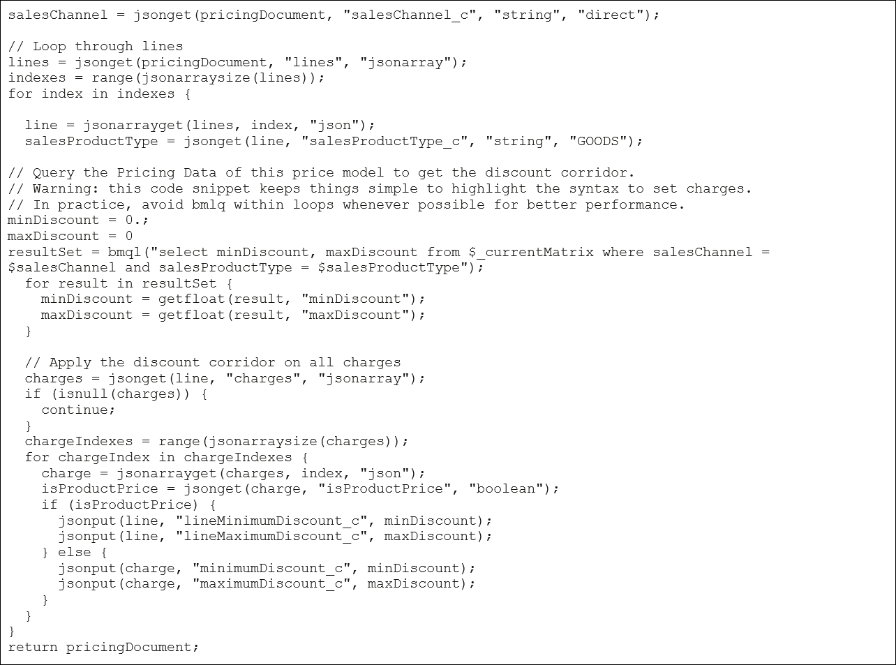

  1. Enter BML Script for the Scripting Price Model - Pricing Matrix Template.
    1. Click Edit (In the Basic Details section).
    2. Expand More Details, and click the Advanced Script Edit link.
    3. Select the applicable attributes for the Pricing Document Attributes tab, For example,
      • _currencyCode
      • salesChannel_c
      • lineMaximumDiscount_c
      • lineMinimumDiscount_c
      • salesProductType_c
      • calculationInfo
      • chargeDefinitionCode
      • chargeType
      • dynamicPricingType
      • maximumDiscount_c
      • minimumDiscount_c
      • pricePeriod
      • priceType
      • priceType
    4. Select _currentMatrix from the Special Parameters tab.
    5. Click Next.
    6. Enter the BML Script. See BML Script Example
    7. Click Save and Close.
  2. Click Update.
BML Script Example
BML Script Example

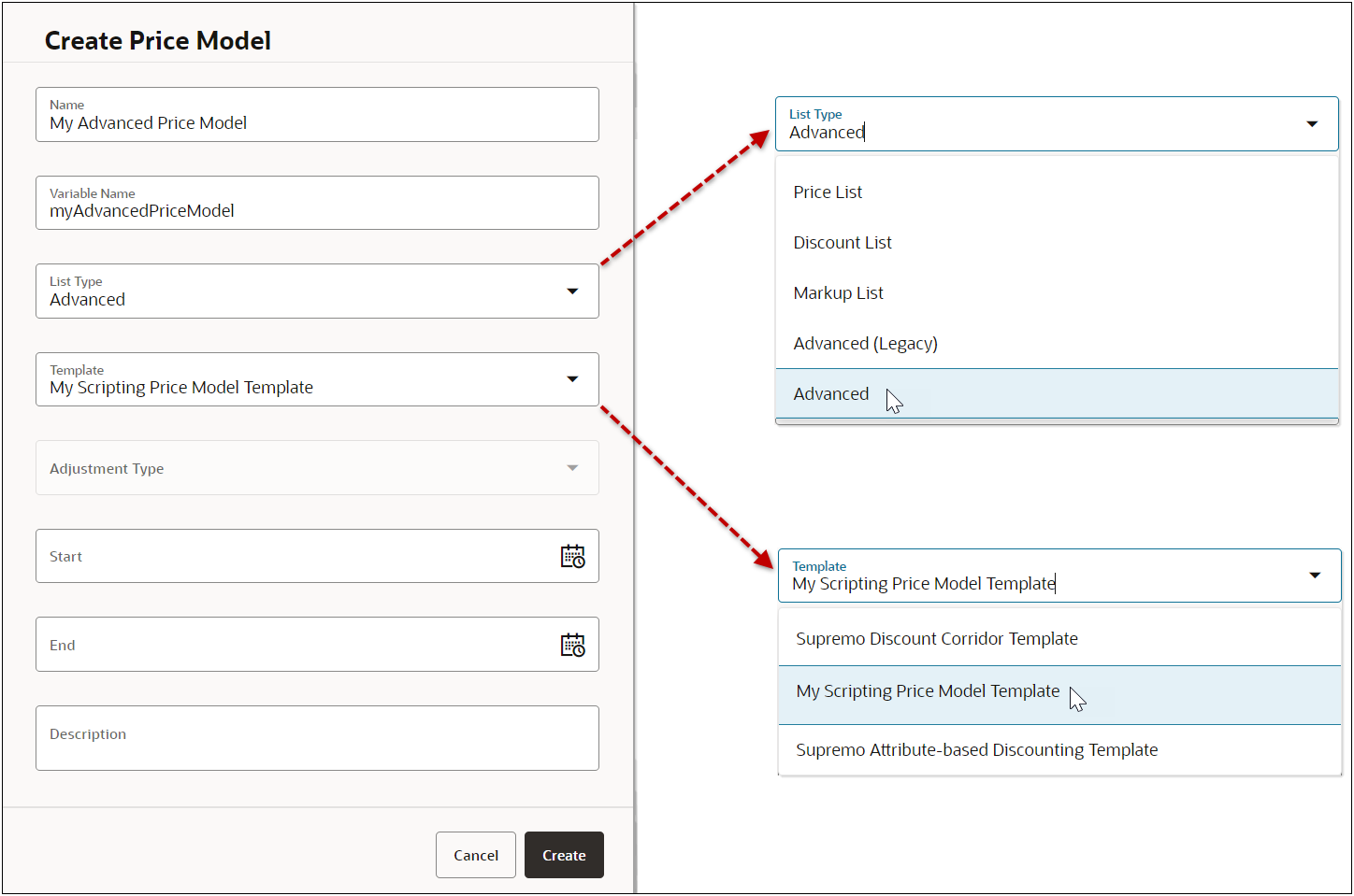

Create an Advanced Price Model
Complete the following steps to create an Advanced Price Model in the CPQ Pricing Portal.
  1. Navigate to Admin > Pricing Portal > Price Models.
  3. Enter the Name.
  5. Select Advanced from the List Type drop-down.
  6. Select the applicable Scripting Price Model - Pricing Matrix Template from the Template drop-down.
  7. (optional) Select a Start date. This effective start date value will apply to all child Price Model Items.
  8. (optional) Select an End date. This effective end date value will apply to all child Price Model Items.
  9. (optional) Enter a Description.
  10. Click Create.

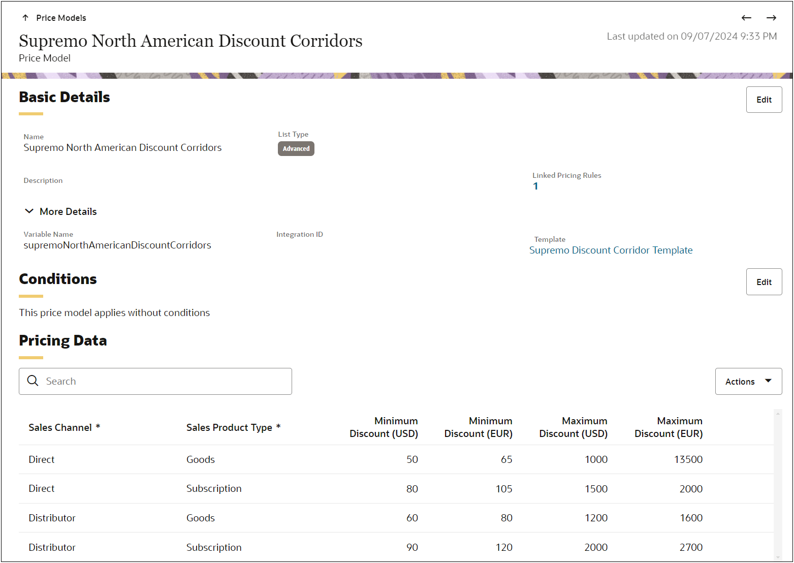

  11. Select Edit from the Actions drop-down.
  12. Click Add, and then define the values for the row. See Advanced Price Model Example
  1. Select values from available drop-downs and define the appropriate data values for the row.
  2. Repeat this step to enter additional rows.
  1. Click Update.
Example Advanced Price Model
