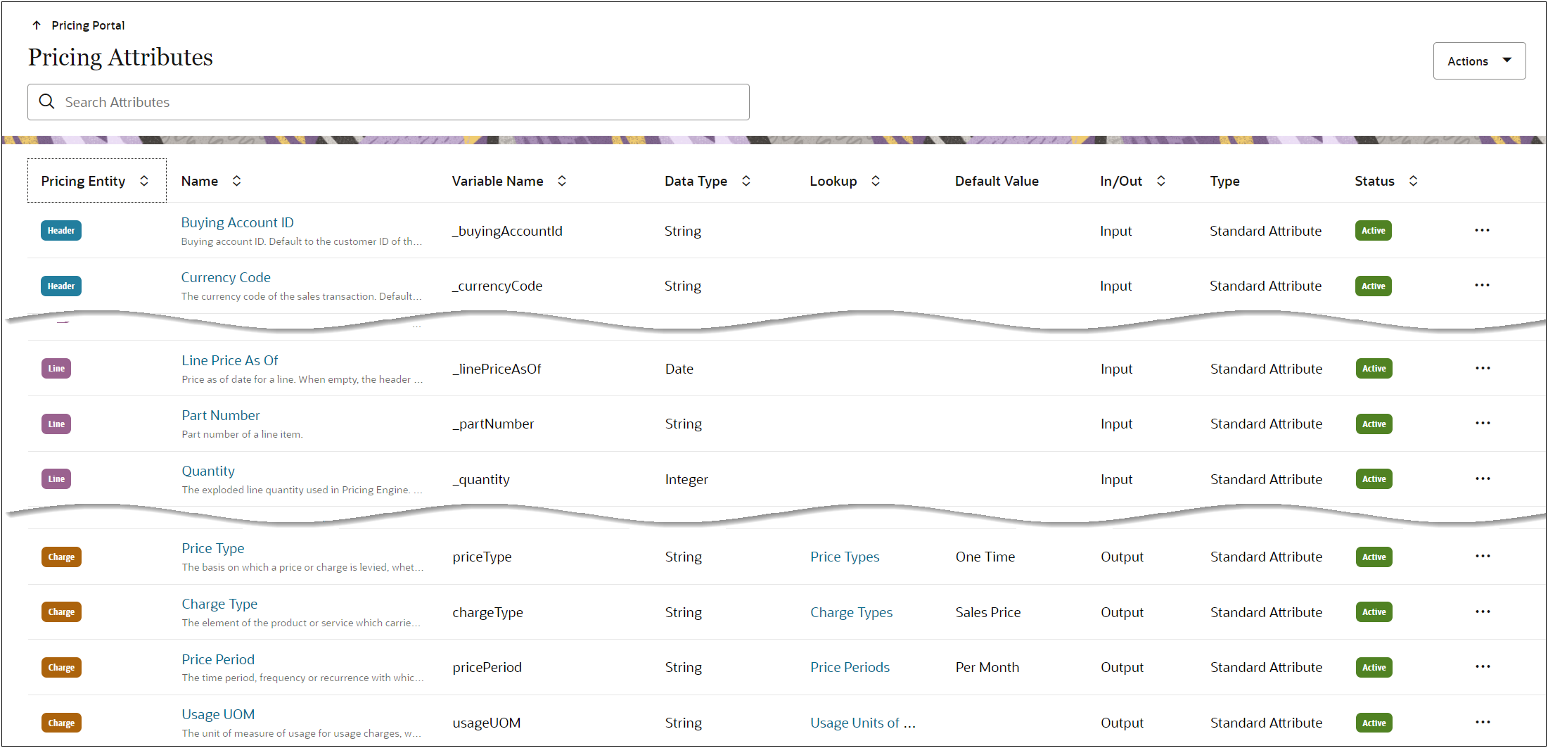

Beginning in Oracle CPQ 24D, the Pricing Portal combines Charge Attributes with Pricing Attributes into a single Pricing Portal card. Text Area type Charge Attributes can be mapped to Commerce Text and Text Area type attributes. Note: mapping a Text Area type Charge Attribute to a Commerce Text attribute may cause truncated data. The "Charge" type Pricing Entity identifies Charge Attributes inside the Pricing Attributes module. The Pricing Attributes module supports all previous Charge Attribute fields and functionality.
Pricing Attributes

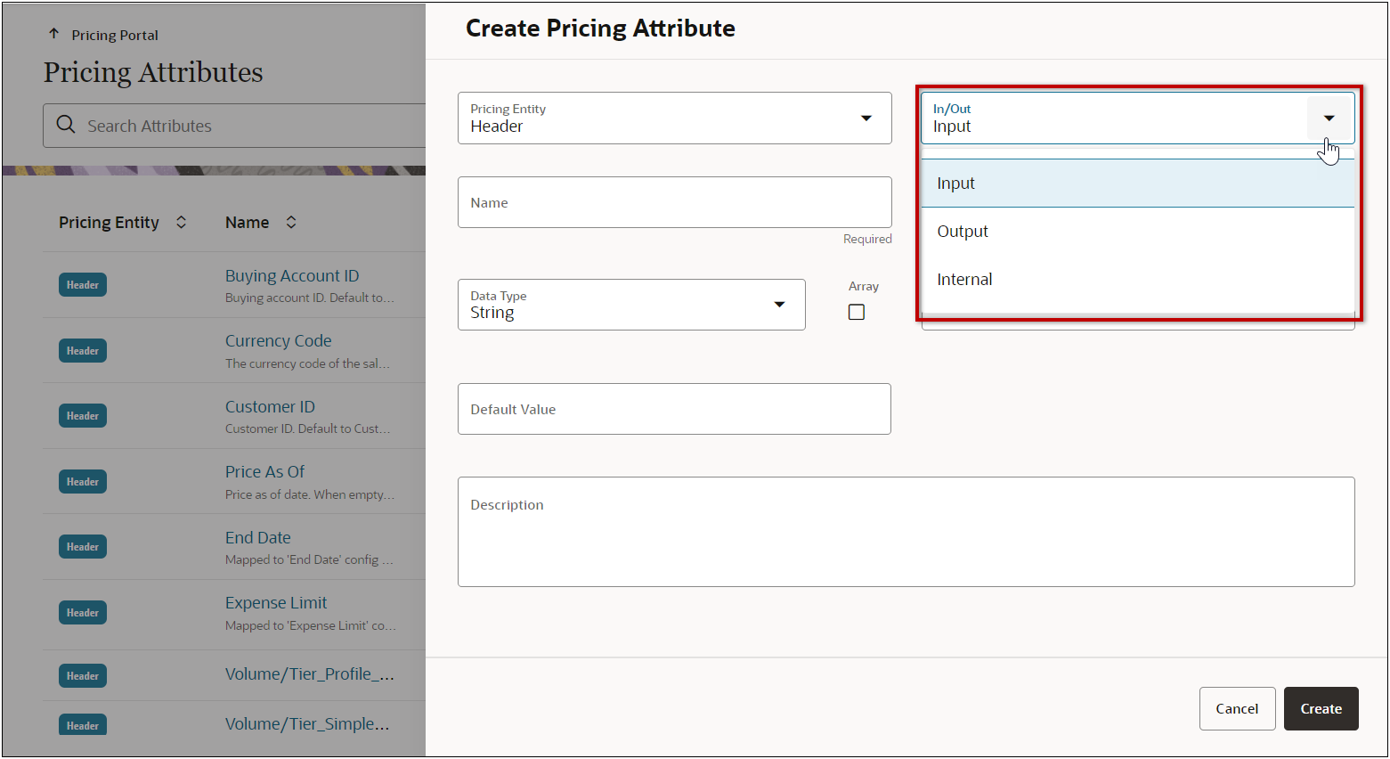

Additionally, the new In/Out parameter for Pricing and Charge Attributes identifies if an attribute is a Pricing Engine input, output, internal, or external. Each Pricing Attribute can have only one of the following values:
  • Input – This option defines attribute values that are used as inputs to pricing calculations.
  • Output – This option defines attribute values that will be written as outputs from pricing into Commerce.
  • Internal  - This option defines attributes that are used only inside the Pricing Engine.
  • External – This value is automatically set for Charge Set Attributes that are currently calculated by CPQ Quoting but will in future be calculated by Pricing Engine. For now these attributes form part of the schema definition for Charge Set attributes in CPQ Commerce. This value cannot be selected when created new custom Pricing Attributes.
The In/Out parameter can be set to Input, Output, or Internal for new custom Pricing Attributes. Charge Attributes are automatically set to Output.
Select In/Out value
