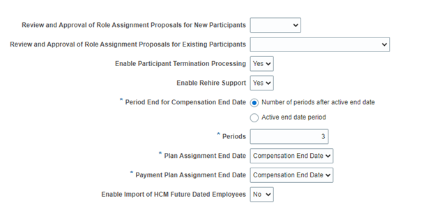

  1. Navigate to Setup and Maintenance.
  2. Under Sales, select the Incentives functional area.
  3. Search for and open the Manage Parameters task.
  4. Under the Participant Parameters section, set Enable Rehire Support to Yes. (Note: this option will only be visible if you have enable terminations)
Manage Parameters
Manage Parameters
