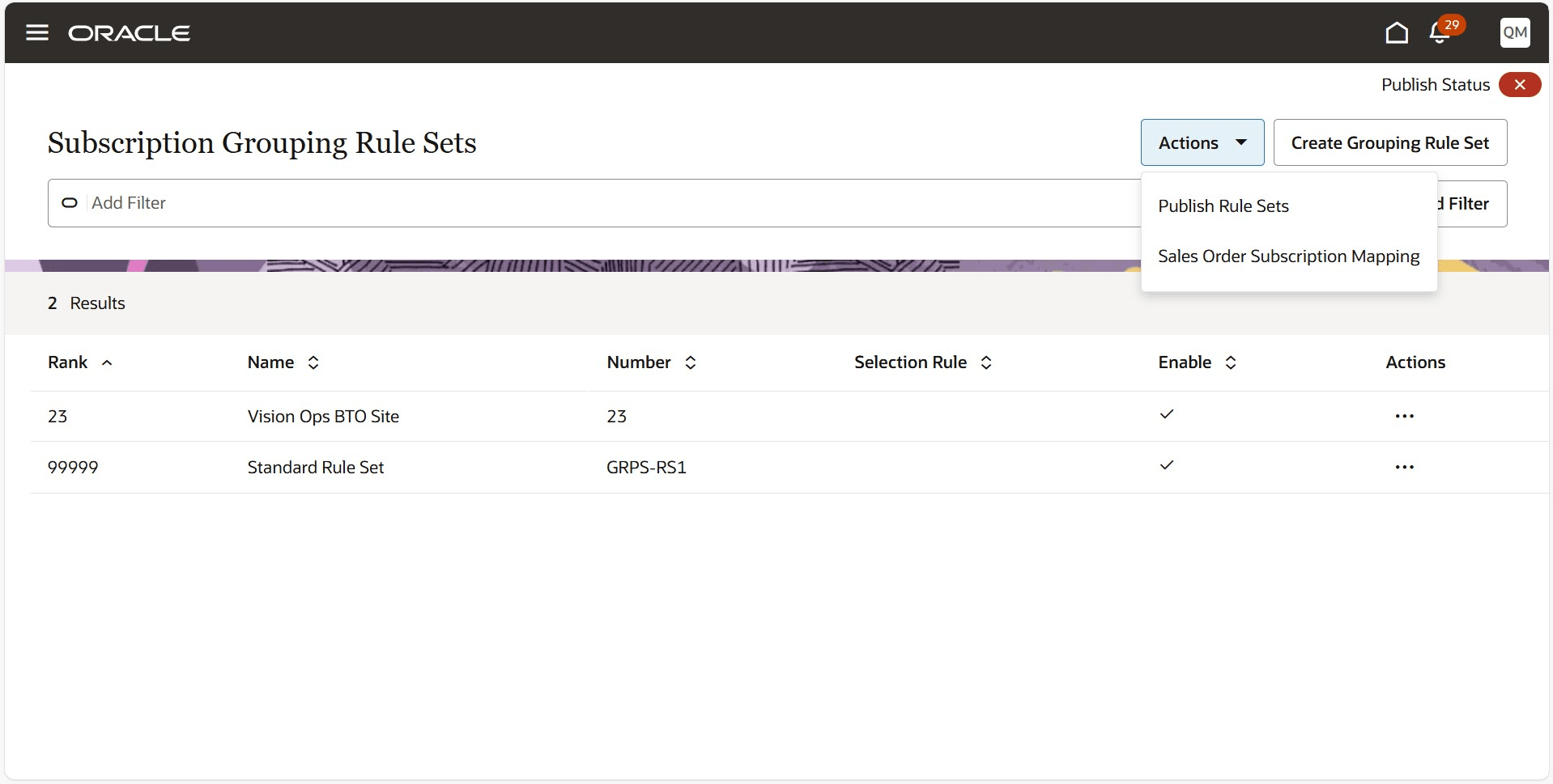

Subscription Grouping Rule Set Listing
A Grouping rule set allows you to define rules to group subscription products from an upstream application into an existing subscription header or a new subscription header.

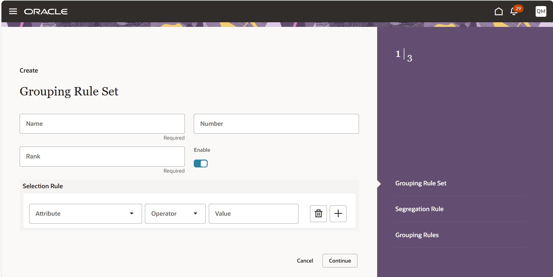

Every grouping rule set has a name, number and rank. The rank defines the order in which the grouping rule sets are evaluated for applying to an incoming subscription product line. A grouping rule set can be enabled or disabled. However, the grouping rule set has to be published before it can be used. The Publish Rule Sets action is used to publish the grouping rule sets.
A lower ranked grouping rule set is evaluated first. A grouping rule set is identified by matching the selecting rule criteria to the incoming subscription data.
Grouping Rule Set
Grouping Rule Set

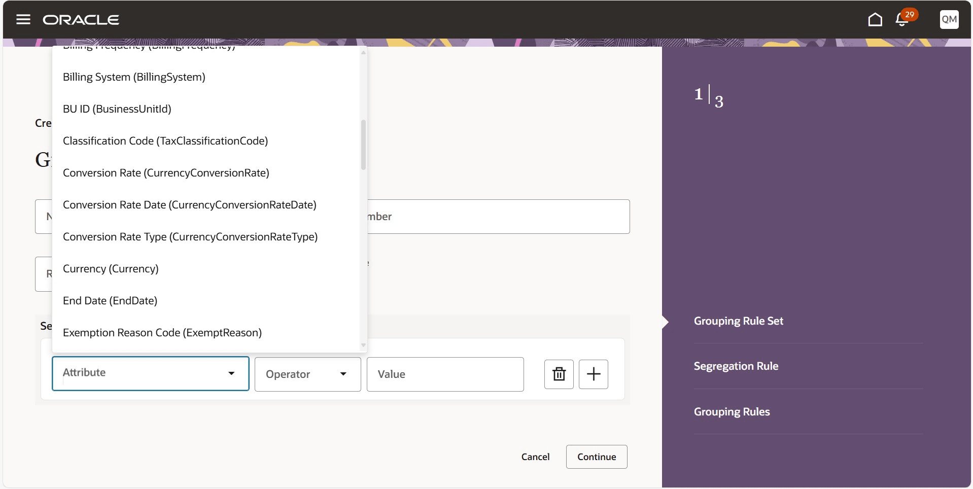

The selection rule identifies which of the grouping rule set will be used for processing the incoming subscription. The selection rule can be created based on the attributes of the subscription header. The selection rule can help you segregate the rule sets by business units for example.
Selection Rule
Selection Rule

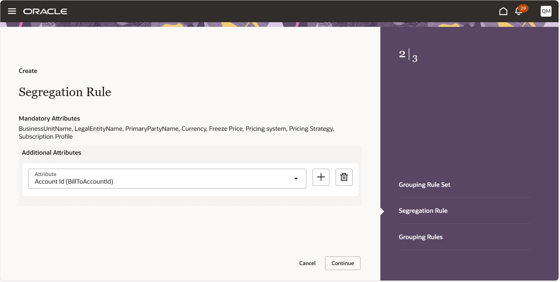

The Segregation rule identifies the subscription products from the incoming transactions that have to me mandatorily created under a separate subscription header. In effect, the attributes from both subscription header and products which you think cannot have different values within a subscription header, must be identified as a segregation attribute. There are some mandatory segregation attributes which cannot be overridden.
Segregation Rule
Segregation Rule

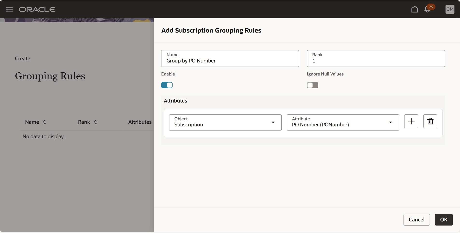

The grouping rule determines the rules that will actually be applied to group the incoming order lines into a subscription header. The grouping rules can be ranked, and the rules will be processed in the order of increasing rank. Duplicate ranks are not allowed. The grouping rule can be created using attributes of subscription header and subscription products.
Grouping Rule
You can add as many grouping rules are required. If a grouping rule attribute is common across all the grouping rules, then it can be added in the Segregation rule.
Grouping Rule
Multiple Grouping Rules in a Grouping Rule Set
Once the grouping rules are created then the Grouping Rule Set has to be published for it to be usable.
Publishing Grouping Rule Set

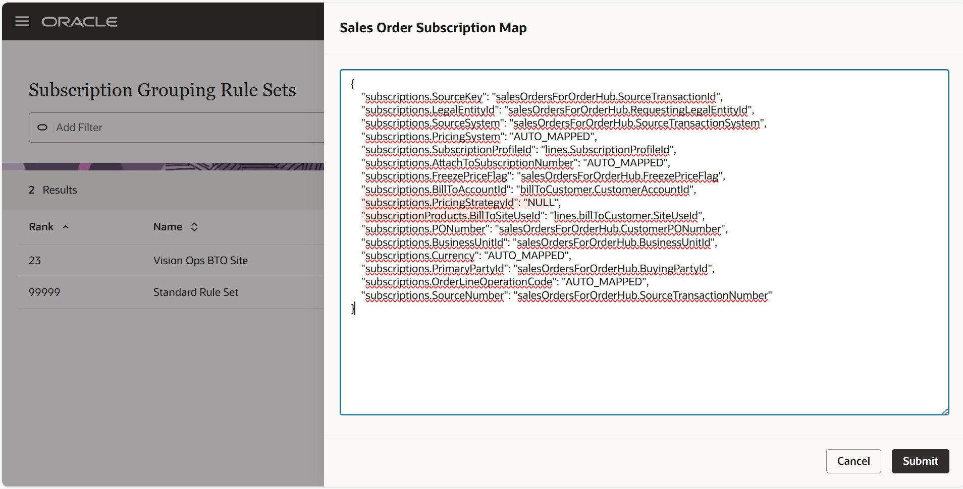

The attributes of the sales order that are used for the selection rule, segregation rule and grouping rule can be mapped from Order attributes to the Subscription attributes using the Sales Order Subscription Mapping. The standard attributes are already mapped.
