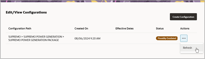

Refresh a Configuration
Complete the following steps to refresh a configuration.
Navigate to Admin > Products > Product Workbench.
Click on the BOM product Actions ellipsis, and then select Edit/View Configurations.
Click on Actions ellipsis, and then select Refresh.
