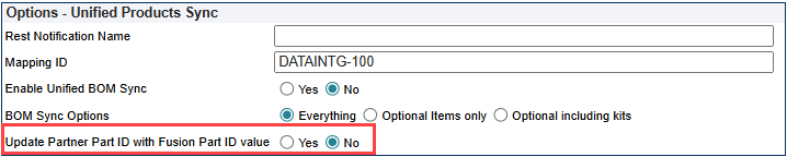

To ensure that both patterns continue working without disruption we have provided a new setting on the Configuration Settings page called Update Partner Part ID with Fusion Part ID value. This property will ensure that the Fusion Part ID and Partner Part IDs are the same. Any updates to the Fusion Part ID as part of Fusion Product syncs will propagate to the Partner Part ID.
The Update Partner Part ID with Fusion Part ID value will be set to Yes at the time of upgrade if you have a Fusion Product integration defined and do not have a Salesforce Product integration set up. If you wish to set up a Salesforce Product Integration and a Fusion Product Integration up at the same time, this must be set to No. You must also refactor any existing Fusion Products integration files and custom integrations to use the Fusion Part ID exclusively.
If you want to turn this setting off, follow these steps:
  1. Navigate to the Admin Home > Configuration Settings page.
  2. Click No to disable Update Partner Part ID with Fusion Part ID value within the Options - Unified Products Sync section.
Disable Update Partner part ID with Fusion Part ID Value
  1. Click Save.
