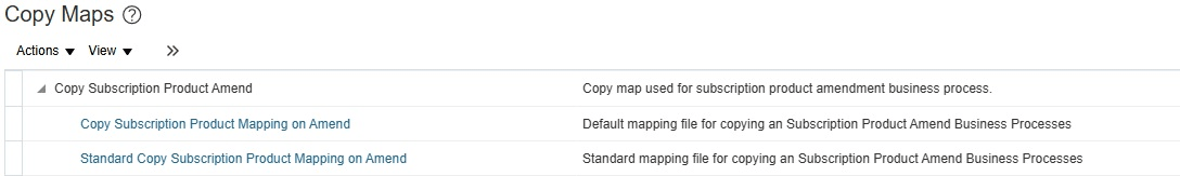

A new copy map for Amend is created in Copy Maps - Copy Subscription Product Mapping on Amend. You can modify this to meet your business requirements.
New Copy Map for Amend
You can set the copy map to be used in the profile option Copy Subscription Product Mapping on Amend.

- If you want to copy all the custom objects and attributes, then you do not have to modify the copy map.
- Do not modify the copy map Standard Copy Subscription Product Mapping on Amend.
- The copy map is used in both the synchronous and asynchronous modes of amending a subscription.
