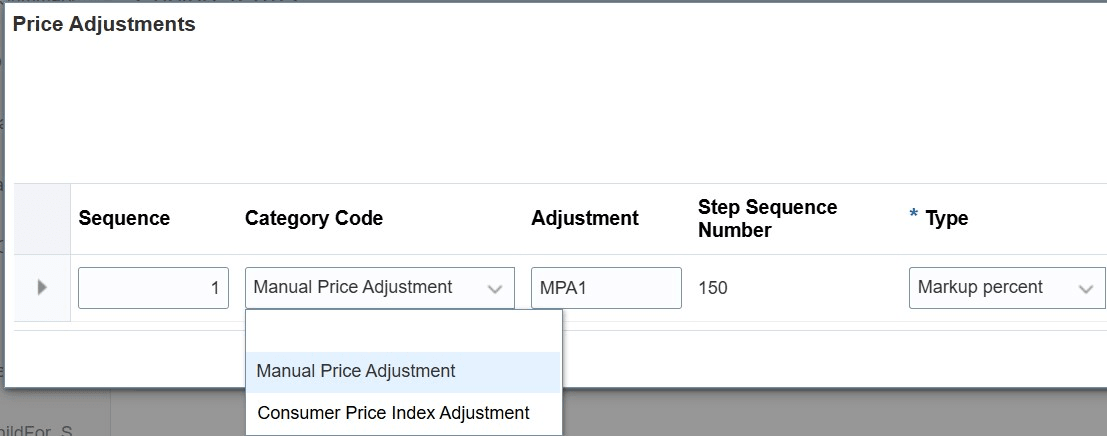

You can now adjust the prices using adjustments at the charges even while the subscription is active. You can add your own adjustment categories, specify the order of application of the adjustments and effectivities thereby bringing clarity to the purpose of the adjustments making it easy to explain to your customers. All this is possible even without amending the subscription. Additionally, date effective adjustments allow you to enter applicable start and end dates for charge adjustments thereby liberating you from adding adjustments that only conform to the billing periods.
The Price/Charge Adjustments UI now shows additional fields. These are available only for recurring charges (excluding usage charges modelled as recuring charges).
- Adjustment Category
- Adjustment Category Sequence
The Sequence number is now editable.
The Adjustment Category can be selected by the user, and these are defined in a lookup Price Adjustment Categories. This lookup is extendible, and new values can be added. An Adjustment Category is used to classify an adjustment that is either applied manually or systemically. The Adjustment Categories and their attributes are captured in a seeded data table. Each Adjustment Category is applicable for a particular price called the Price Element, that is calculated in an intermediate step as part of the pricing process. Only Adjustment Categories that are user enterable in the seeded data table can be selected by the user. There are several seeded Adjustment Categories and Price Elements which are explained below. The Price Element also appears in the Adjustment Basis.
Price Adjustment Categories and Price Elements

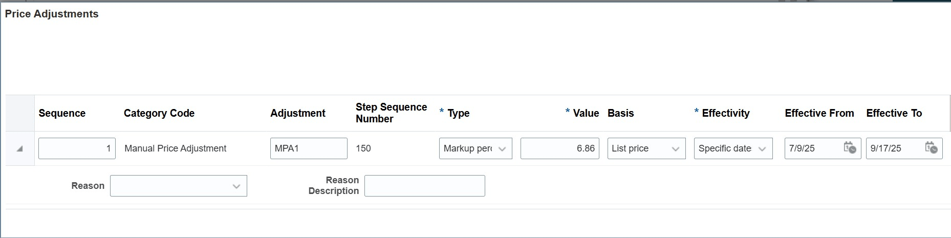

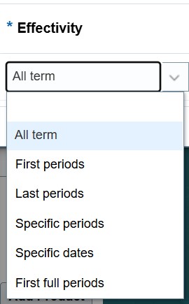

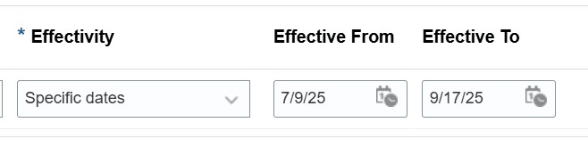

The Adjustment Type now shows a new value Specific dates. On selecting this type, the fields Effective from and Effective to show a calendar to select the dates for which the said adjustment is applicable. With this new adjustment type, bill periods will be split i.e. the Bill-from and Bill-to dates of a bill lines will now span the Effective from and Effective to dates.
Date Effective Price Adjustment
Effective From and To Fields
The Adjustment Basis now shows additional values - Adjusted List Price, Adjusted Net Price and Manual Adjusted List Price. These are the Price Elements defined in the seeded data table. So, now you can create adjustments like the ones shown below.

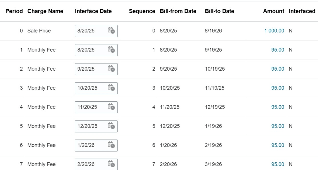

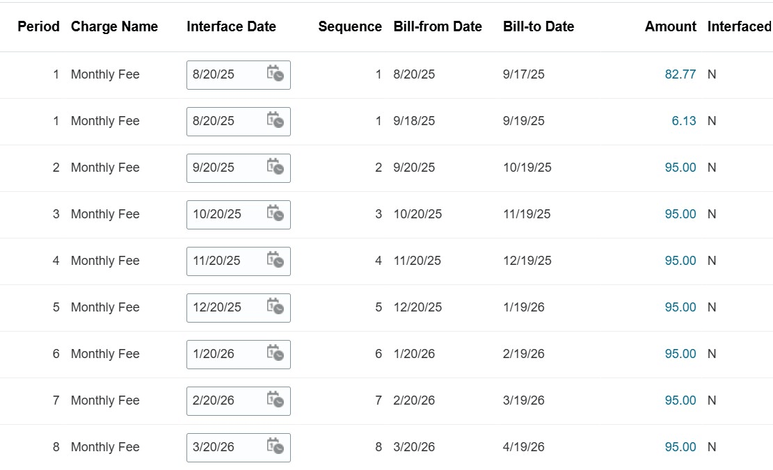

Consider a subscription product
Start Date: 20-Aug-2025
End Date: 19-Aug-2026
Billing Frequency: Month
Charge Name: Monthly Fee @ 95 USD/month.
The billing summary is
Billing Summary before Price Adjustment
Price Adjustments UI
Billing Summary after Adjustment is applied

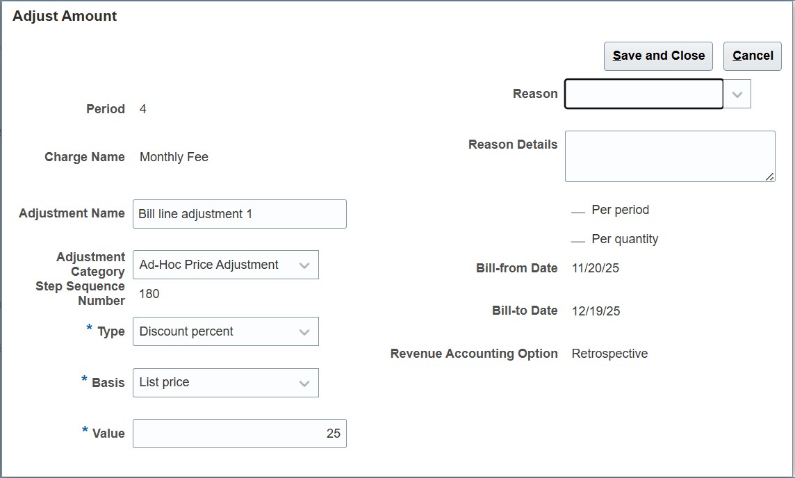

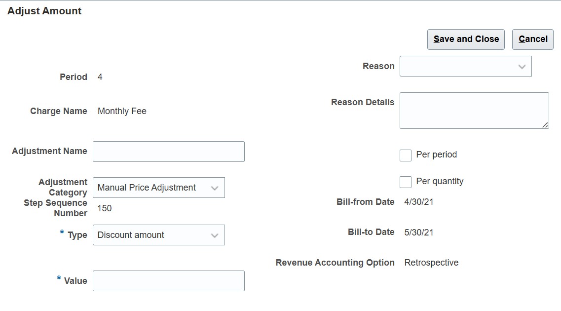

The Bill Adjustment UI now shows additional fields
- Per period
- Per quantity
The Adjustment Category can be selected to classify the bill line adjustment. The Adjustment Category Sequence appears for the selected Adjustment Category and is not editable. The checkbox Per period implies that the adjustment is for the charge period and Per quantity implies that the adjustment is for each unit quantity of the subscription product. The Per period and Per quantity checkboxes are enabled only when the adjustment type is Discount amount or Markup amount. Only the Adjustment Categories that are nor enabled for charge adjustments in the seeded data table appear in Bill Line Adjustments. The Bill line adjustment can be added in any subscription status until the bill line is interfaced to Receivables.
Bill Line Adjustments UI

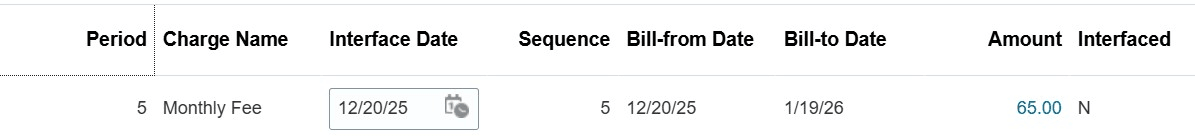

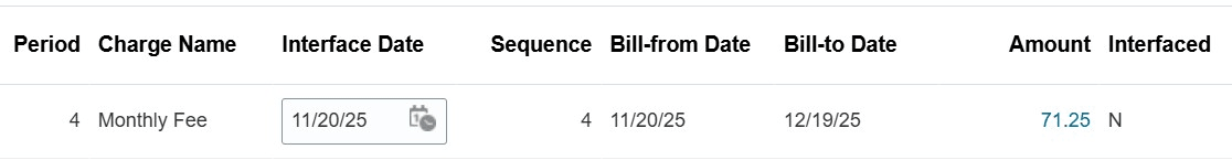

Consider a bill line adjustment as shown below
Bill line after Bill line adjustment

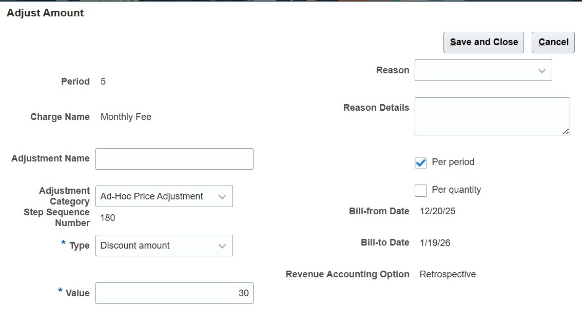

A bill line adjustment that is applied per period. This is application for Amount based adjustments- Markup amount, Discount Amount and Price Override.
Bill Line Adjustment Per Period
Bill Line Amount after Adjustment
