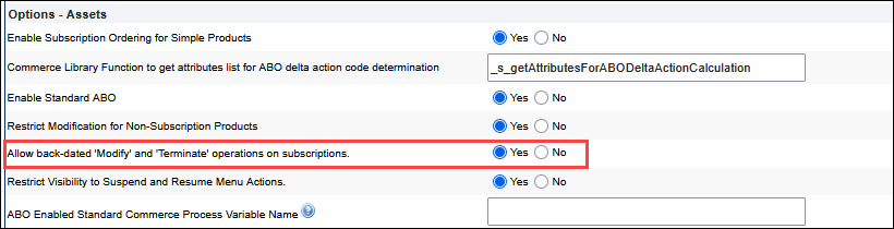

A new Commerce Setting, Allow back-dated ‘Modify’ and ‘Terminate’ operations on subscriptions, is supported for Oracle CPQ 26A Standard ABO implementations. This setting is set to No by default. Administrators can change the Allow back-dated ‘Modify’ and ‘Terminate’ operations on subscriptions setting to Yes to allow amending a subscription product before the effectivity date of the next amendment to that subscription product.
Options - Assets Settings

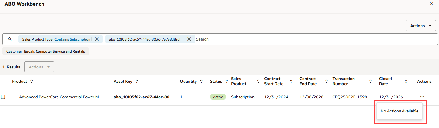

When the Allow back-dated ‘Modify’ and ‘Terminate’ operations on subscriptions setting is set to No (default), the Action drop-down for the subscription line item in the ABO Workbench does not allow amend actions.
Example ABO Workbench with Setting Set to No (Default)

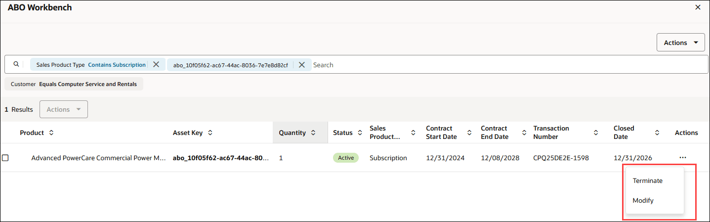

When the Allow back-dated ‘Modify’ and ‘Terminate’ operations on subscriptions setting is set to Yes, the Action drop-down for the subscription line item in the ABO Workbench supports Terminate and Modify Actions.
Example ABO Workbench with Setting Set to Yes
