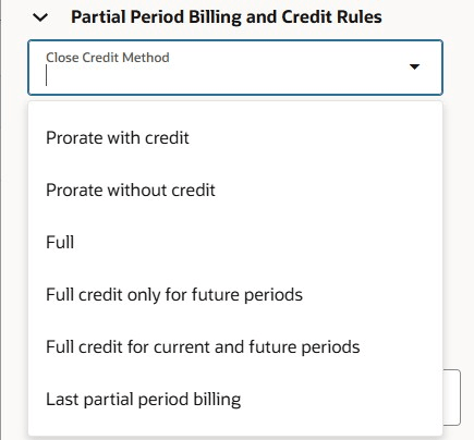

New Credit Methods for Close and Amend
The credit amount on close or amend of a product can now consider billed future periods or billed current and future periods for calculating the credit amount. The field Close Credit Method now shows the values
Close Credit Method
Three new values mentioned below are added.
- Last partial period billing.
- The partial period setup for Last Period from the section Partial Period Billing and Credit Rules is used to determine the credit amount.
- Full credit only for future periods
- Credits back only the future interfaced bill periods. Deletes all the future period bill lines that are not interfaced yet.
- All future billed periods are credited. All future unbilled period bill lines are dropped. Past and current period bill lines are retained.
- Full credit for current and future periods
- Credits back the current period, and future interfaced periods. Deletes all the future period bill lines that are not interfaced yet.
- All future and current billed period bill lines are credited. All future and current unbilled period bill lines are dropped.
