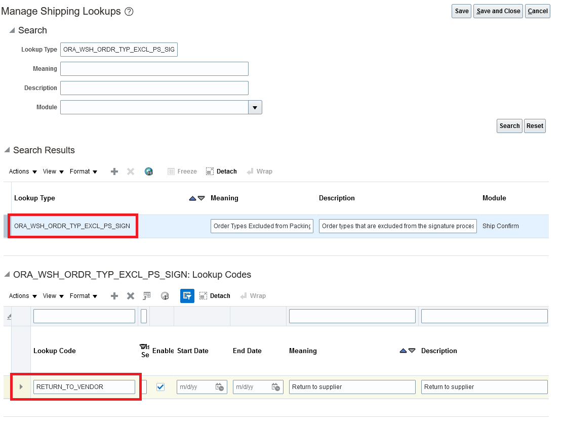

Exclude Packing Slip from the Signature Process
  1. On the Manage Shipping Lookups page, search for the ORA_WSH_ORDR_TYP_EXCL_PS_SIGN lookup type.
  2. In the ORA_WSH_ORDR_TYP_EXCL_PS_SIGN: Lookup Codes section, click Actions > New.
  3. In the lookup code field, enter the order type for which the signature process should be excluded.
  4. Click Save and Close.
Exclude Return to Vendor Shipments from the Packing Slip Signature Process

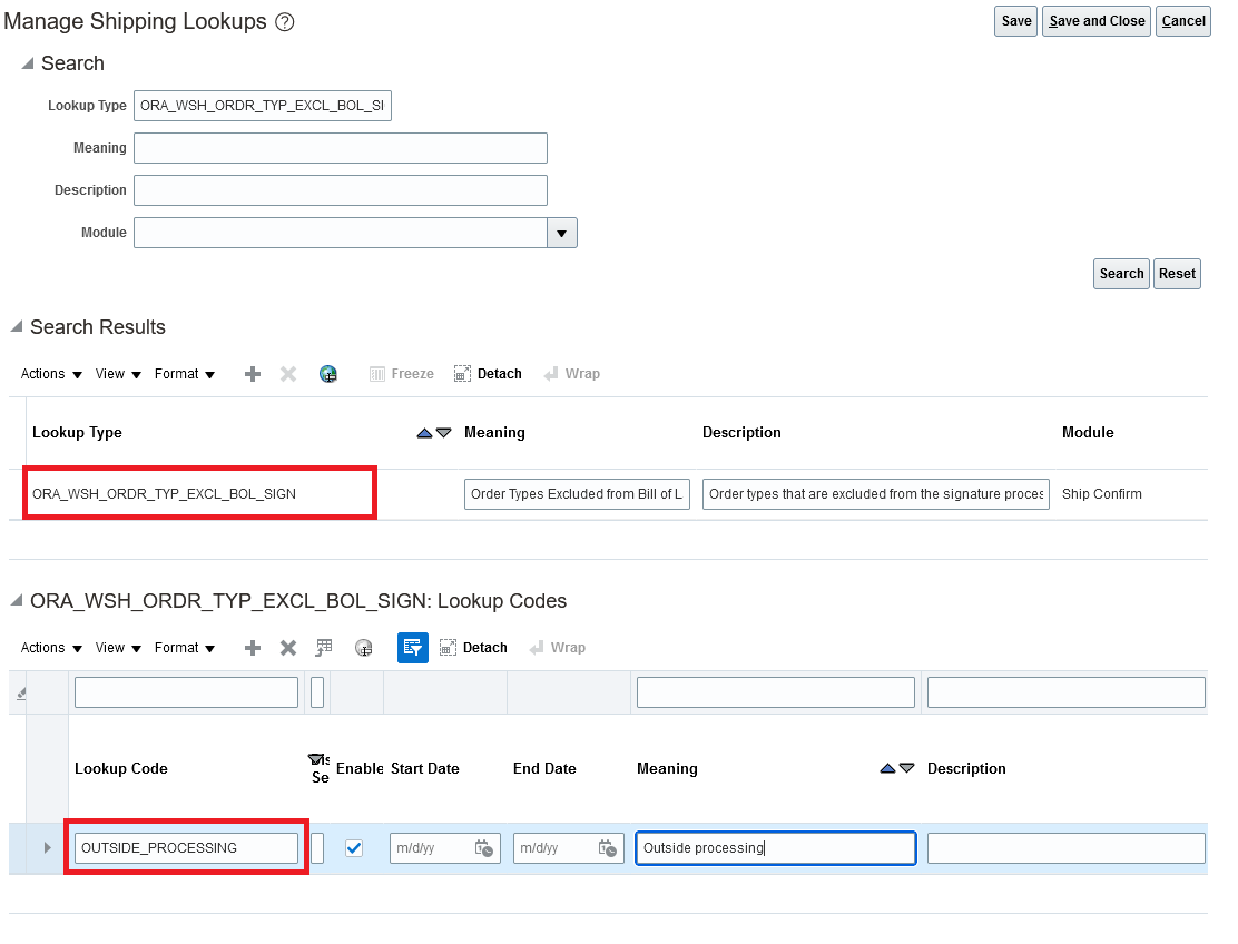

Exclude Bill of Lading from the Signature Process
  1. On the Manage Shipping Lookups page, search for the ORA_WSH_ORDR_TYP_EXCL_BOL_SIGN lookup type.
  2. In the ORA_WSH_ORDR_TYP_EXCL_BOL_SIGN: Lookup Codes section, click Actions > New.
Exclude Outside Processing Shipments from the Bill of Lading Signature Process

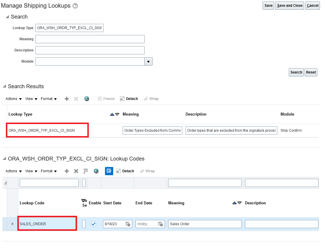

Exclude Commercial Invoice from the Signature Process
  1. On the Manage Shipping Lookups page, search for the ORA_WSH_ORDR_TYP_EXCL_CI_SIGN lookup type.
  2. In the ORA_WSH_ORDR_TYP_EXCL_CI_SIGN: Lookup Codes section, click Actions > New.
Exclude Sales Order Shipments from the Commercial Invoice Signature Process
Use these order type values for the Lookup Code field.
