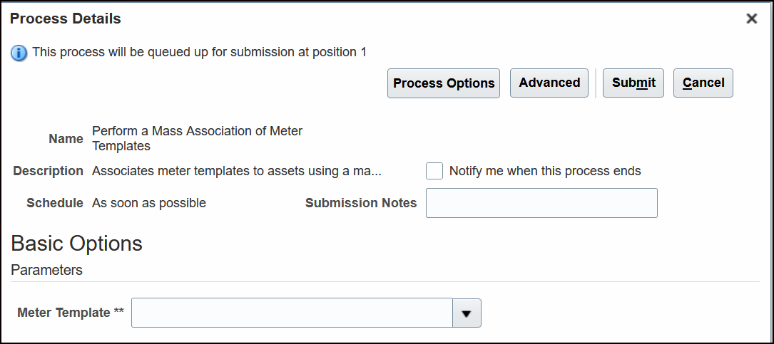

Submitting Job Process from Scheduled Processes Page
The job is accessible through the Scheduled Processes. You can perform the Perform Mass Association of Meter Templates job with or without the meter template parameter (optional).
Scheduled Process
