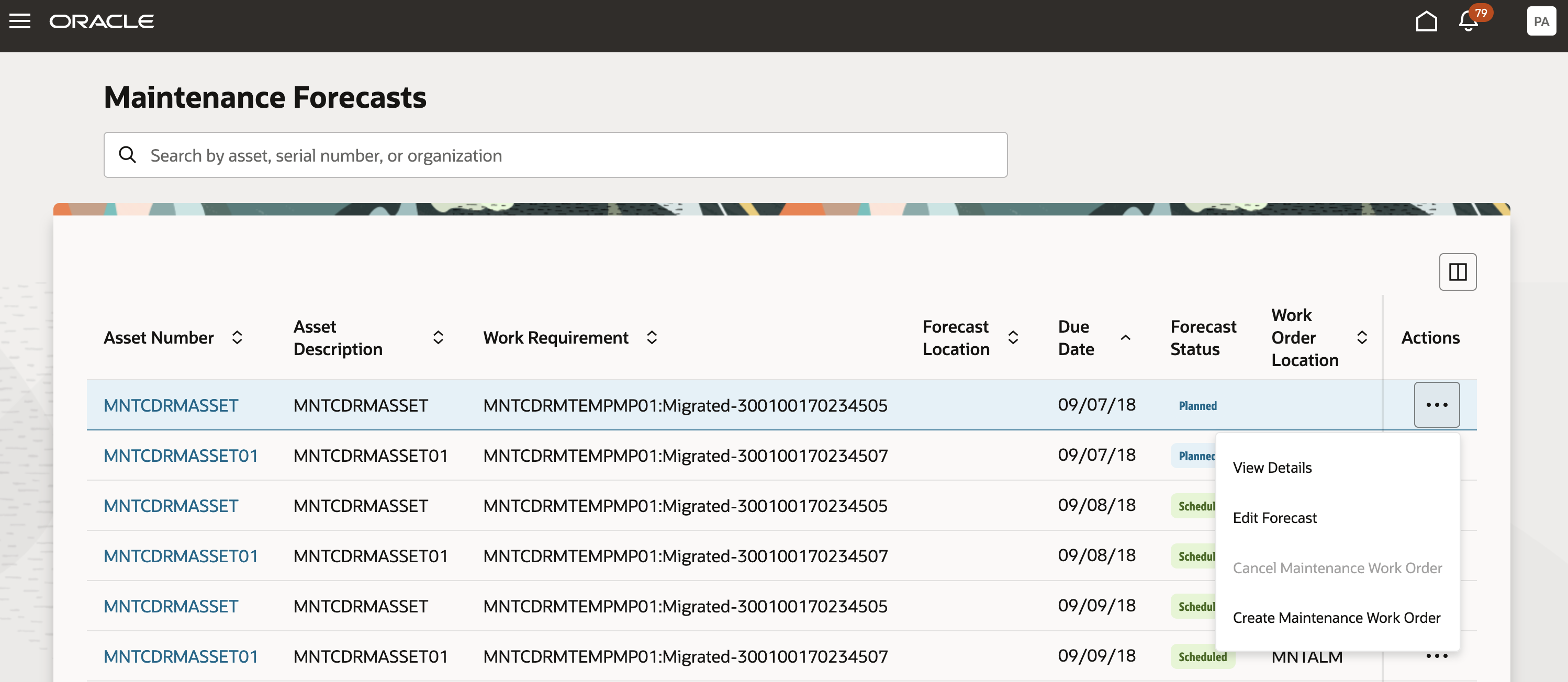

With this update, you can perform the following actions using the new Manage Forecast page.
  • View details about the due date, including the source maintenance program, work requirement and forecast method.
  • Provide a requested due date that's different than the forecasted due date. The due date must be after the last due date and before the next due date in the forecast for an asset.
  • Provide a requested work order location that's different than the forecasted location. This is only available if the forecast line was created from a program that's enabled for assets across organizations. The requested location must also be enabled for maintenance and have matching work definitions defined. Additionally, to create work orders for assets across organizations you must either define organizational relationships between maintenance organizations or enable a new parameter that will not require relationships.
  • Skip a due date in the past, present or future where there isn't an active work order. Skipping a due date will suppress the creation of a work order for the due date by the scheduled process.
  • Unskip a due date in the past, present or future. Unskipping a due date will enable the creation of a work order for the due date manually or by the scheduled process. If the due date is in the past, you can manually create a work order.
  • Create a work order for a due date in the past, present or future. This can be for any due date, regardless if it's set to automatically or manually create a work order. This action launches a concurrent process request to create the work order.
  • Cancel a work order for a due date in the past, present or future. You can cancel an existing work order, then manually create a new work order on a the same or different date or location. A work order can only be canceled if there haven't been any transactions record. Examples are operation completion, material issue, or resource reporting.
Manage Maintenance Forecasts Page
You can now effectively manage the preventative maintenance on assets that operate both within and across organizations over time using the Manage Forecast page. With this feature, you can plan centrally while executing maintenance anywhere.
