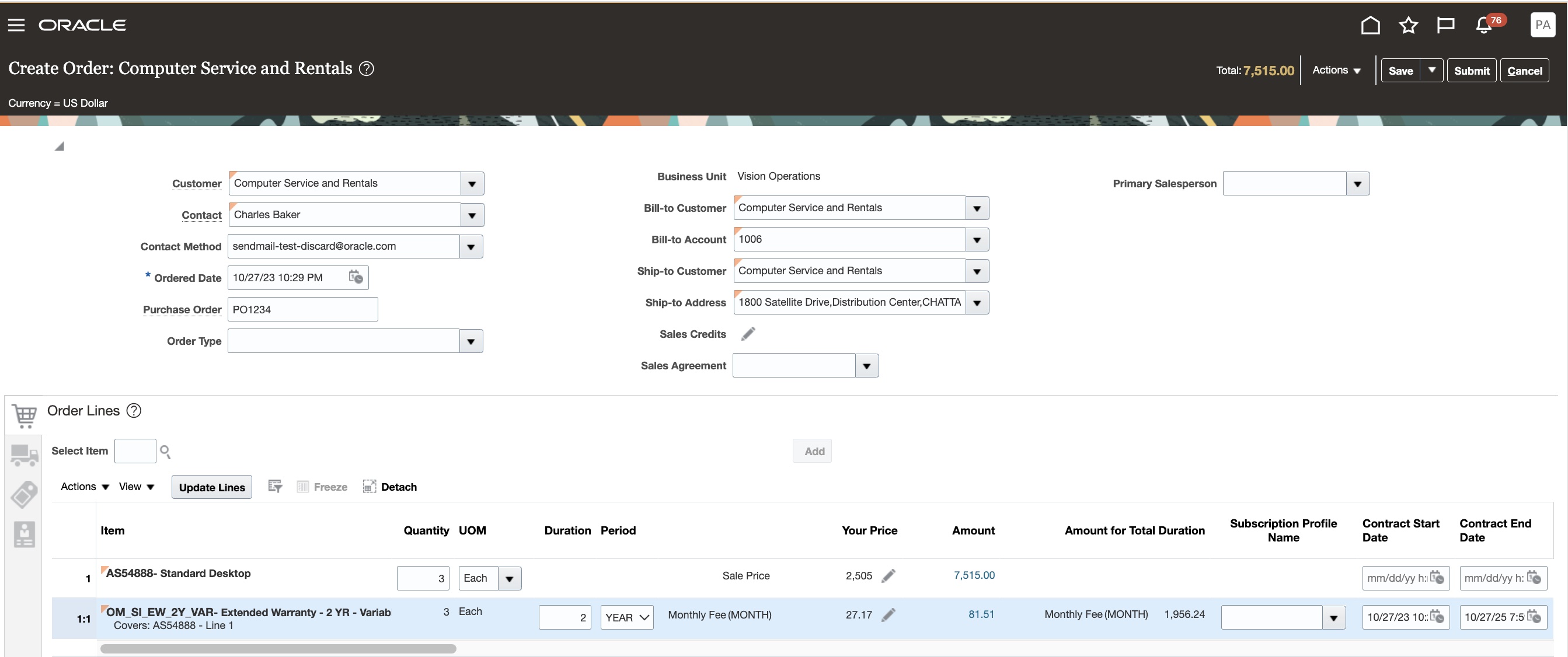

- Create a sales order in the Order Management work area.

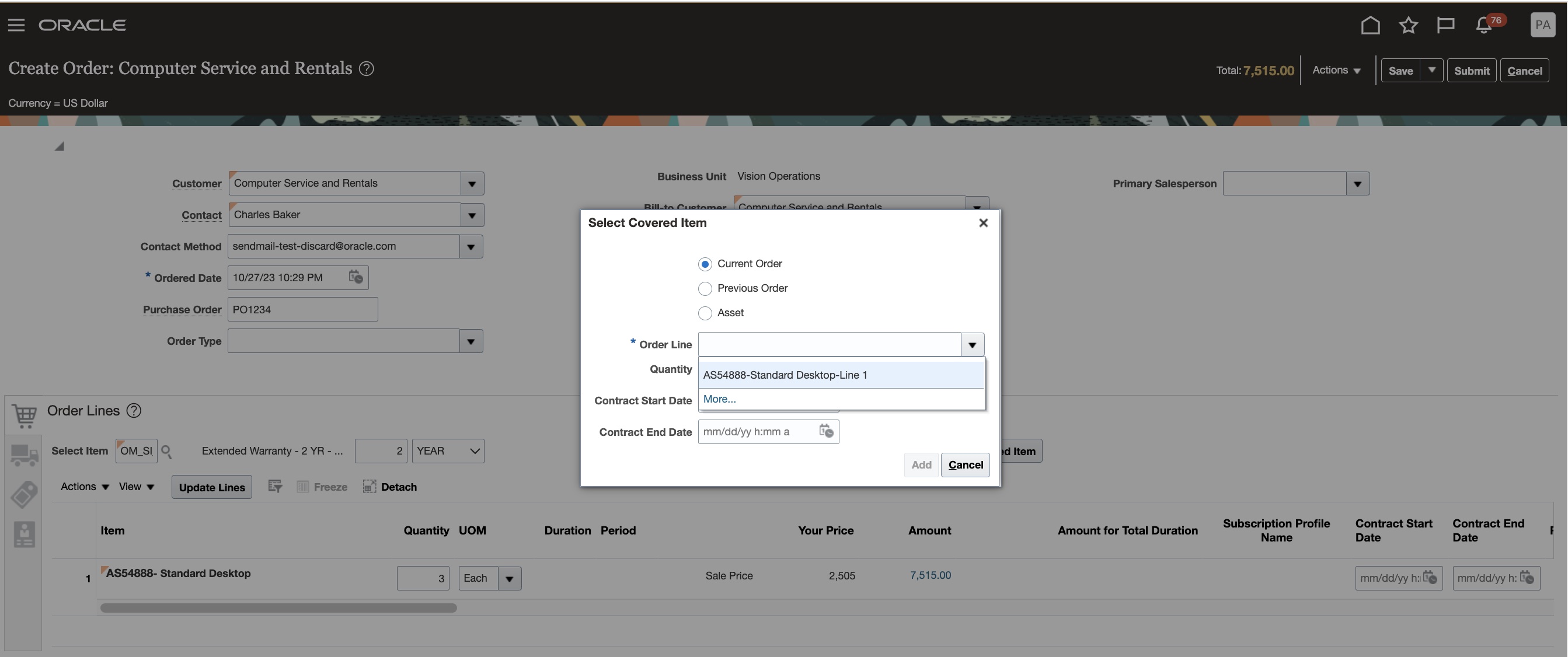

- Add an item that you can cover to the sales order, and then add a coverage to the covered item.
For example, add the AS54888 Computer.
Add a coverage to the covered item. For example, add a 2 Year Warranty.
Coverage on the order line
You can also set other values on the order line that affect the coverage. For example, add a pricing term, override a charge, and so on. The values that you can set depend on how you set up pricing.
