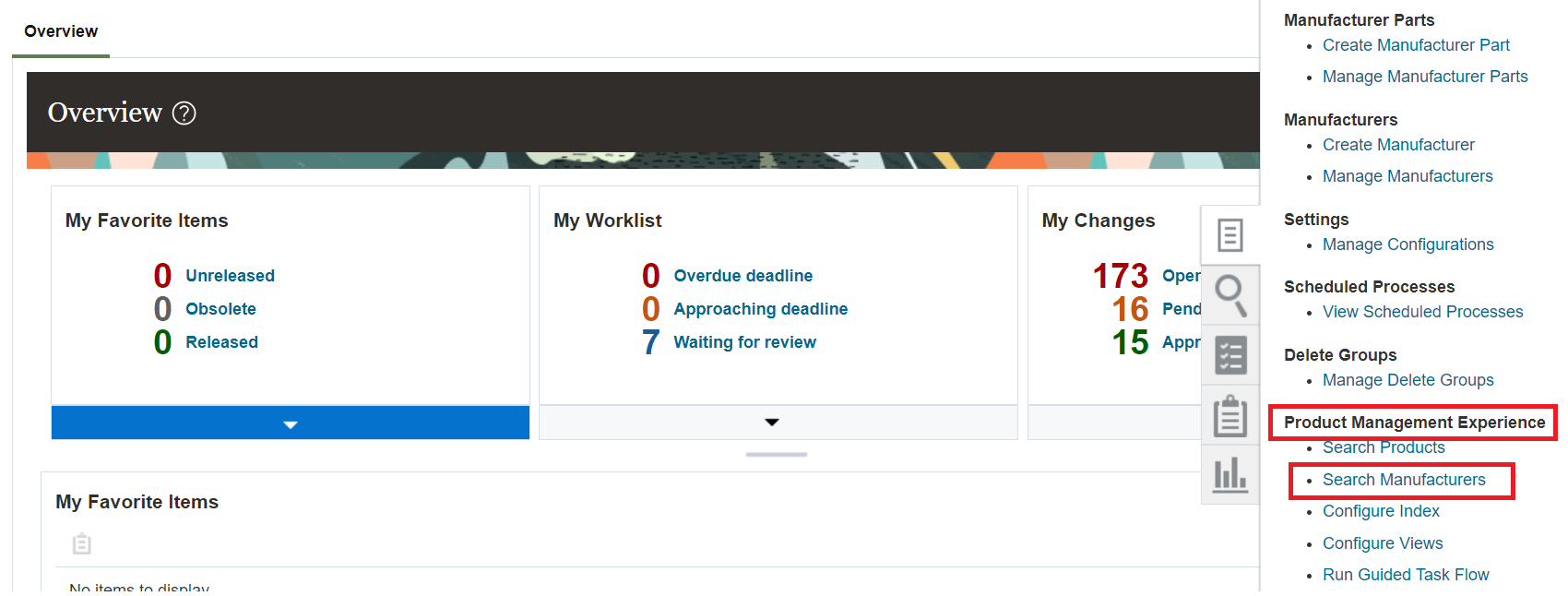

To navigate to the new manufacturer search, go to Tasks > Product Management Experience > Search Manufacturers.
Search Manufacturers Task in Tasks Panel
When you navigate from this task, the default search is for manufacturers. You can switch between objects using the context switcher.

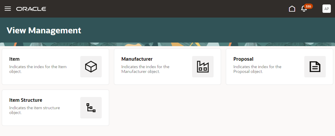

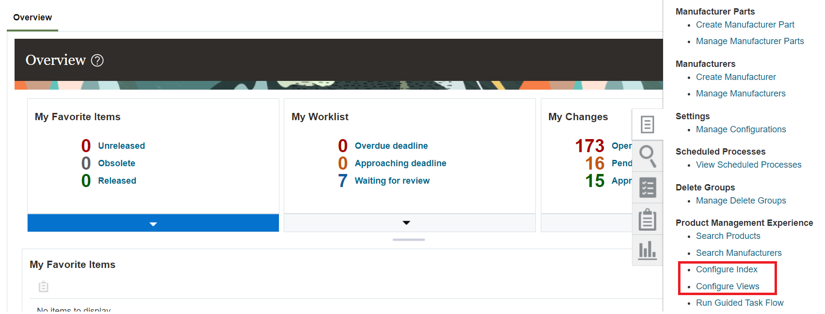

Configure Indexes and Search Views
You can configure the index of attributes you want use in your searches, and create specific search views. To navigate to the Index and View Management interface, use the following tasks within the Product Management Experience section in the Tasks panel:
  • Configure Index
  • Configure Search
Configure Index and Views in Task Panel
In the Index and View Management interface, you can:
  • Configure indexing of attributes for each object
  • Configure multiple search views
  • Configure display options for each view, including columns, filters, and more.

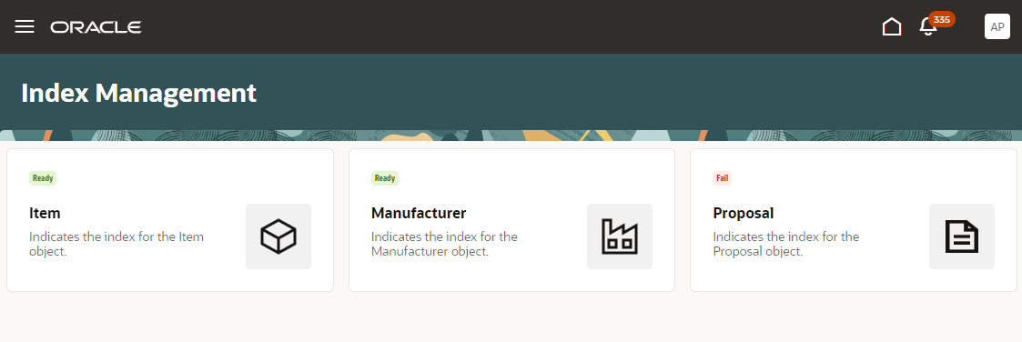

Configure Index
On the Index Management page, you see the objects that are enabled for index configuration.
Index Management Page

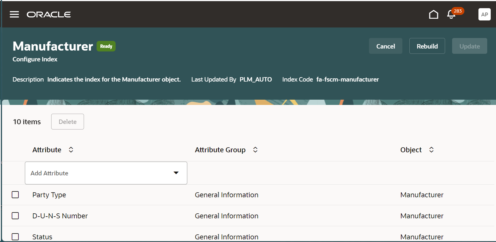

The Configure Index page for each object shows you the list of attributes and attribute groups that are already indexed. You can add or remove attributes and then rebuild the index to include additional attributes. Once the rebuilding is complete, the attributes can be added to a search view.
Configure Index Page for Manufacturer Attributes

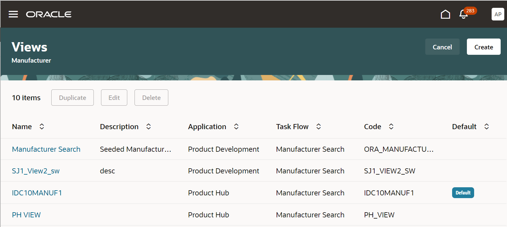

Configure Views
On the Configure Views page, you see the list of views that have already been configured.  You can modify an existing view or create a new one.  For each view, you can add or remove attributes that are indexed.  The view that is marked as default is displayed in the Manage Manufacturers page.
Configure View for Objects

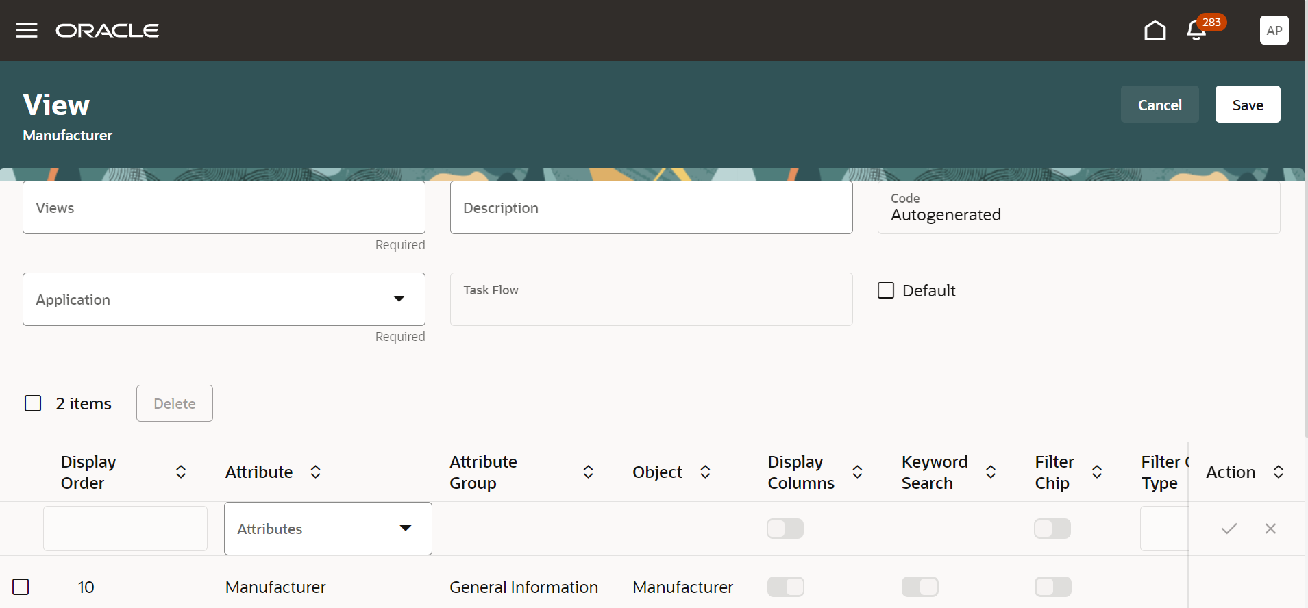

For each attribute, you can enable the following:
  • Keyword Search - Search for the attribute by entering a search term in the search field.
  • Display columns - Show a column for the attribute in the search results.
  • Filters - Filter results by the attribute. Filter chips are enabled for attributes which are either date or text. You can’t enable filter chips for long text attributes.
Search Views for Manufacturer
Configure View Display and Options
