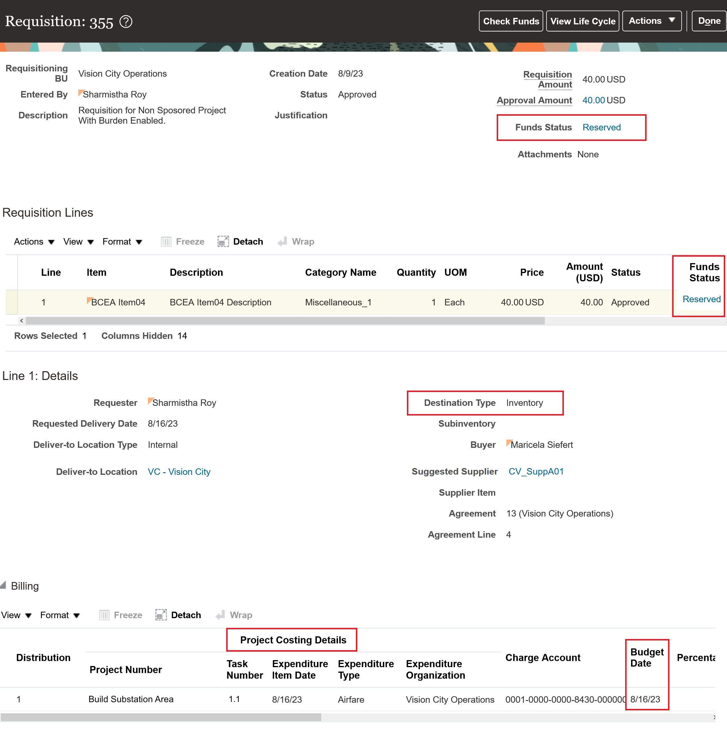

Project-specific requisitions created with an inventory or work order destination, as well as back-to-back requisitions, can have funds reserved as a commitment against the project or chart of account-based control budgets or both, when budgetary control is enabled for these transaction types. Funds reserved will include both the raw (requisition cost) and related burden costs.
Requisition for Inventory Destination with Project Details

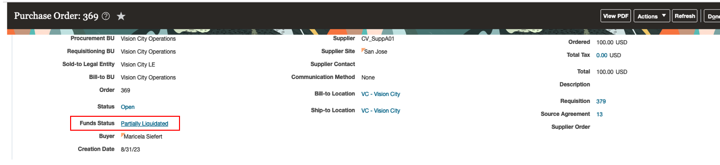

When budgetary controlled validation is performed on purchase orders created independently or from such requisitions, funds are reserved as an obligation. Also, commitments for requisitions, if applicable, are liquidated. The funds status on the purchase order is updated throughout the procurement lifecycle, until the costs have been imported into Project Costing.
Purchase Order with Funds Status showing Partially Liquidated for a Partial PO Receipt imported into Project Costing

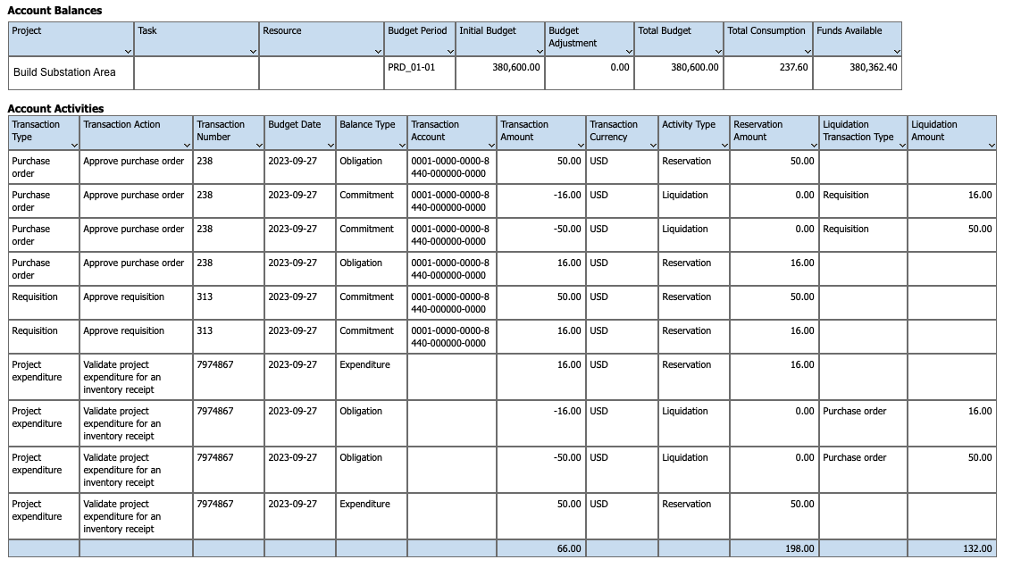

Use the Budgetary Control Analysis Report to view control budget balances for non-sponsored projects, and the Manage Awards page to view control budget balances for sponsored projects.
Budgetary Control Analysis Report Showing the Funds Reservation and Liquidation Happening at Requisition, Purchase Order and Project Costing

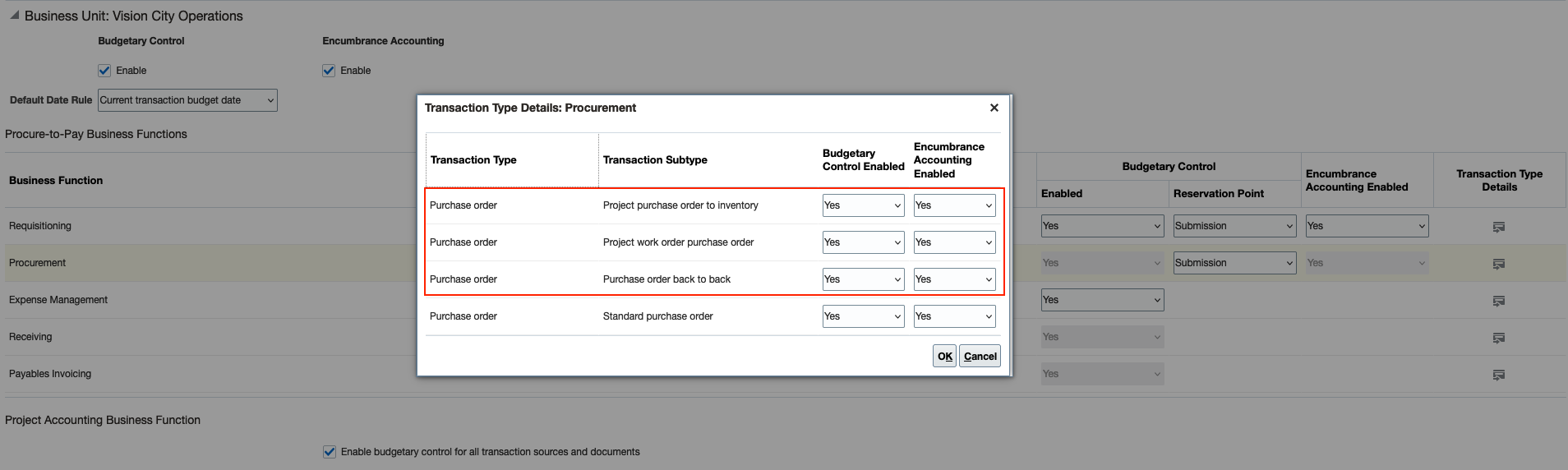

- Navigate to the Manage Budgetary Control task in the Functional Setup Manager. For your concerned ledger and business unit, edit the Budgetary Control and Encumbrance Accounting options. In the Edit Budgetary Control and Encumbrance Accounting page:
- Enable budgetary control for the ledger, business units assigned to the ledger, and the project accounting business function.

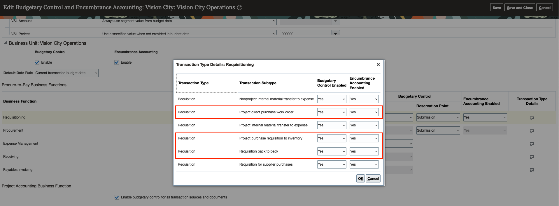

 - Enable budgetary control and encumbrance accounting for these Requisitioning business function transaction subtypes:
- Project purchase requisition to inventory for project-referenced requisition with an inventory destination.
 - Requisition back to back for back-to-back orders
 - Project direct purchase work order for direct procurements made to a work order destination from a project-referenced manufacturing or maintenance work order.
Budgetary Control and Encumbrance Accounting Enablement for Business Function Requisitioning
- Enable budgetary control and encumbrance accounting for these Procurement business function transaction subtypes:
- Project purchase order to inventory for project-referenced purchase orders with an inventory destination.
 - Project order back to back for back-to-back orders
 - Project work order purchase order for direct procurements made to a work order destination from a project-referenced manufacturing or maintenance work order.
Budgetary Control and Encumbrance Accounting Enablement for Business Function Procurement

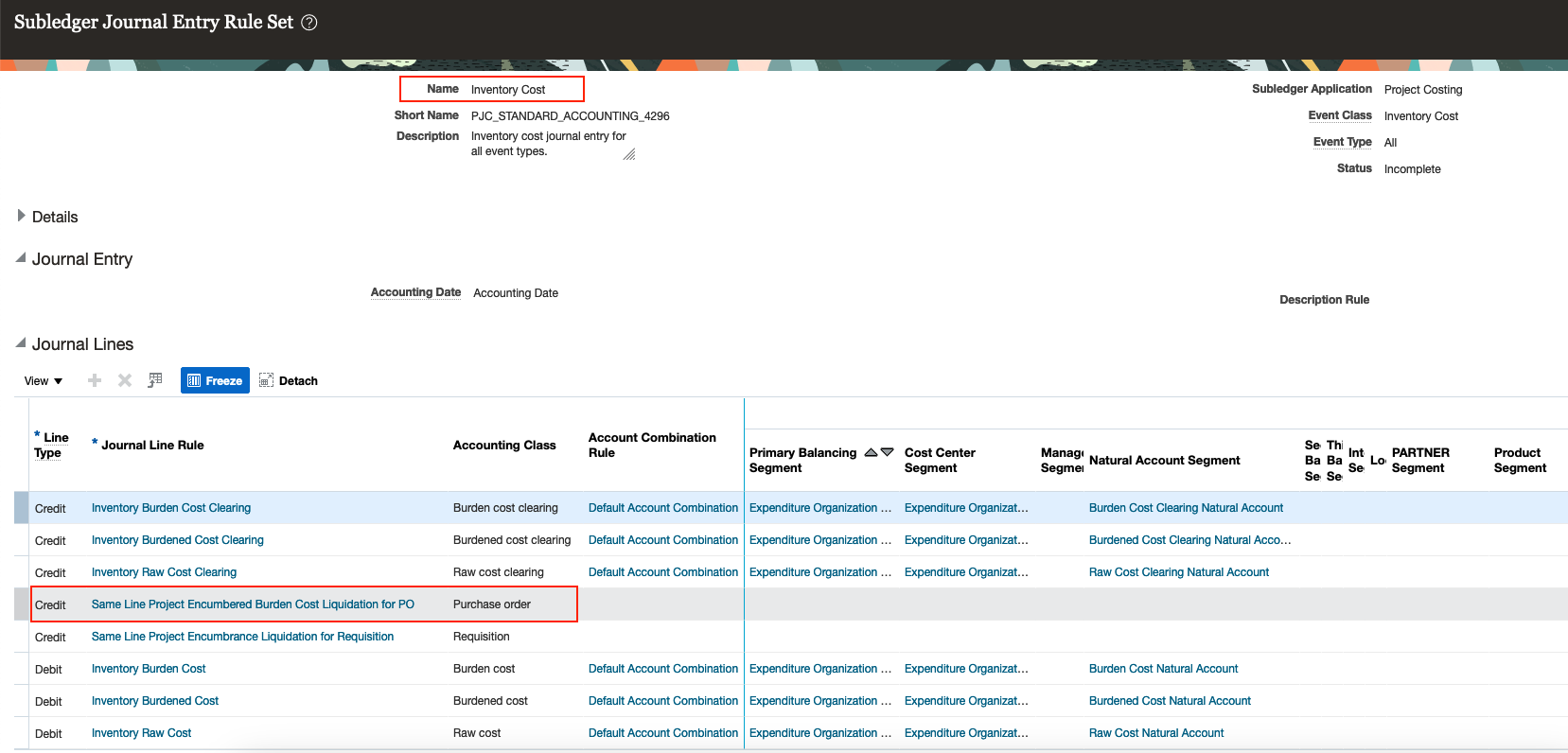

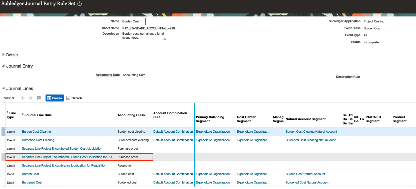

- This feature also makes available two new journal line rules for encumbrance accounting in Project Costing. 'Same Line Project Encumbered Burden Cost Liquidation for PO' for same line burdening enabled projects, and 'Separate Line Project Encumbered Burden Cost Liquidation for PO' for separate line burdening enabled projects. They are already available in the ‘Inventory Cost’ and ‘Burden Cost’ seeded journal entry rule sets.
New Project Costing Journal Entry Rules for Liquidation of Encumbered Burden Cost for Same Line Project
New Project Costing Journal Entry Rules for Liquidation of Encumbered Burden Cost for Separate Line Project
- If your ledger is assigned with a user-defined subledger accounting method, then add these new journal line rules to your rule sets and recompile your subledger accounting method for encumbrances to be accounted successfully for project-specific procurements to an inventory or work order destination.

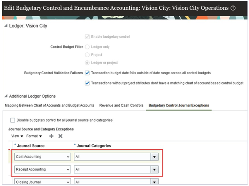

- Verify that the journal sources for cost accounting and receipt accounting are displayed in the Budgetary Control Journal Exceptions section, under the Ledger Options region in the Edit Budgetary Control and Encumbrance Accounting page. Add these sources if they have not been previously included.
Journal Source and Category Exceptions for Cost Accounting and Receipt Accounting

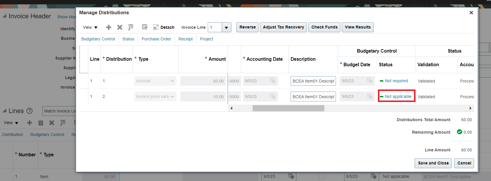

- Before this feature, for budgetary control enabled ledgers, Payables reserved funds for invoice price variances in the applicable control budgets when the invoice was matched to project-specific purchase orders to an inventory destination. With this feature, Payables will stop reserving funds for invoice price variances and the reservation will instead be done by Project Costing. It is recommended to review your existing user-defined business flows that could be impacted by this change.
- When invoice price variances exist for project-specific purchase orders to an Inventory and Work Order destination, the funds status for such distributions will show as not applicable. These distribution lines are also not subject to further funds reservation at General Ledger.
