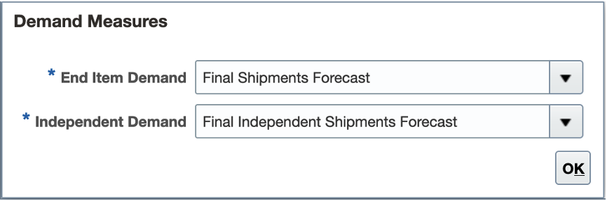

    • In the Supply tab,  Organizations and Schedules subtab, select these values for your demand measures, or you can use user-defined measures.
      • End Item Demand: Final Shipments Forecast
      • Independent Demand: Final Independent Shipments Forecast
Demand measures
Demand Measures

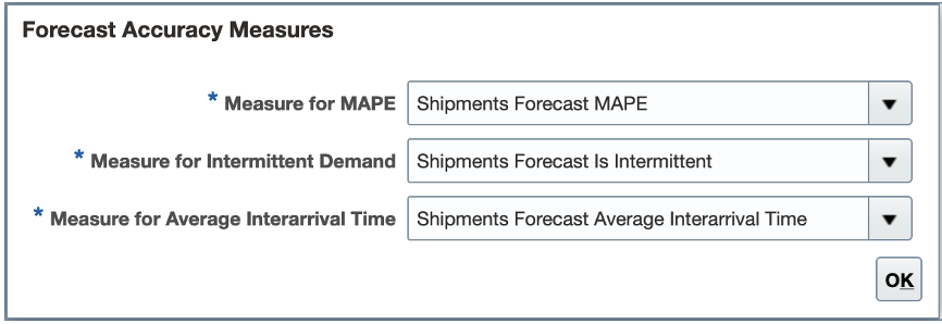

  • Also, select these values for the corresponding forecast accuracy measures, or you can use user-defined measures:
    • Measure for MAPE: Shipments Forecast MAPE
    • Measure for Intermittent Demand: Shipments Forecast Is Intermittent
    • Measure for Average Interarrival Time: Shipments Forecast Average Interarrival Time
Forecast accuracy measures
Forecast Accuracy Measures

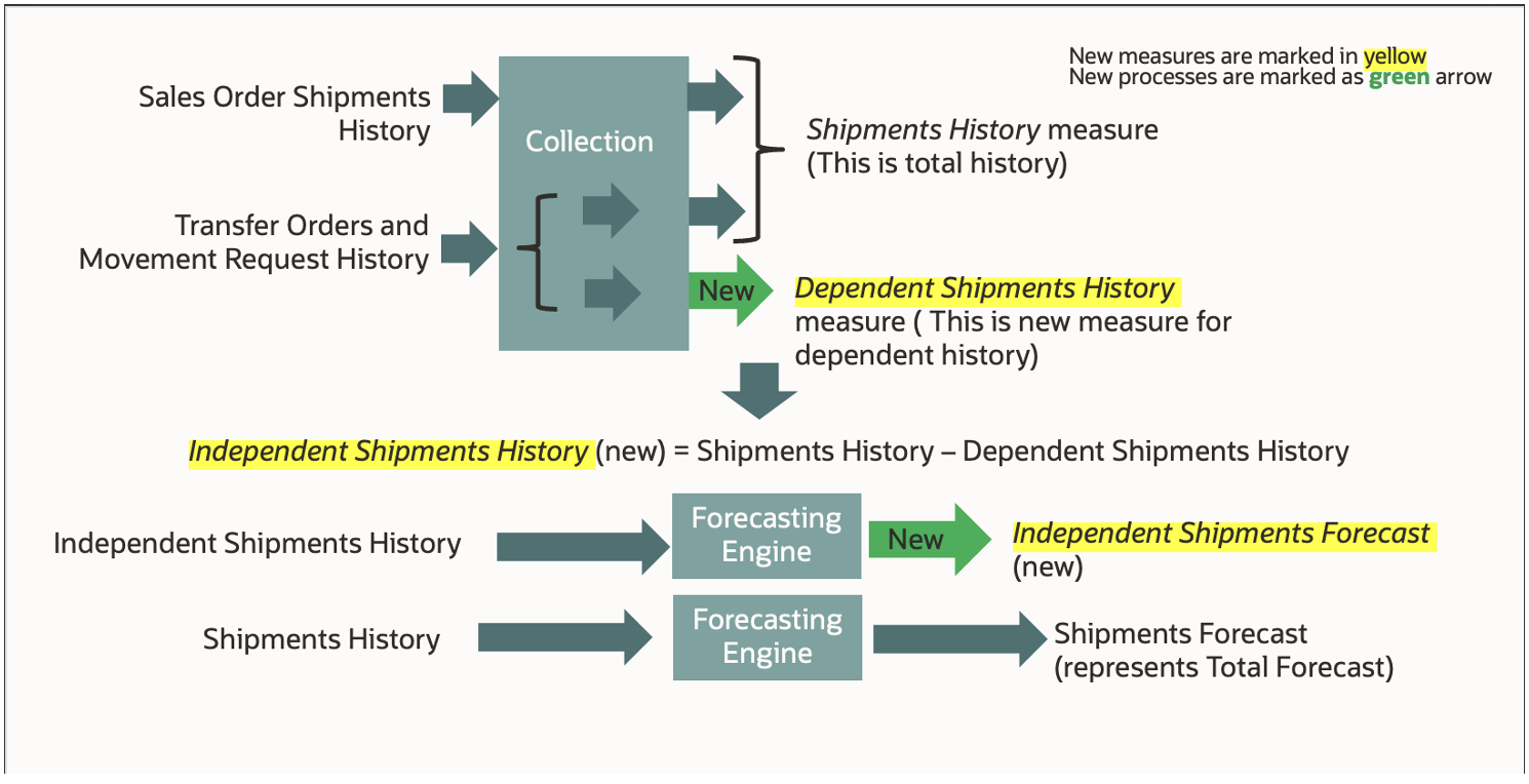

Summary of How Total Forecast and Independent Forecast Are Generated
The following figure summarizes how total forecast and independent forecast are generated:
Summary of how total forecast and independent forecast are generated
