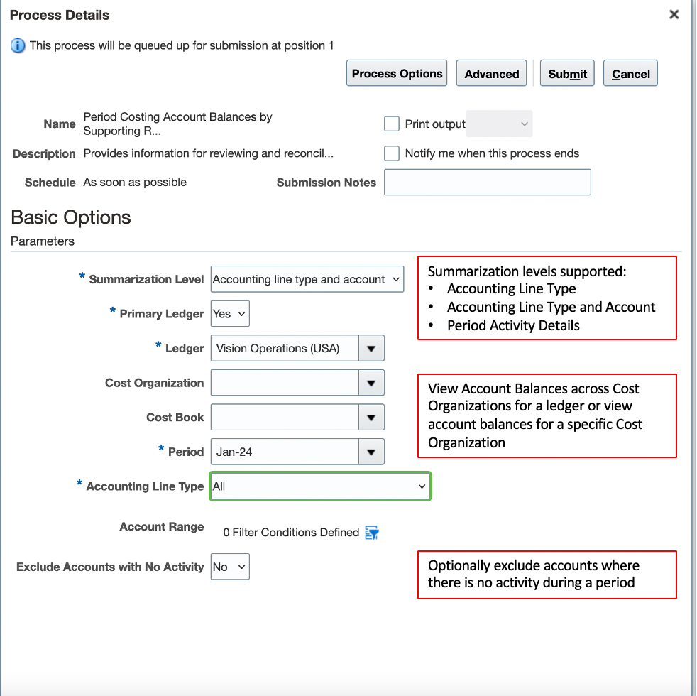

- You can view and reconcile summary and detail balances for a period at the ledger level or for each cost organization and cost book depending upon your enterprise structure and the level at which you reconcile accounts.
You can view and reconcile account balances at the following levels:

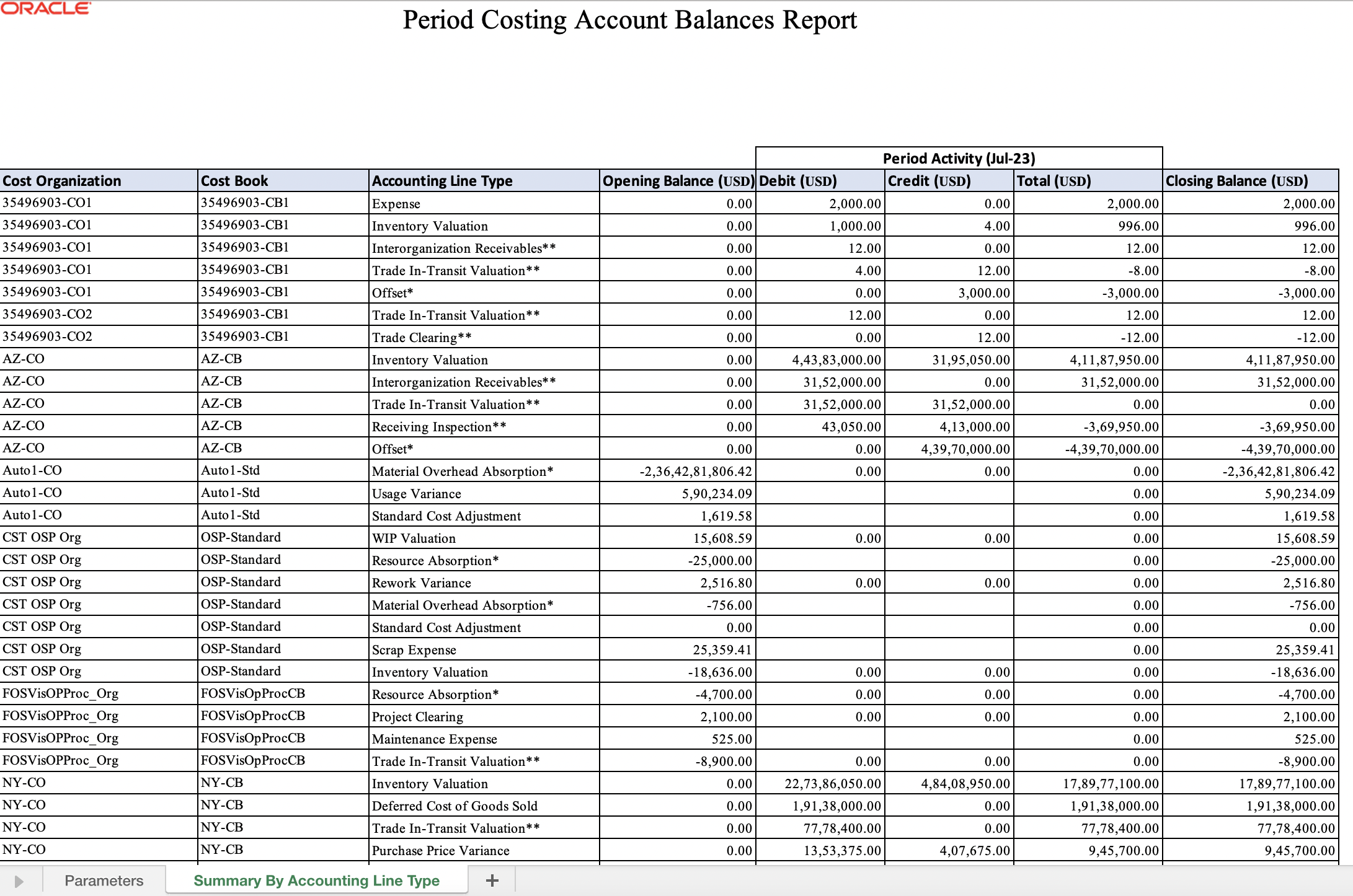

- Accounting Line Type: View summary opening balance, period activity (debits and credits), and closing balance for each cost accounting type.
Summary of Costing Account Balances by Accounting Line Type

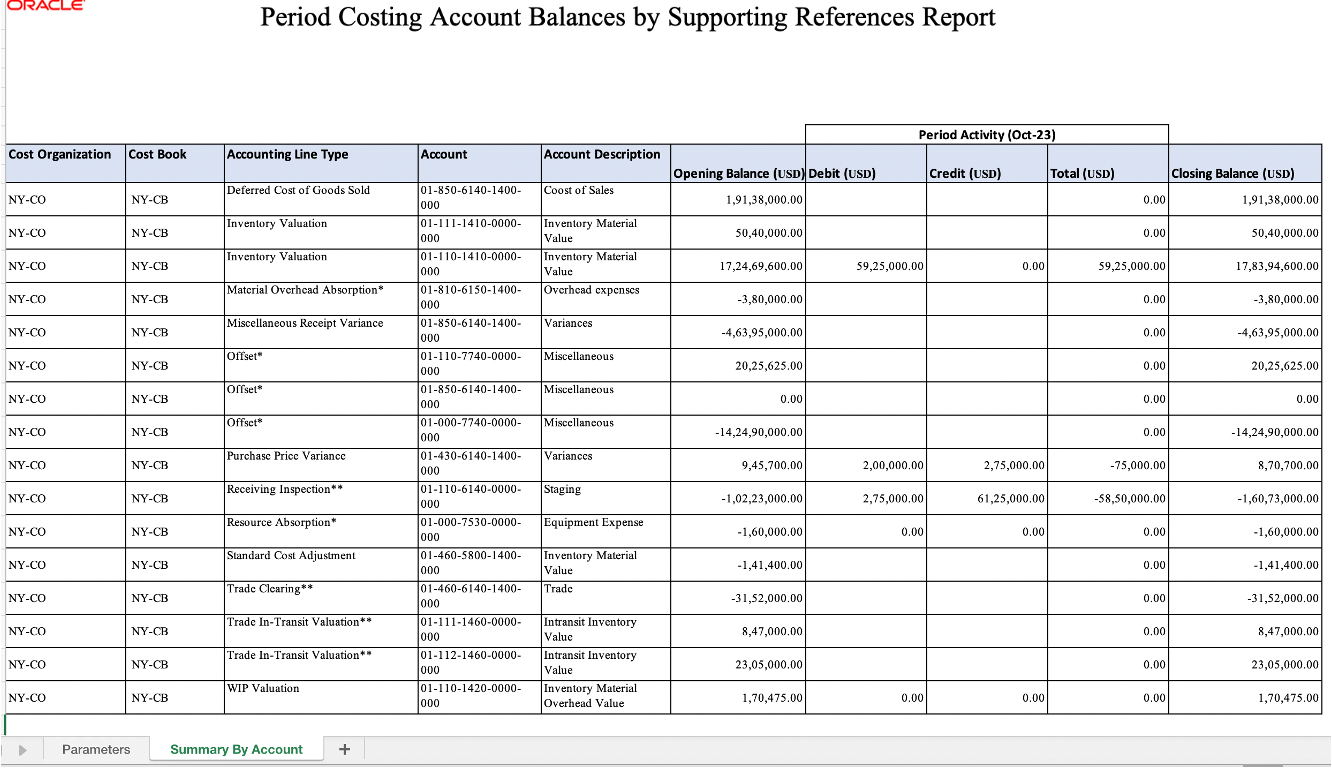

- Accounting Line Type and Account: View summary opening balance, period activity (debits and credits), and closing balance for each cost accounting line type and account. Use this view to review balances at account level for an accounting line type. Pay attention to same account being used for multiple accounting line types and confirm this as per expectation. Drill down to Period Activity Details to view transaction information and ensure transactions are correctly classified.
Summary of Costing Account Balances by Accounting Line Type and Account

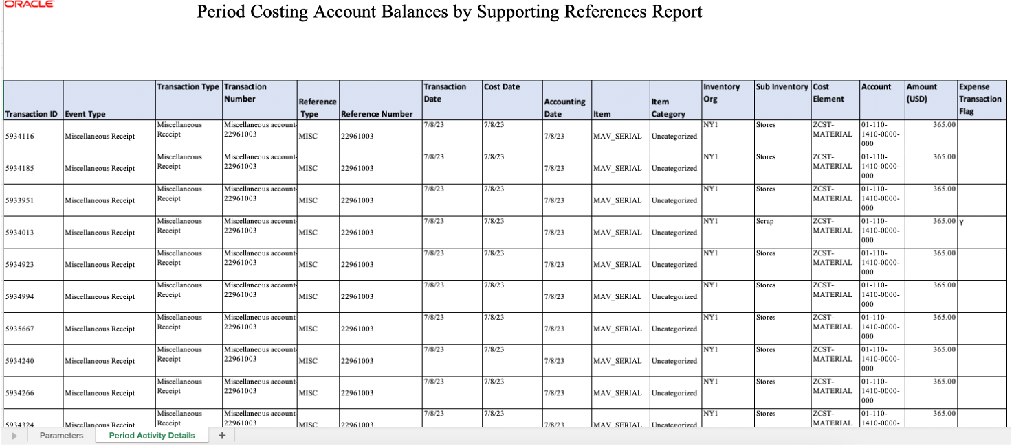

- The Period Activity details view provides a clear link between Inventory and Costing transaction attributes, cost distribution and General Ledger accounting information distributions to help in reconciliation.
- View Period Activity Details to understand change to account balance during the period to substantiate account balances. Review transaction information to ensure transactions are classified correctly from an accounting perspective and flag any reconciliation issues.
View Transactions Contributing to Period Activity Along with Key Costing and Accounting Information

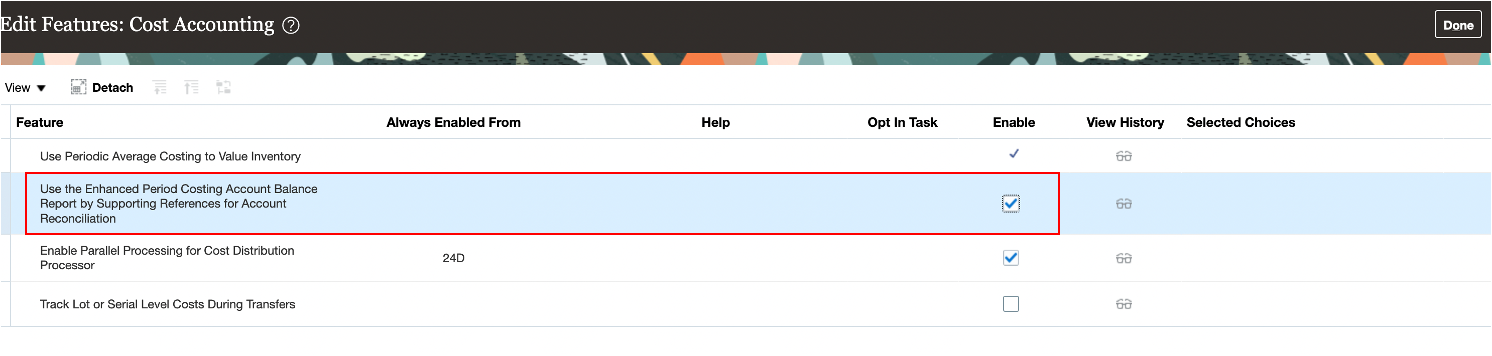

Steps to Enable
Use the Opt In UI to enable this feature. For instructions, refer to the Optional Uptake of New Features section of this document.
Offering: Manufacturing and Supply Chain Materials Management
- Opt in to the below feature to use this report.

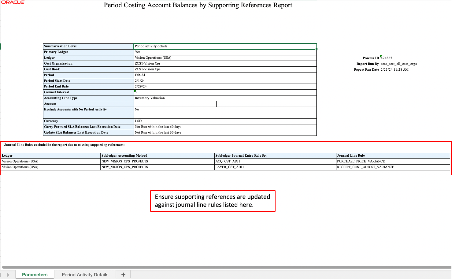

- Important: If the above supporting references aren't enabled against the journal lines, this report won't display balances for the corresponding accounting line types and accounts. The report, however, will provide information on such journal lines missing supporting references in the parameters tab of the report. You must:
- Update supporting references for journal line rules identified as exceptions in the parameters tab of the report.
View Journal Line Rules Missing Supporting References in the Parameters Tab of the Report
