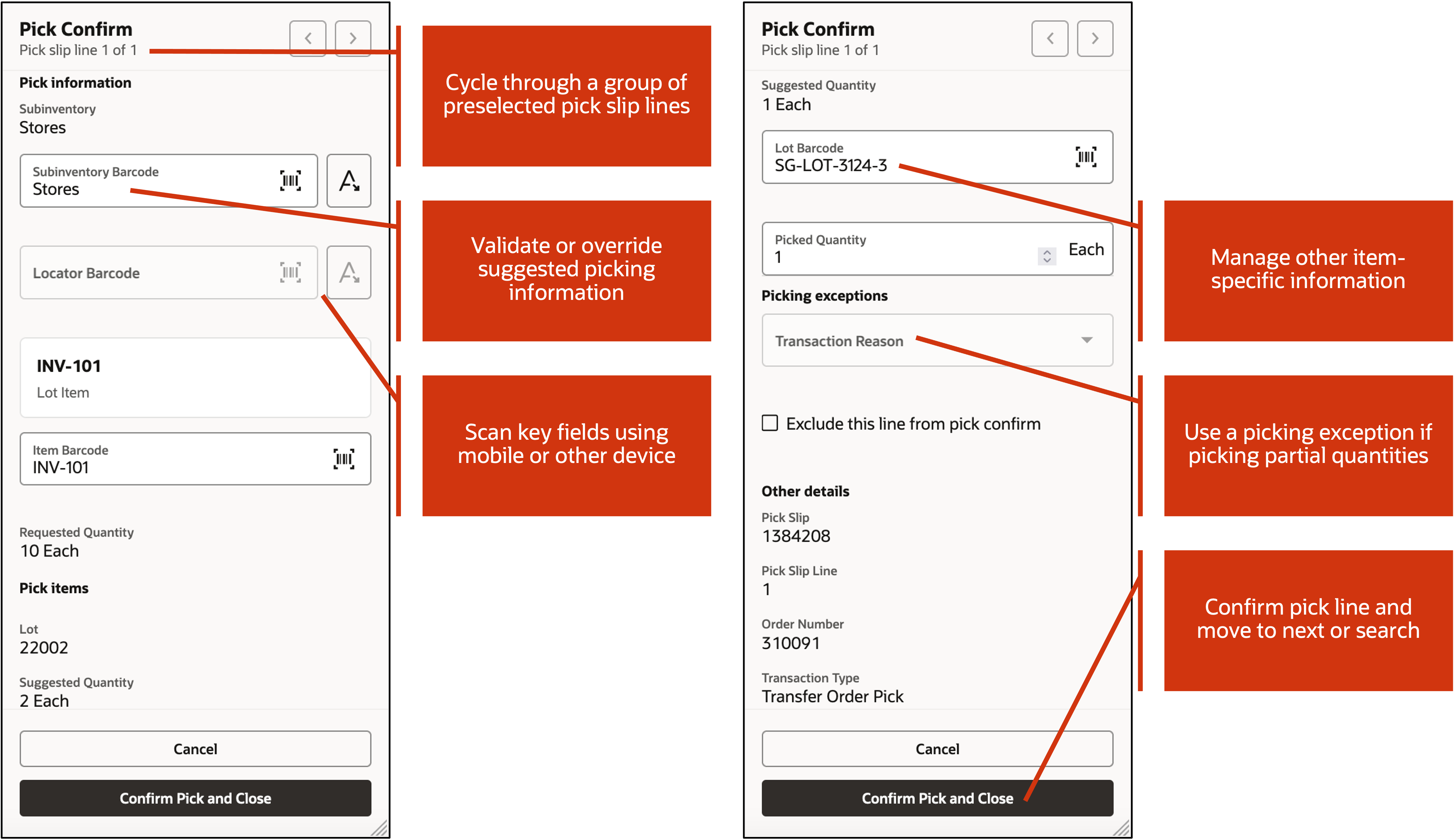

Confirming your open lines to pick is a critical step in the fulfillment process. Now you can confirm your open pick lines using a mobile device to scan subinventories, locators, items, lots, and serial numbers using either a camera-based or device-based scanner.
You start the process by searching for open pick lines by pick slip number or order number, and then validate picking information by scanning barcode identifiers or entering them manually.
You have the option to partially pick lines and either split, short pick, or backorder the remaining quantity. You also have the option to override suggested values such as lot and serial numbers.

This feature provides you the extra flexibility to confirm your open pick lines on the go using a mobile device.
