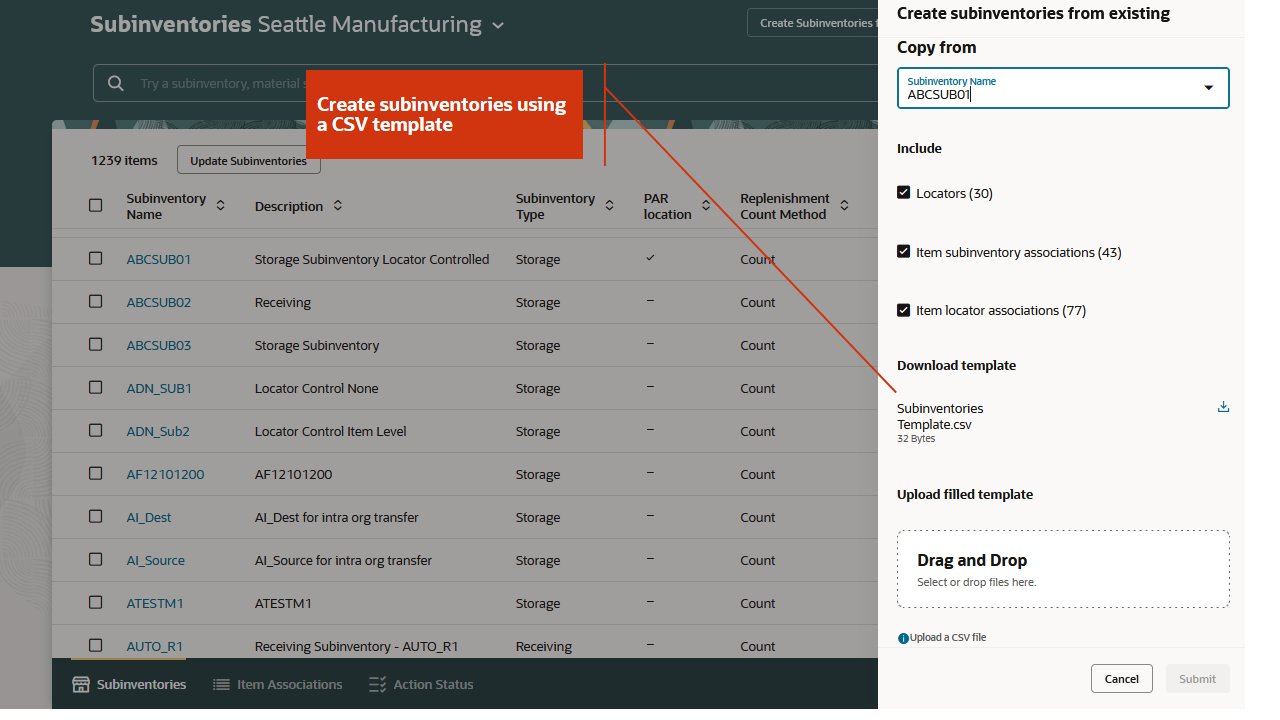

The Redwood pages delivered as part of the Manage Subinventories and Locators on Redesigned Pages 24A feature has been enhanced to enable users to create and update multiple subinventories, locators, and item subinventory and locator associations. The new enhancements are accessible using the Configure Subinventories task from both the Inventory Management work area and the Setup and Maintenance work area. In this release, subinventories and locators can be created by copying them from an existing subinventory and locator.

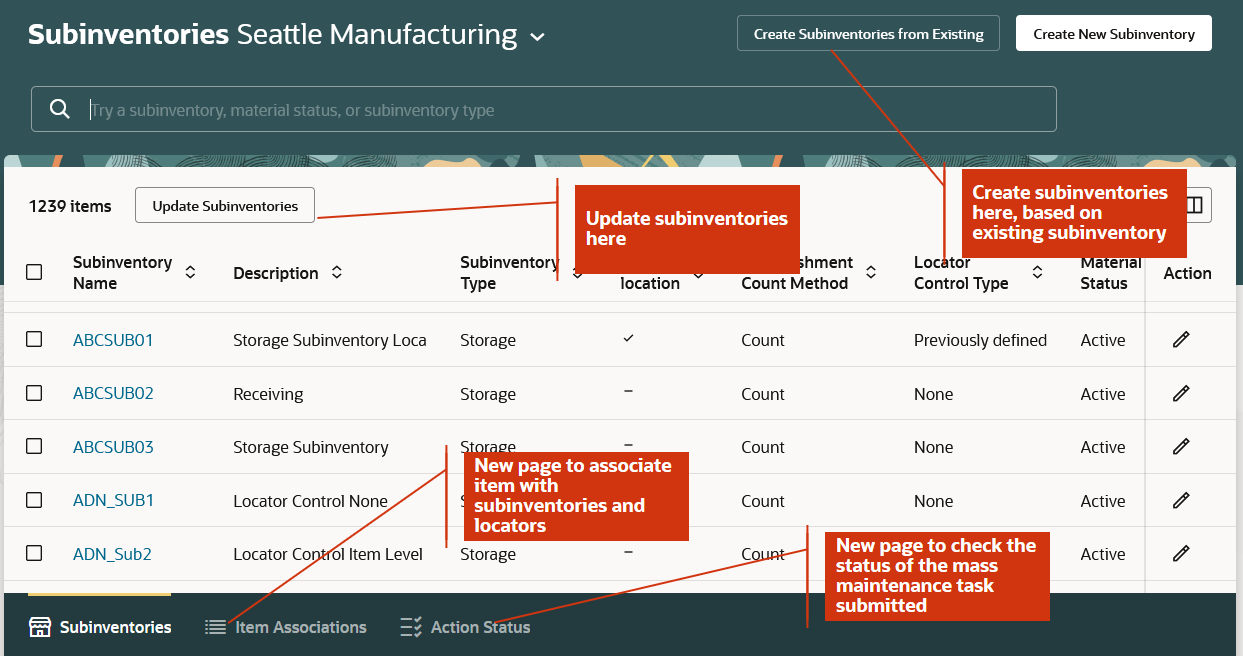

These pages are enhanced to enable you to create and update multiple subinventories, locators, and item associations with subinventories or locators by uploading .csv files in a drawer component:
  1. Subinventories
  2. Subinventory Details
  3. Locator Details
  4. Associate Item with Subinventory
  5. Associate Item with Locator
  6. Item Details
  7. Associate Locator with Item
Subinventories page
Subinventories Page
Create subinventories from existing
Create Subinventories from Existing

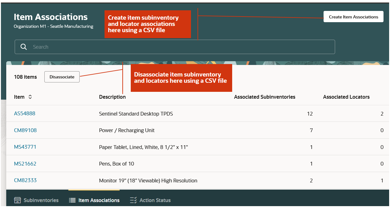

These new Redwood pages will help you in mass maintenance of subinventories and locators:
  1. Item Associations

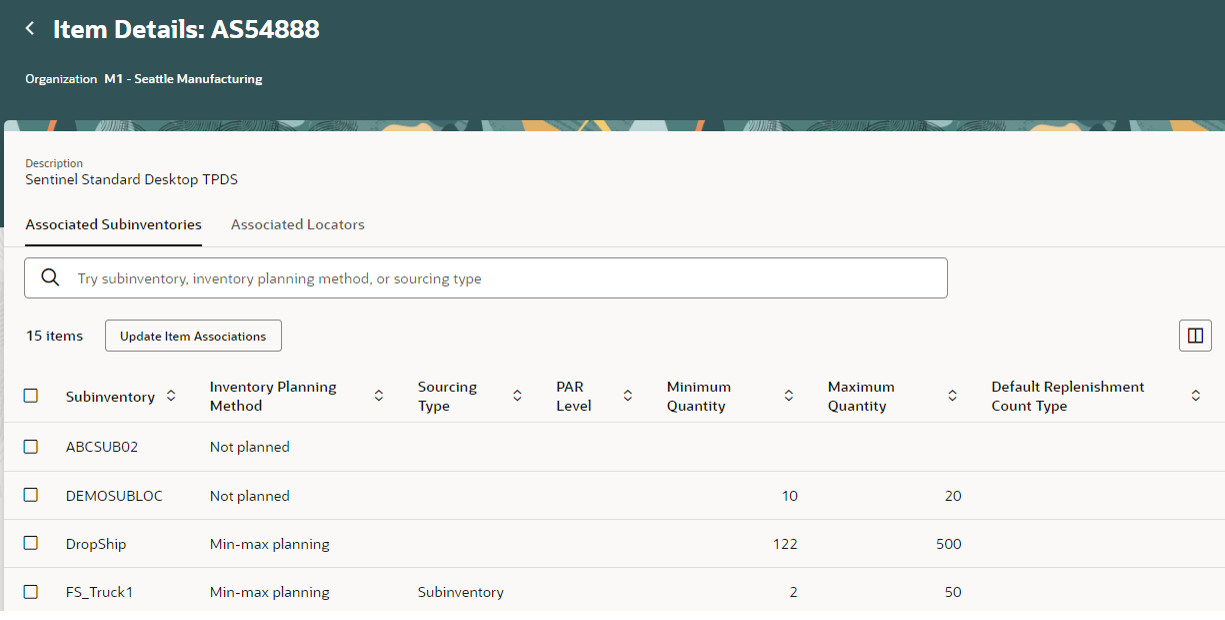

  2. Item Associations: Item Details

Item Associations page
Item Associations Page
Item Details page
Item Details Page

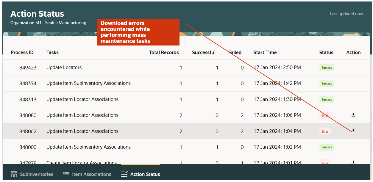

Action Status page
Action Status Page

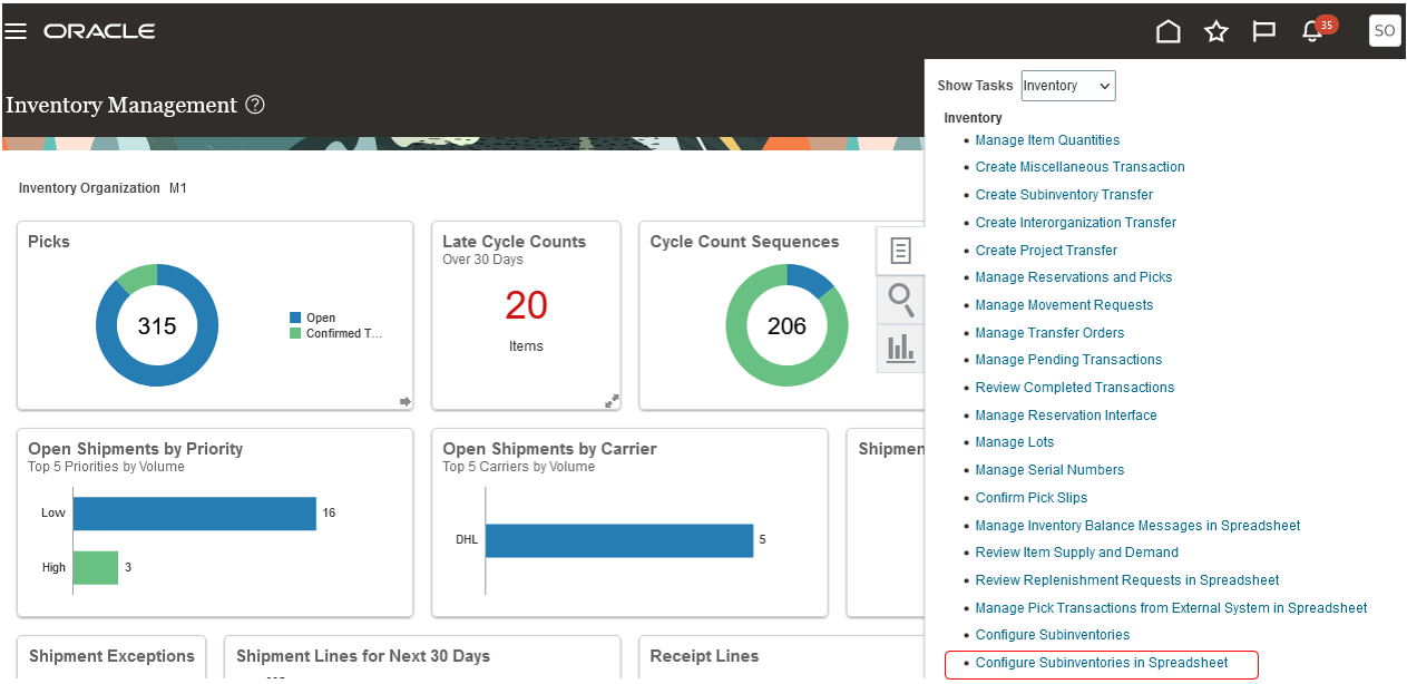

You may now also use the Configure Subinventories in Spreadsheet task, which will download a seeded spreadsheet template using the Oracle Visual Builder for Excel plugin, for creating and updating subinventories and locators. You may also create and update item associations and disassociate items with subinventories and locators.
Configure Subinventories in Spreadsheet Task

  • You may also use the Configure Subinventories in Spreadsheet task to access the integrated spreadsheet using the Oracle Visual Builder Add in for Excel for mass create and update functionality. You will need to provide credentials for the item subinventory associations and item locator associations worksheets separately.

  • You may check for any errors encountered while performing the mass maintenance tasks on the subinventories and locators by downloading the error file from the Action Status page.
