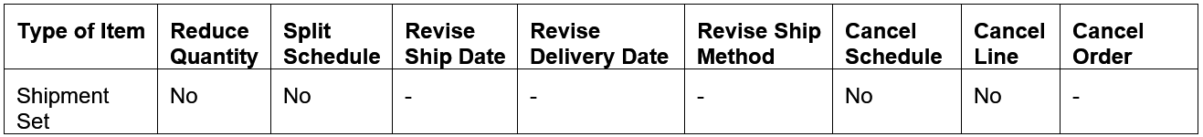

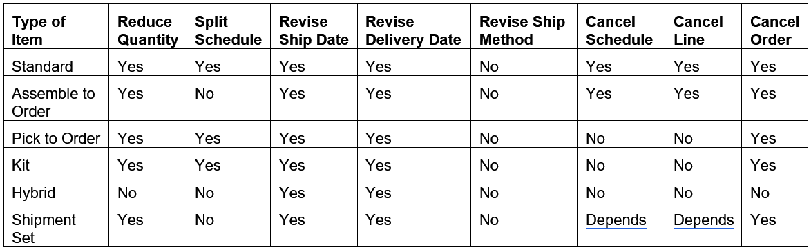

Here's a summary of what the buyer or supplier can do on a purchase order line when Procurement has received only part of the quantity.
Summary of Buyer and Supplier Changes Supported on Backordered Lines
NOTE:
Depends means Yes, but only for standard or assemble-to-order items.
If the item is a configured item, kit, or shipment set, and if you modify the date or shipment method, then you must apply the same date or shipment method across all the lines that are part of the configured item, kit, or set.
If Procurement hasn't received any of the quantity, then you can still make all of the same modifications that you can make when Procurement has received only part of the quantity, except for these differences with a shipment set.
If Procurement Hasn't Received Any of the Quantity, Then You Can Still Make All of the Same Modifications That You Can Make When Procurement Has Received Only Part of the Quantity Except for These Differences with a Shipment Set.
