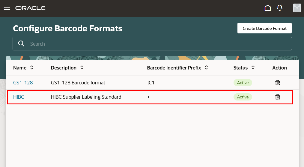

The Configure Barcode Formats setup task now includes a predefined configuration to support scanning HIBC barcodes encoded with the manufacturer part number, serial number, lot number, lot expiration date, and lot origination date.
Predefined HIBC Barcode Configuration

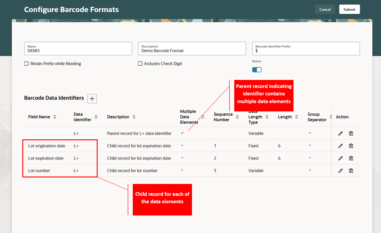

Additionally, this feature allows you to define and scan custom barcode formats with multiple data encoded within a data identifier. For example, you could define a configuration for a barcode format like $L+040124121224ABC123, with an expiration date and origination date encoded along with the lot number. In this example,
  • $ is the barcode identifier.
  • L+ is the lot number identifier.
  • 040124 is the lot origination date in the DDMMYY format.
  • 121224 is the lot expiration date in the DDMMYY format.
  • ABC123 is the lot number.
The Multiple Data Elements and Sequence Number fields are added to the Configure Barcode Formats setup task to support this. The Multiple Data Elements field indicates whether the data identifier contains multiple values. The Sequence Number field is used to indicate the sequence of the data. You start by entering a parent record for the data identifier, indicating that the data identifier contains multiple data elements. Then, you add a child record for each of the data elements encoded in the barcode using the data identifier.
Sample Barcode Configuration
