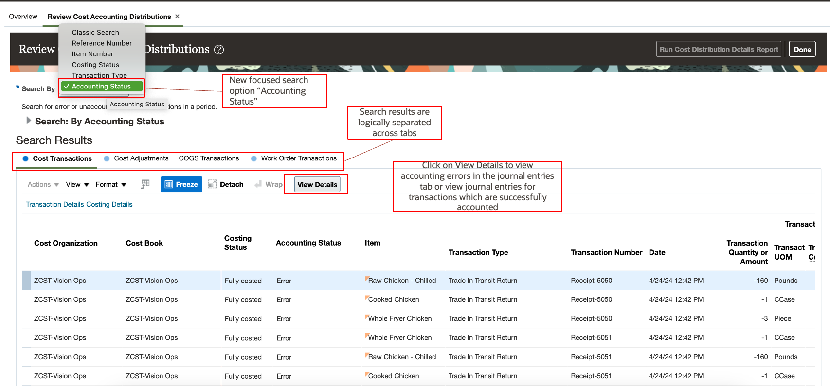

You can now search for transactions by the accounting status using the Search By option on the Review Cost Accounting Distributions page.
Focused Search by Accounting Status

  • When searching transactions by focussed search options, the search results are logically segregated across the following tabs for better usability and performance:
    • Cost Transactions: View inventory and inter-company physical and logical transactions.
    • Cost Adjustments: View manual or or automatic cost adjustments to receipt costs and inventory value.
    • COGS Transactions: View COGS recognition transactions.
    • Work Order Transactions: View resource, operation scrap, and work in process job close transactions.
