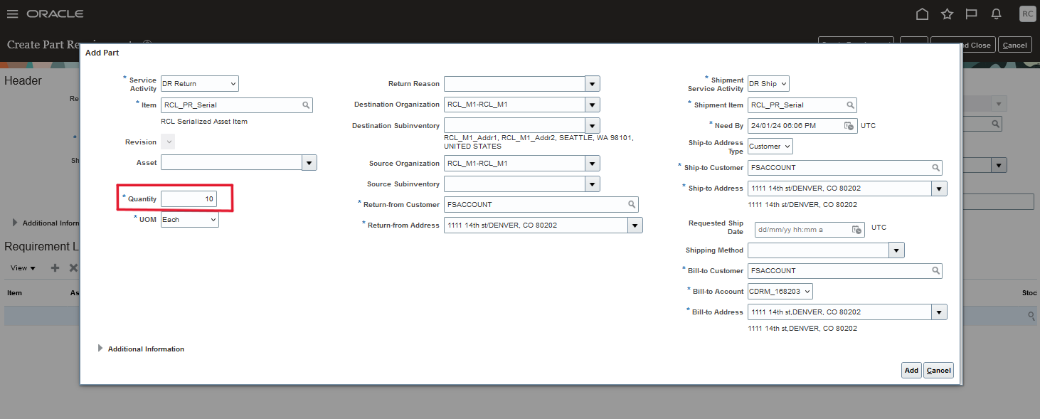

You can now create depot repair RMAs (sales order returns) with quantities more than one for serial tracked items. Previously, this was only supported for asset-tracked but not serial-tracked items. The serial numbers received for the RMA can be selected in the Create Repair Work Order UI and are displayed in the Depot Repair Workbench.
Add Part Requirement UI - Depot Repair Return and Shipment with Quantity = 10

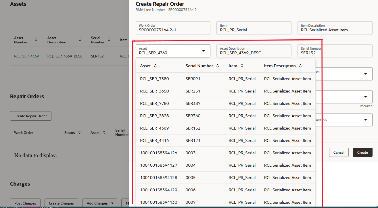

When creating repair work orders, you can select one of the received serial numbers. If no serial number has been received, you can select an asset located at the customer site.
Redwood Create Repair Order UI - Select Received Asset

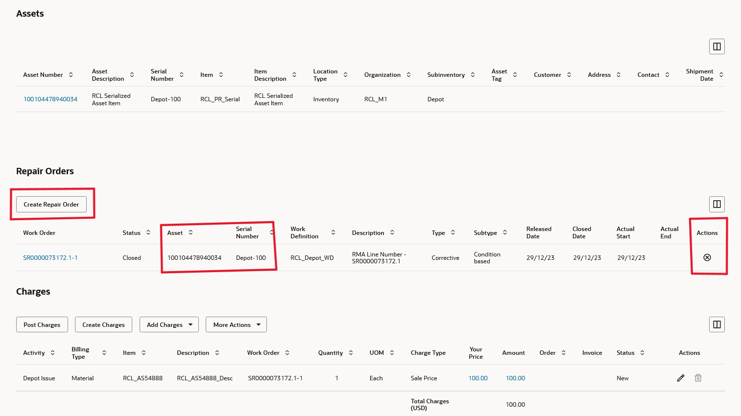

You can now cancel a repair work order in the Depot Repair UI. You may need to do this when the serial number received doesn't match the serial number used to create the work order prior to receipt.
Redwood Depot Repair UI - Cancel Work Order
