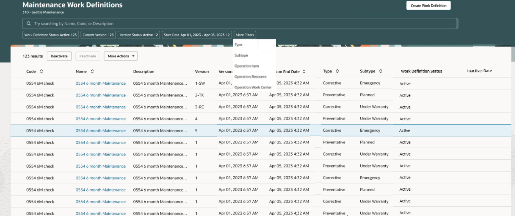

Use the Maintenance Work Definitions page to search and filter work definitions, review and manage work definitions, and create work definitions.
Access the Manage Maintenance Work Definitions page from the Maintenance Management landing page task menu under the Asset and Work Definition section. The landing page shows a list of active and current versions of work definitions sorted alphabetically. Use the search bar to refine your search by work definition name, code, description, start date range, work order type, and work order subtype.
In this screenshot, you can see the new Redwood Maintenance Work Definitions page with search filters such as work definition status, version status, and start date.
Maintenance Work Definitions Page
The Maintenance Work Definitions Page

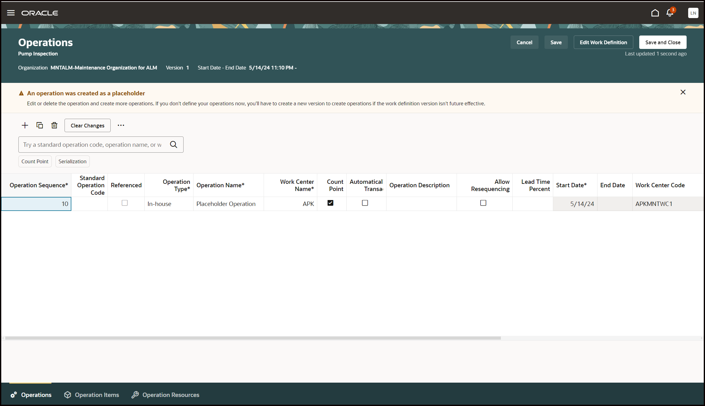

Click the Create Work Definition button from the Maintenance Work Definition page and enter the work definition header information. After you save this information, you see a new page with three separate tabs for Operations, Operation Items, and Operation Resources. Each of these is presented in a table format for easy updating and viewing. The Operations tab opens first, showing a table to create the work definition operations. During the creation of a new work definition, an operation placeholder is added. You can overwrite or delete it as you add operations on the page. To add more operations, use the plus icon. Click the Operation Item tab to add items to the operation and do the same for the Operation Resources tab to add resources and alternative resources. This completes the creation of a maintenance work definition.
In this screenshot, you see the Operations page with a default operation placeholder added. The Operation Items and Operation Resources tabs are at the bottom of the page to facilitate easy navigation.
Work Definition Operations Tab with Operation 10 Placeholder
